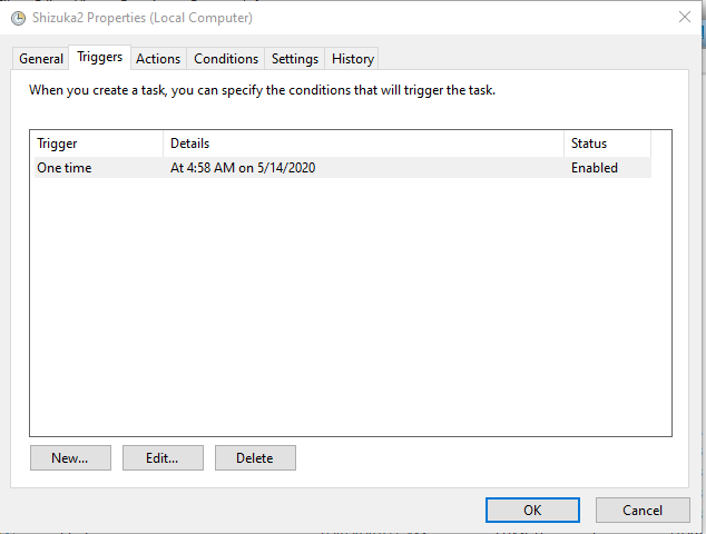

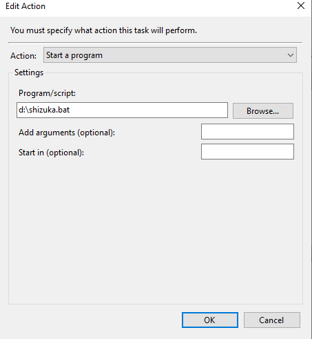

    I've also figured out how to use Windows Task Scheduler to execute the batch automatically. Beware that the different versions of Windows may have different setup requirements especially if you're the Admin or only User. After lots of trial and error, I found that the simplest method works for me on Win 10 X64. I have it set as One Time Only because the URL changes every day.
    [Attachment 53308 - Click to enlarge]
    [Attachment 53307 - Click to enlarge]

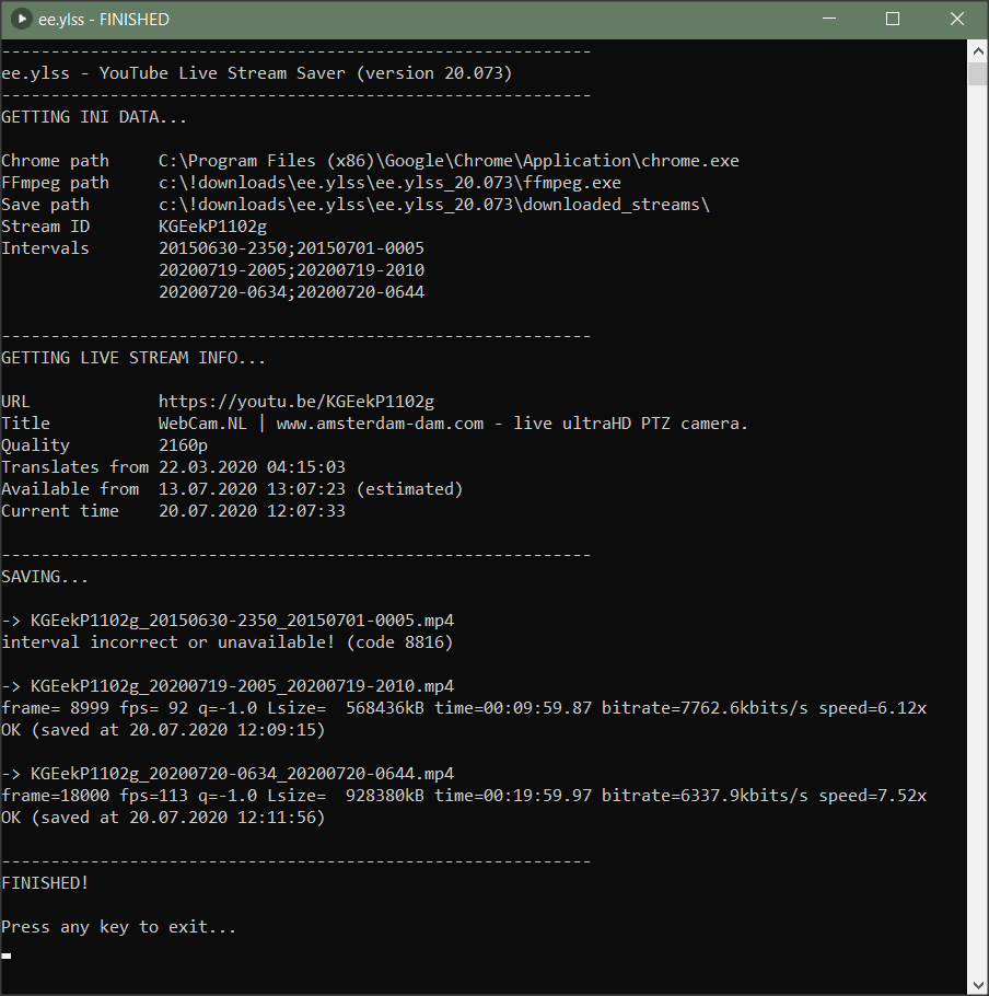

    Try ee.ylss utility
    You can find it on https://github.com
    I haven't tested much, but at the moment it can download needed time interval of any Youtube livestream

  24. Member
    Join Date: Jul 2020
    Location: Europe
    Other version ready, with command line support and with choice of resolution - page on GitHub
    It also can download the specified past portion of YouTube livestream, even if it was streamed many hours ago
