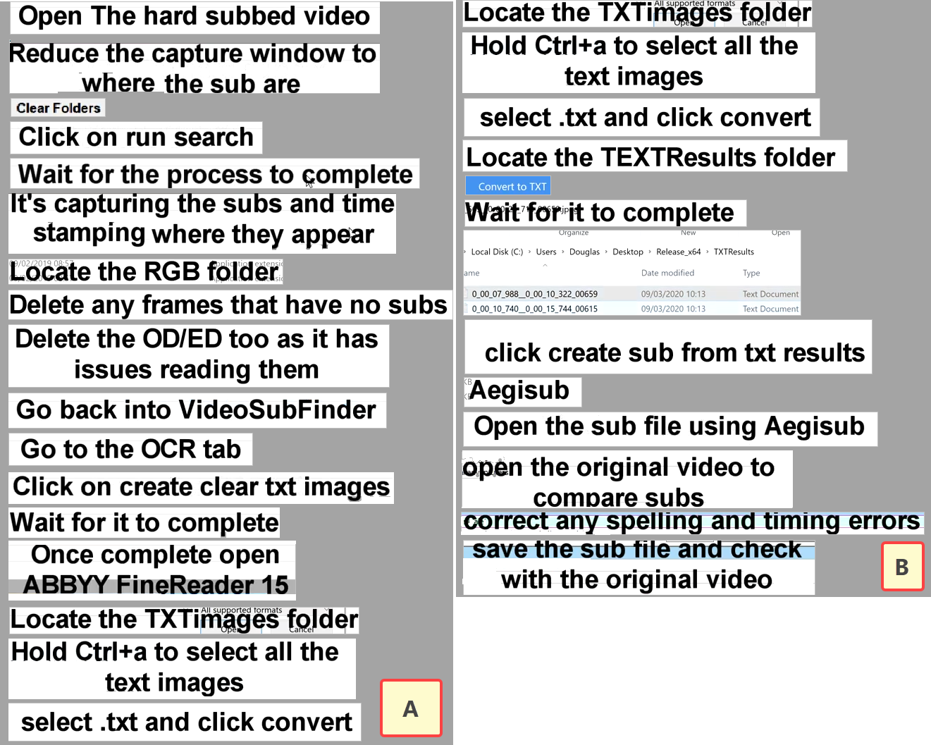

 When I started with videosubfinder, for my own use, I made screenshots of each step, as a kind of manual.
 Videosubfinder is a fine program, really. However, converting to txt files using Abbyy FineReader may be a problem. It is a good but.. expensive product (eur.199 / usd.235 plus taxes)
 [Attachment 58243 - Click to enlarge]
 01) Open The hard subbed video
 02) Reduce the capture window to where the sub are
 03) Clear Folders
 04) Click on run search
 05) Wait for the process to complete
 06) It's capturing the subs and time stamping where they appear
 07) Locate the RGB folder
 08) Delete any frames that have no subs
 09) Delete the OD/ED too as it has issues reading them
 10) Go back into VideoSubFinder
 11) Go to the OCR tab
 12) Click on create clear txt images
 13) Wait for it to completed
 14) Once complete open ABBYY Finereader 15
 15) Locate the TXTimgaes folder
 16) Hold Ctrl+A to select all the text images
 17) Select .txt and click convert
 18) Locate the TXTimage folder
 19) Hold Ctrl+a to select all the text images
 20) Select .txt and click convert
 21) Locate the TEXTResults folder
 22) Convert to TXT
 23) Wait for it to complete
 24) Click create sub from txt results
 25) Aegisub
 26) Open the sub file using Aegisub
 27) Open the original video to compare subs
 28) Correct any spelling and timing errors
 29) Save the sub file and check with the original video
