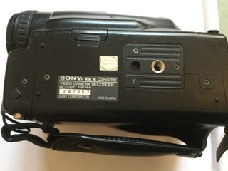

That model number (TR705E) also doesn't seem to exist. Try looking it up here:
https://www.sony.com/electronics/support/cameras-camcorders
I try not to berate anyone who asks for help, but in this case, I think you are providing information that is simply wrong and you are sending us all on a wild goose chase. -
More importantly, how can you play a MiniDV tape in a Hi8 camcorder???
That is not possible.
Good I’m glad about that, as I did not say I played MiniDV on a Hi8 or vice-versa, rather I tried another video camera to check that it played in colour on my TV. It did, but as you probably understand better than I it means not a lot as the two systems/cameras are very different. Furthermore the model number is definitely Sony CCD-TR705E. Hope this image uploads.

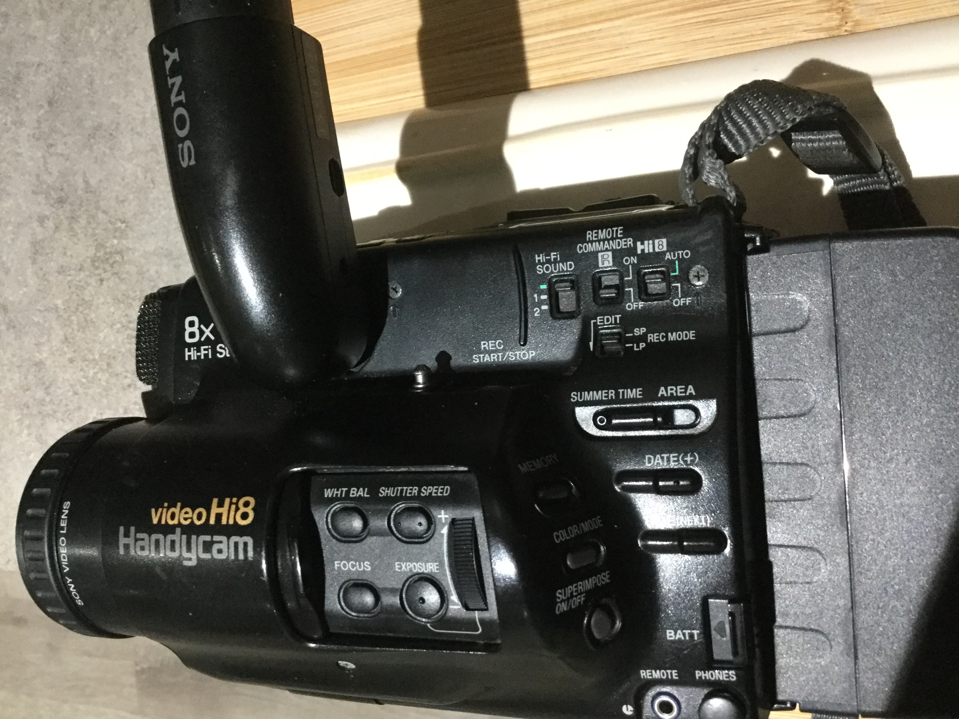

It appears to be a frame rate issue, Have you gone through the camcorder settings and made sure the output is set to PAL and not some other conversion standard?
Now that would be embarrassing! It’s 25 years since I used this camera! There does not appear to be a settings menu as such, just time and area. I’ve reset it to London and will try that. There doesn’t seem to be any specific way of choosing the TV system.
[Attachment 53173 - Click to enlarge] -
But surely the only other 'Playback standard' is NTSC.
There would still have to be a setting on the camera for playback on PAL equipment just like with VCRs else the display, ignoring the rolling, would be IIRC in B&W.
