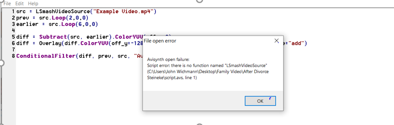

    I'm probably doing something very minor wrong, but when I try to upload the script I'm getting the following error (see attached). I believe I have everything downloaded correctly, and LSMASHSource.dll was put into AviSynths plugin folder. I used the "Example Video" to test as I'm assuming you change that text depending on the videos actual name (once I have it all figured out).
  14. Maybe you put the wrong (32 bit vs 64 bit) LSMASHSource.dll file in AviSynth's plugins folder? If you're using AviSynth+ be sure to put the 32 bit version in the plugins+ folder, the 64 bit version in the plugins64+ folder.
  15. Originally Posted by jagabo View Post
    That's what it was. Everything seems to be working well now. Currently dubing. Going to see how it turns out and then try the other script. Anything special I need to do with the more complicated script?

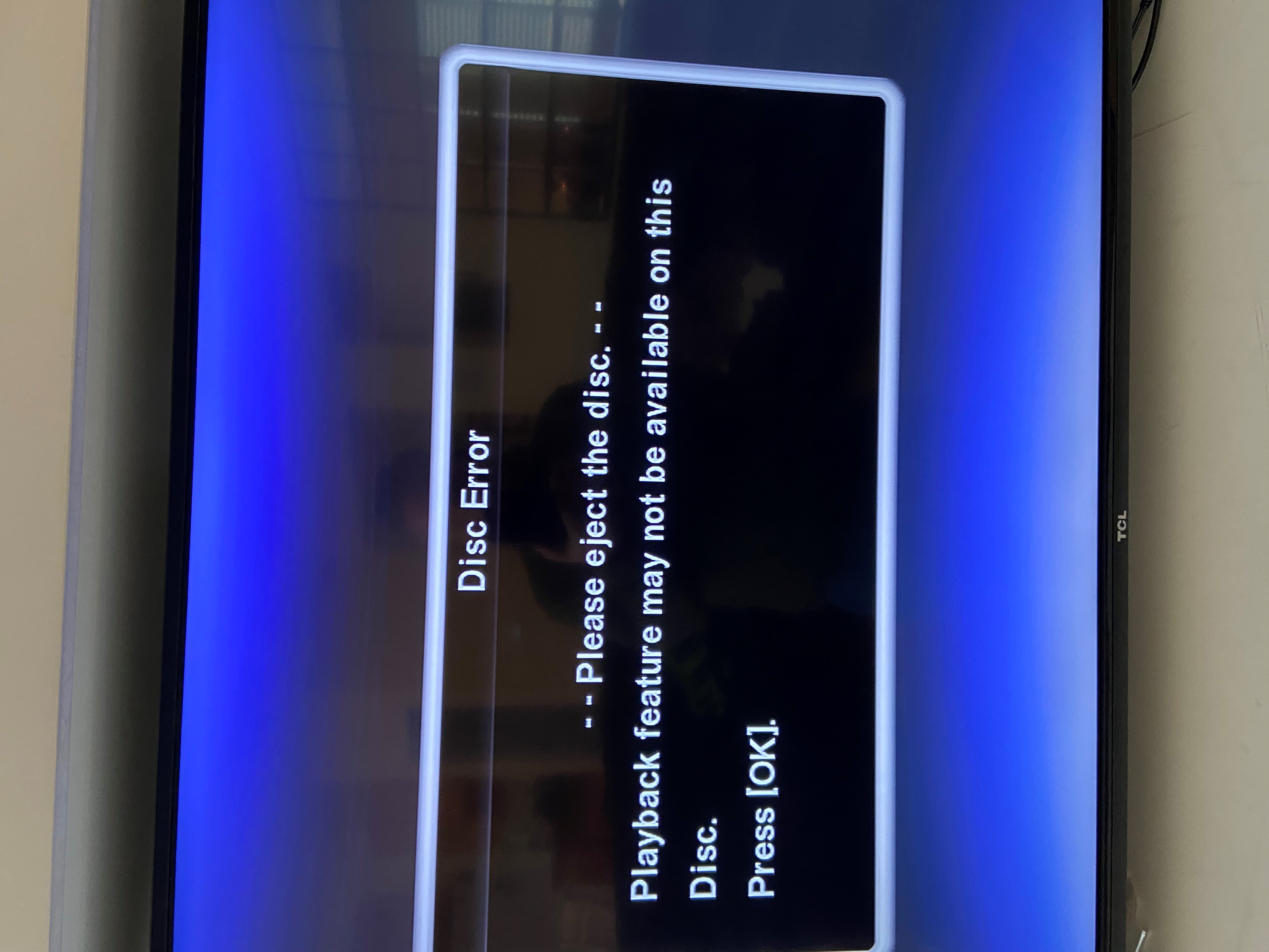

  26. I'm unable to play back burned dvd's after transferring minidv tape to IMAC using Clear Click Video 2.0 The DVD's will playback on the IMAC, just not on my dvd player. I get a warning that states please eject the disc, playback feature may not be available on this dvd.
Name:	dvd screen.jpg
  27. Originally Posted by bryanhubbard@comcast.net View Post
    Did you make a movie DVD? If you examine the contents of the DVD do you see a VIDEO_TS folder with IFO, BUP, and VOB files in it?
    Or did you just burn a data DVD with a few computer MP4 files?
  28. I'm not sure. Attached is DVD info. I don't see ts_video file with info bup files in it. I just burned the dvd. info shows MPEG-4 movie.
  29. Capturing Memories dellsam34's Avatar
    Jan 2016
    DVD is mpeg-2 not mpeg-4.
