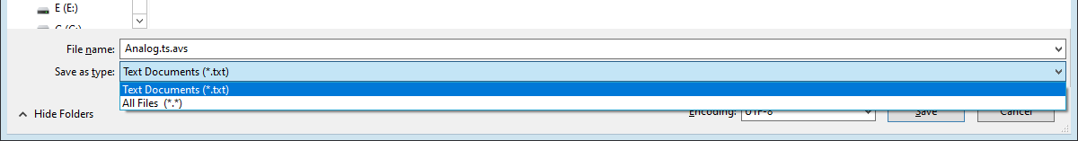

  1. AVS won't show up as an option. Just add .AVS to the filename before saving. But it needs to be saved as a text document, not an RTF document. I only have "Text Document (.txt)" in that pulldown, whereas you only have .TS:
    [Attachment 53185 - Click to enlarge]
    Is that not the built in Notepad in Windows 10? The title bar is different on my Win10 computer. Before saving it shows "*Untitled - Notepad".

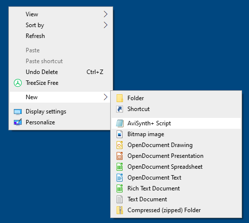

    Are you using AviSynth or AviSynth+? The latter has a shell extension that adds "AviSynth+ Script" to Explorer's menu's New option:
    [Attachment 53187 - Click to enlarge]
    That's on the Desktop but it works in an Explorer window too.

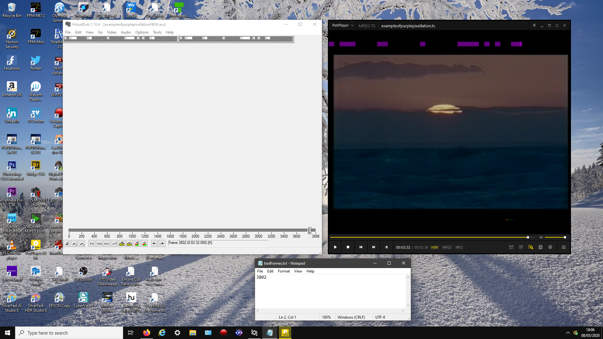

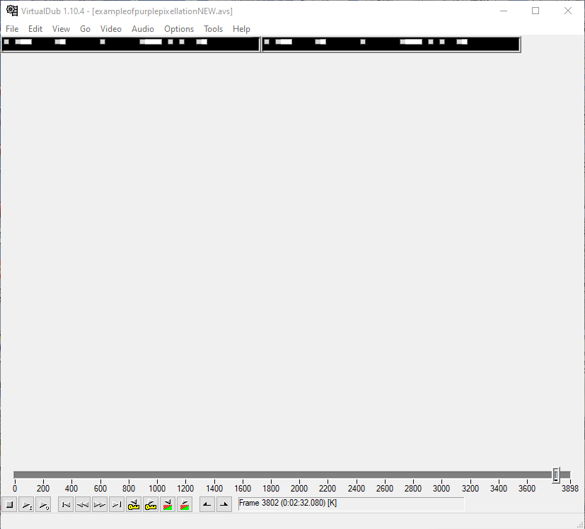

    Works great, thank you so much. Here's a comparison of the result in Virtualdub, and the frame as displayed in a media player.
    Is there a way to alter the top grey boxes in Virtualdub to black, so that when the blocks appear, the blocks look white and the surrounding areas are black, so they stand out even more?
    Also, do you know if the purple blocks need to be as prominent and stark as the example here for this method to be able to detect them? The reason I ask is that I have in the past spotted an instance when there was a single purple block at the top of the picture, but it was not anywhere near as bright as in this example. Would significantly dimmer purple blocks not get detected?

  12. Originally Posted by DPage View Post
    Perfect black borders would have U values of 128. But noise in the video will cause them to vary from that a bit. In the source video you provided the purple blocks had U values from a little below 200 to 255. The "180" in the script I gave set the threshold at 180. Here's a modification where you can set the threshold value and the filename at the top of the script.

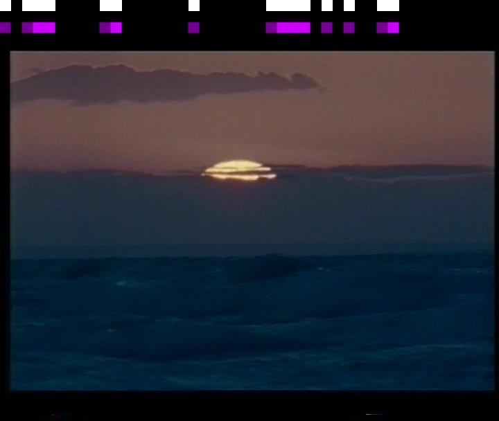

    It occurred to me that it would be useful to see the actual video along with the bad blocks. So I stacked the bad blocks over the original video. I also adjusted the blocks so the values below the threshold are black, anything over the threshold is white.
    global filename = "Analog.ts"
    global threshold = 140
    LWLibavVideoSource(filename)
    src = last
    Crop(0,0,-0,32) # examine only the top 32 scan lines
    UtoY() # look only at the U channel (of YUV), V channel has the same problem
    WriteFileIf(last, "badframes.txt", "(YPlaneMax(last) > threshold)", "current_frame", append = false)
    # adjust the brightness of the blocks and stack them over the original image
    ColorYUV(off_y=-threshold).ColorYUV(gain_y=60000)
    PointResize(width*2, height*2)
    StackVertical(last, src)
    So change the filename and set the threshold you want at the top of the script. Then open the script in VirtualDub and run the video analysis pass. Open the badframes.txt file to see the list of bad frames. Back in virtualDub scrub to the frame(s) in question and check them visually. Of course, all this extra processing slows the script down. What used to take about 1 second now takes about 3 seconds.
    The threshold of 140 above gave one false positive at frame 1010, along with the true positive at 3802. Raising the threshold to 141 eliminated that false positive. So you'll probably want to set the threshold to something a little higher than 140.
    True positive:

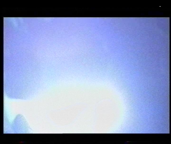

    [Attachment 53194 - Click to enlarge]
    False positive:
    [Attachment 53196 - Click to enlarge]
