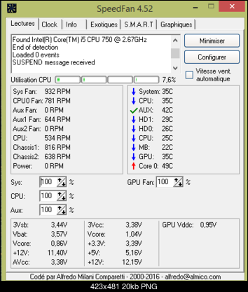

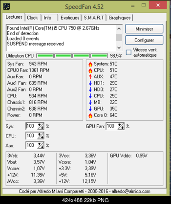

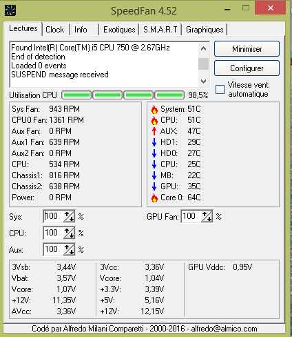

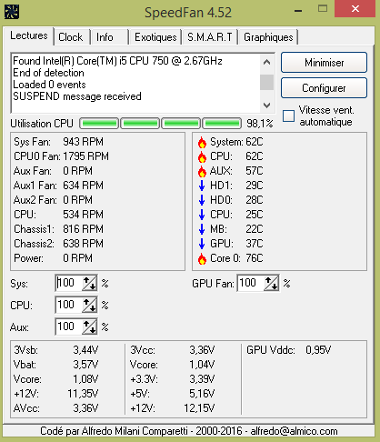

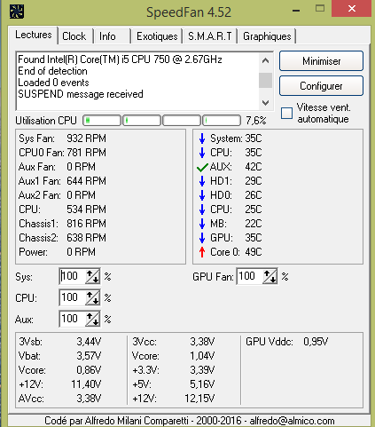

  5. Sorry, my fault.
    Made some more checks
    Room temperature today around 21°C/70°F
    CPU temperature after 7min (stop benchmark then) 62°C/143.6°F
    Core 76°C/168.8°F
ID:	53112Click image for larger version
ID:	53113Click image for larger version
  6. 62 C is getting close to the max for that CPU, ~72 C. Does the temperature continue to rise if you keep encoding?
  7. 62 C is getting close to the max for that CPU, ~72 C. Does the temperature continue to rise if you keep encoding?
    It seemed to reach a peak around 10min mark, back and forth from 68°c to 67°c. Conversion over. I got other files to convert a little bit longer, ~20min.

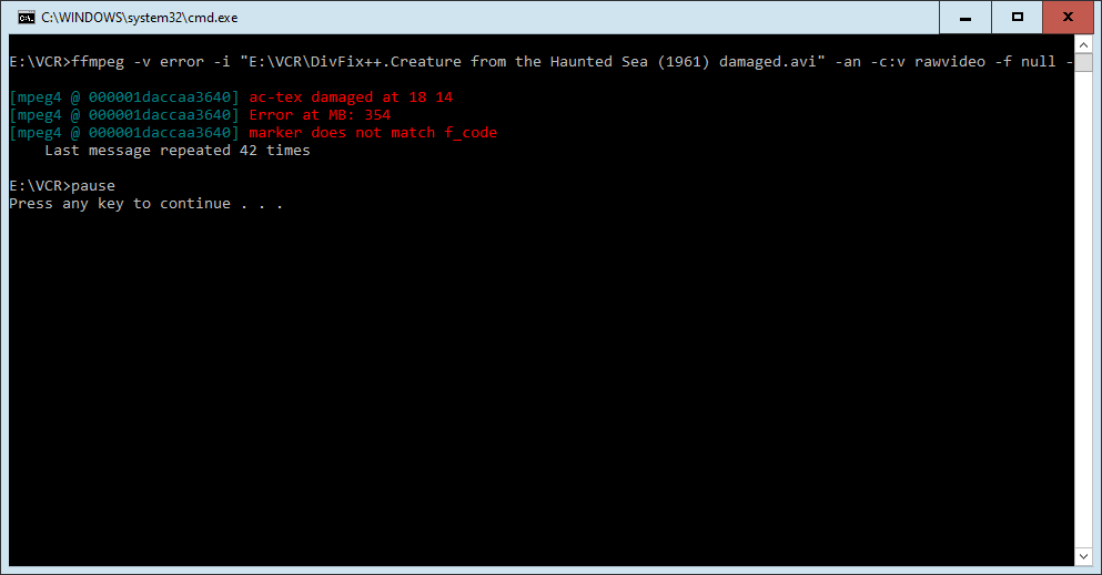

  10. ffmpeg can detect some errors. Put this in a batch file:
    ffmpeg -v error -i %1 -an -c:v rawvideo -f null -
    pause
    Then you can drag/drop videos onto it to build an error report. If ffmpeg detects any errors you will see them in the CLI window.
    [Attachment 53125 - Click to enlarge]
    No detected errors doesn't guaranty the file is perfect, just that ffmpeg didn't report any errors.
