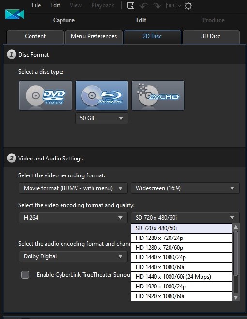

    I wish there was a disc preferences option. Well technically there is but its very basic (see photo) and no way to set bitrates nor a 720X480/24p option. That link you provided must be for a newer or older version than mine. This pic im attaching shows the limited options I have with creating a disc. I have asked a few people if newer versions allow more preferences but no response yet. Thank you so much for trying to help. Maybe someone else on here will know of something.

  11. Member Cornucopia's Avatar
    3 things:
    1. Have you tried using the "SmartFit" preset option?
    2. Have you tried going to the app folder to see if those dropdown "presets" reside in some text file that is editable (aka you create your own presets, manually).
    3. I see in your screencap that you have selected h264 as the codec. Unless I am mistaken, I do not believe that is allowable for SD material - only MPEG2 is supported. Perhaps that is your issue?

  13. Originally Posted by Cornucopia View Post
    Scott, I tried the smartfit option. For h264 it wasnt quite smart, as although it lowered file size overall, it still remained over 50GB for BD. It was ALMOST smart enough for mp2 by lowering it to 49.5GB (hence mp2 is better for SD on a BD like you thought). BUT, technically a 50GB BD really only has 46GB of record-able space so I need to get it 4GB lower(?).
    When I changed the disc type from 50GB to 25GB, then smart fit, the file lowered to 47GB. SO, I wonder if even though disc type is set to 25GB, but I have a 50GB disc in the burner, that it will continue burning data beyond that 25GB preset mark? If so, I dont want to delete a couple videos from the project to get it below 46GB but can as a last resort.
