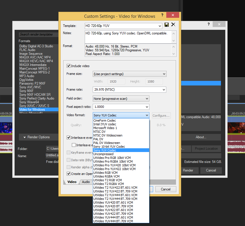

first i'd say never use wmv. it was crap back then, and now it's .... take your project from the source file and render out to a lossless avi (huffyuv, lagarith, utcodec, sonyuv). file/render as/video for windows/pick anything you have installed, then change the settings to what you want. the file will be huge so use an appropriately sized hard drive. then if studio doesn't like it too bad, use something like vidcoder to convert it to mp4.
[Attachment 53025 - Click to enlarge]--
