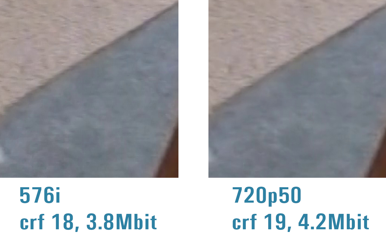

    I question the claim that interlaced encoding is less efficient. I can't find any backup for it. To me it seems, x264 actually has more possibilities/strategies to encode. Only downside is that weightp is not implemented.
    edit: perhaps progressive coding is more efficient when comparing at the same framerate, but not when comparing 25 interlaced frames per second (50 fields per second) to 50 progressive frames per second. I'd say the latter is a fairer comparison, as I value the fluidity of having 50 frames/fields per second.
    And while it's an increase, 720p isn't a massive leap up from 576i. I assume it's all 4:3, so before adding borders it'd be 960x720 instead of 720x576, and the borders take almost no bitrate to encode. I haven't seen your source so I'm just pontificating theory, but if you upload a sample I could deinterlace, denoise, upscale and encode it for you to give you an idea of what the btirate will be for a given CRF value so you can compare it to what you're doing at the moment. It's up to you, and of course if you're not an Avisynth user, you'll need to become one.
    Even when ignoring the black bars, the number of luma samples triples when moving from 576i @ 50 fields per second to 960*720 @ 50 frames per second. So yes, it is a massive leap in my eyes. The material is from Video8 and VHS, so it's inherent resolution is more like 320x288 per field (assuming 250 TVL/PH). So, actually, I'm oversampling by a factor 7 with respect to the original material.
    As I am not an experienced Avisynth user, so I did some tests with ffmpeg's yadif, which I am familiar with, just to test what bitrates do when deinterlacing and upscaling. A result is attached. I'm not impressed. It seems to me keeping it at 576i has a higher quality/bitrate tradeoff than converting to 720p as you suggested. I had to change crf from 18 to 19 to keep the bitrate in the same range. While it is hard to compare material at such crfs with lack of any detail in the source material, I still see differences, most notable a bit of blurring of details.
    So, I'm not convinced deinterlacing+upsampling is better, on the contrary.

  9. Originally Posted by ktmf View Post
    I was simply quoting the Wiki. I never encode as interlaced.
    As a general rule, you can use higher CRF values for higher resolutions without it seeming to reduce the quality, assuming in the end it'll all be viewed on a 1080p display. Think of the Xvid AVIs you've no doubt seen that look okay on a small screen or CRT, but upscaled to 1080p they look horrid because the encoder artefacts are upscaled too. I often encode 1080p at CRF20, but I almost never use it for SD.
    Have a look at the screenshots here. That thread is a whole other argument, but they're 1080p's worth of a 4k frame, and each was taken from a frame with a fair bit of movement, but the x264 screenshots were encoded at CRF 24. With a clean UHD source it looks pretty good.
    The extra blurriness in your 720p encode could be the result of soft(ish) upscaling. What upscaling method (resizer) did you use? How much did you enlarge those screenshots? Enough that you couldn't duplicate it under normal viewing conditions without a magnifying glass and your nose touching the screen?
    How do you know the 567i encode is how it should look, and what appears to be detail isn't de-interlacing artefacts? Have you compared them to a de-interlaced version of the source using the same de-interlacing method to see which one is most similar?
    Anyway, just to see if I might be talking complete crap, I used the source I uploaded previously, cropped it as before (688 x 572) and anamorphically encoded as interlaced. With the same encoder settings as before (aside from enabling interlaced encoding), the output was 6569 kb/s.
    I de-interlaced with QTGMC's default settings (no extra denoising), and even though it should display at close to 16:9, I squished it to 960x720 and added borders to the sides. The resulting bitrate at CRF18 was 7251 kb/s. I ran a second encode at CRF19 and the bitrate was 6267 kb/s.
    De-interlacing to 50fps with Yadif and encoding at CRF19, the bitrate was 10.4 Mb/s.
    So my theory does hold up, and it was just a theory, given you don't want to share a sample of your source, but as long as you clean up a low quality video before upscaling, and Yadif de-interlacing on it's own apparently doesn't fall into that category for my tests, it's possible to upscale without having to increase the bitrate, or without increasing it much. Obviously it'll be quite source dependant though.
    For the 720p screenshots below, I de-interlaced while cropping the source to 4:3 instead of squishing it. At CRF19 the QTGMC encode came in at 6280 kb/s, while for Yadif it was 10.2 Mb/s, so it didn't change the bitrate too much. I can upload the encodes if you want, but here's screenshots from each, upscaled to 1080p by MPC-HC.
