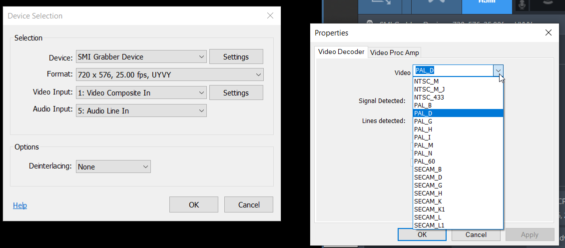

    I am trying to digitalize the old 8mm tapes. Equipment I am using:
    Sony HandyCam CCD-TR411E PAL --> RCA Cables --> EasyCAP --> USB
    I managed to capture the input video and sound, but I cannot find the proper setup for the proper video quality.
    Since I am living in Central Europe, Hungary, I would assume I need to pick some of the PAL settings from the dropdown.
    [Attachment 52979 - Click to enlarge]
    I have chosen PAL_D first, the image and the colors are fine, but sometimes (not always) the top of the image is blinking/flickering. Video: https://www.youtube.com/watch?v=wjddNFGks-A
    I have tried PAL_N, there everything is fine, except the colors are lost. Video: https://www.youtube.com/watch?v=BvY2wtKckwo
    I know that EasyCAP is not providing the best quality, but I would assume that with the right settings you can have something that has colours and not blinking.
    Can someone elighten me about what is wrong with this, and what should be the correct settings?
    Thanks in advance!

    Pal D would be correct unless the camera had recorded in a Secam variant also common for Eastern Europe. Then you would use Secam-D instead.
    But assuming the correct recorded source your issue really is the easycap or easycrap as it is usually referred to around here.

    Have you also tried PAL-I or PAL-B/G ?
    I use a Haupauge USB Live-2. Their own capture software just has 'PAL' but you can use it with virtualdub to select a PAL variant.

    Yes, I have tried all of the PAL settings. I have just ordered a new, more expensive device, hoping that it was just because EasyC(r)ap. Will give here an update in a couple of weeks after I try the new stuff. Thanks for the help!

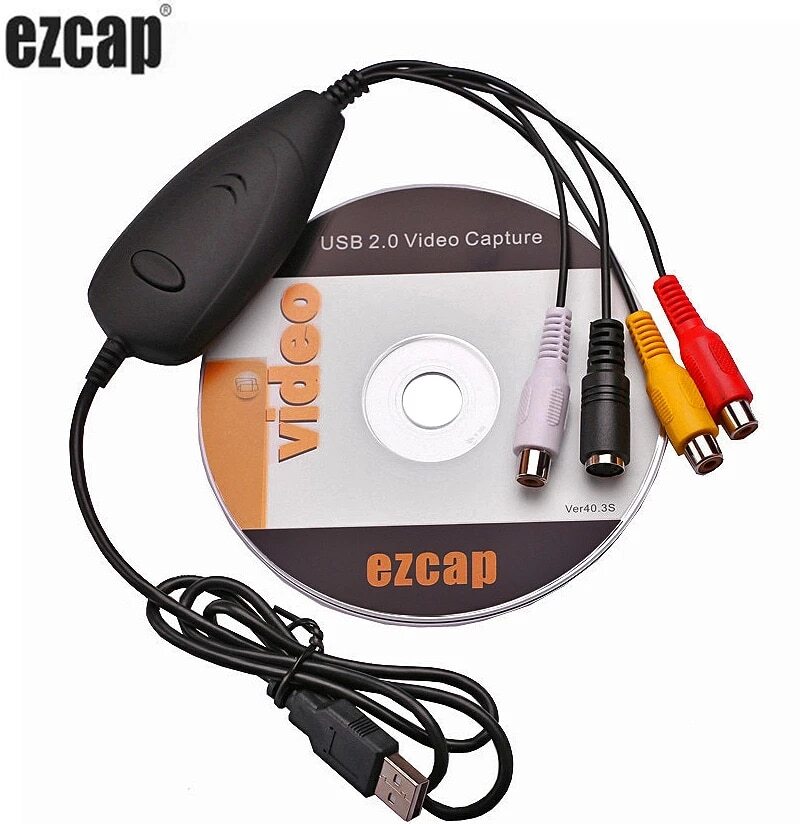

    The latter one I have is this from Aliexpress
    This appears as 'ezcap Video Grabber' in the Device Manager and is version 1.0.1.1 from 2013-07-07.

    Thank you very much ther89. I have a similar easycap device and I think that is a complete garbage, so to anyone who wants to buy a low cost device, please stay away of that models. And of course if you can spend a little more, buy a decent capture (like a hauppauge 610 usb-live 2)
