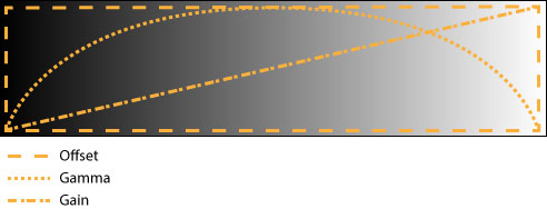

    Researching gain, gamma, offset, etc., I found this at https://www.provideocoalition.com/whats-in-a-name/:
    [Attachment 53117 - Click to enlarge]
    I'm not finding any detail specific to Avisynth, but based on this, gain is applied (increasing linearly) from 0 at Y=0 to 100% of the multiplier (3 in your code) at Y=255. Is that correct for Avisynth?
    Edit: I posted this before I saw your last post... Thanks again!

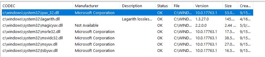

  14. I don't have a VFW decoder for v410. I would use:
    LWLibavVideoSource("1986_1011 Meema Pool V410 unc samp.avi", format="YUY2")
    You'll need the LSMASH package for AviSynth. That reduces the video to 8 bit though.

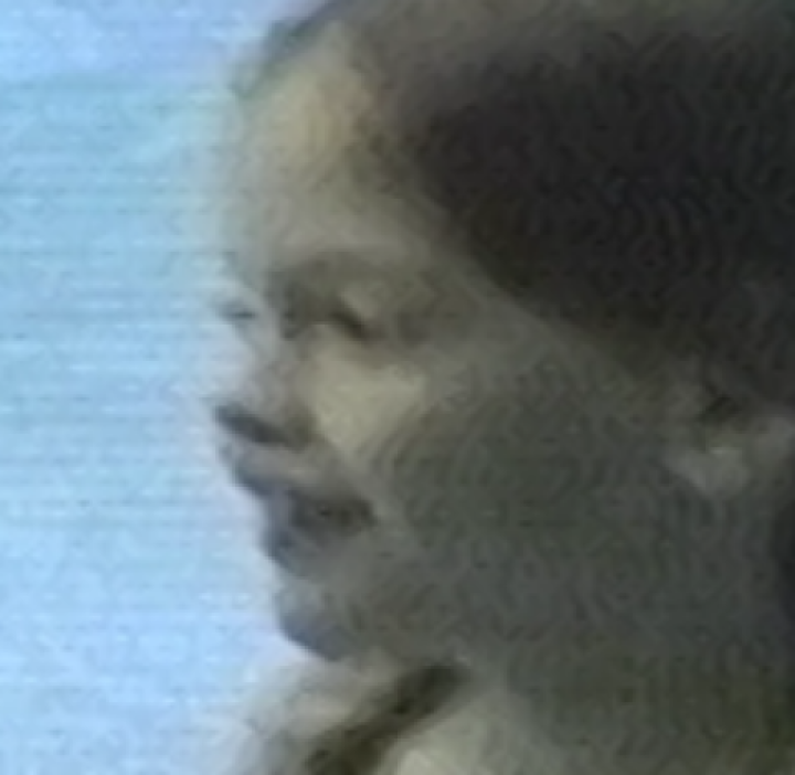

  15. Intermittent Fields in the original have lizard skin:
    [Attachment 53123 - Click to enlarge]
    Is that just a limitation of the original format?
    Edit: Actually, I should go back and verify if these captures were done with the camera (player) DNR on or off...

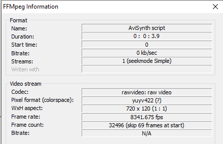

  17. Something has blown up for me, so I want back to simplicity and tried running this:
    DirectShowSource("1986_1011 Pool Sample DV.avi")
    SeparateFields()
     AssumeFrameBased().SeparateFields()
    This also generated errors so I tried one SeparateFields on a video with 117 frames. This produced 234 fields as expected.
    When I run the code above, it produces 32,496 "images" or something, but only the first image shows. The remainder are not visible. At the bottom it reads:
    "Error reading source frame 1: vdffvideosource - DecodeFrame - disontinuity larger than in options (want stream:70 target:70, got 139, 69 bad frames)"
    Same problem on YUY2 files.
    I restarted, reinstalled Avisyinth+, and reinstalled VirtualDub.. restarted again...
    Added: went back and downloaded the first file I posted... same problem. By the way, this computer has Norton Security, which watches every move...

    This is the VirtualDub Info. Strange it says 422, since the original is DV 4:1:1.
    [Attachment 53132 - Click to enlarge]

  23. Looks like I recently installed MagicYUV and FFMpegPlugin.
    [Attachment 53134 - Click to enlarge]
    When I reinstalled VirtualDub earlier this evening, I didn't delete all the plugin folders and start over...
