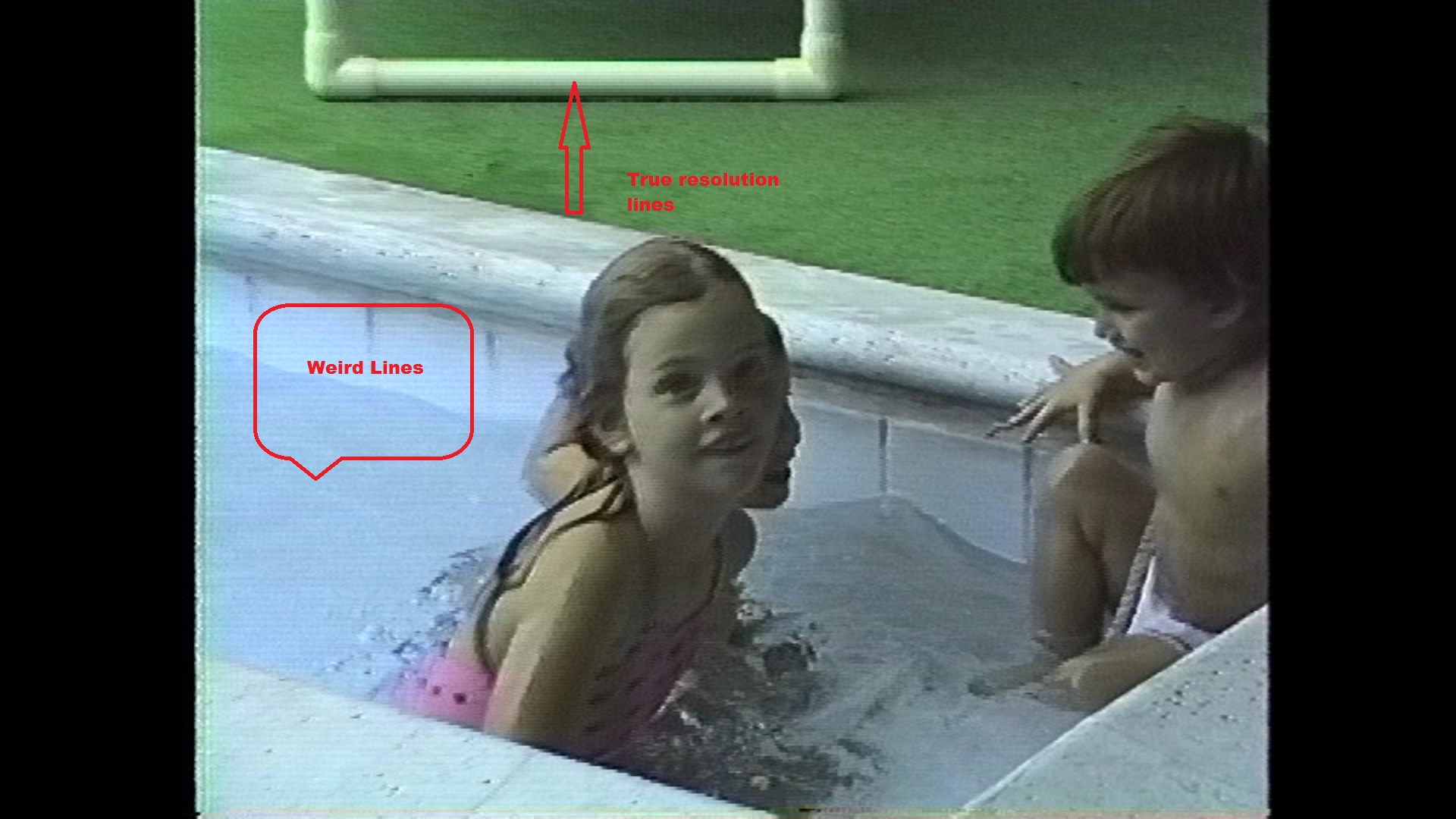

    dellsam34 noticed wierd lines in my uploaded file:
    Something wrong with your captures, In the attached screen shot I see some weird horizontal thick white lines separated by very thin black lines, that's not how resolution lines should look like, They should look like the one shown on the leg of the chair.

    I had noticed those lines, but didn't know enough to realize they were weird. That one was a DV capture via firewire. The one I just posted "xmas 4-2-2..." is an s-video capture through the Magewell card. I didn't notice lines in the recent upload. Both were from the same camera (same 8mm tape).
    Brad had noticed the 120 Hz flicker in that DV capture you're looking at, but I guess those horizontal lines are a much higher frequency than 120 Hz.

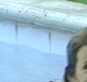

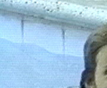

    Well, I tried shutting off the TBC and DNR at the camera (Sony DCR-TRV350), and the weird lines remained. I also captured s-Video to a Magewell Pro Capture HDMI, and the weird lines match the DV capture. I also captured a snip with interlace combing to verify the weird lines don't seem to match the interlace scan lines:
    [Attachment 52974 - Click to enlarge]
    Update: Looking closer, the banding actually does line up with the interlace combing.

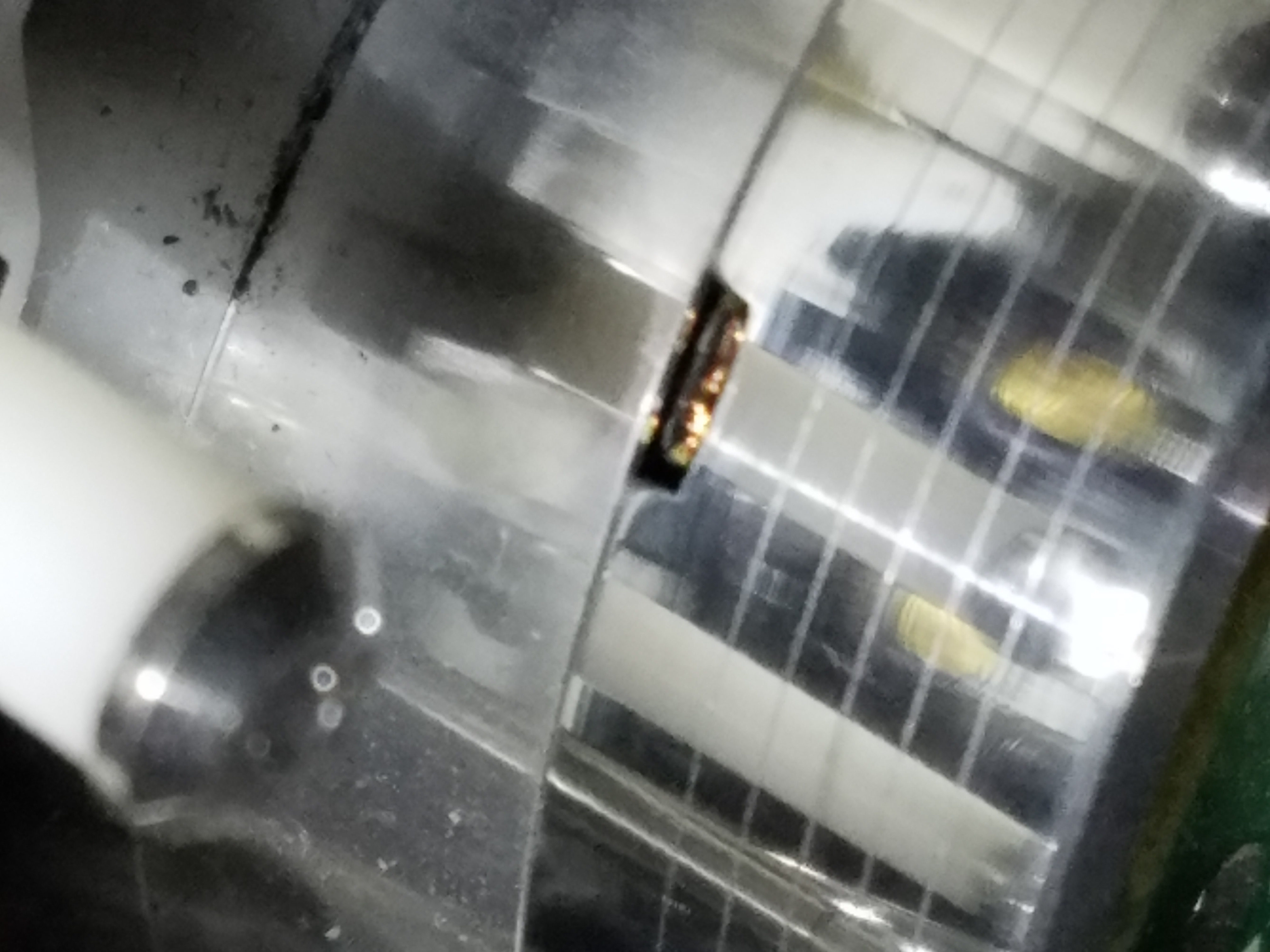

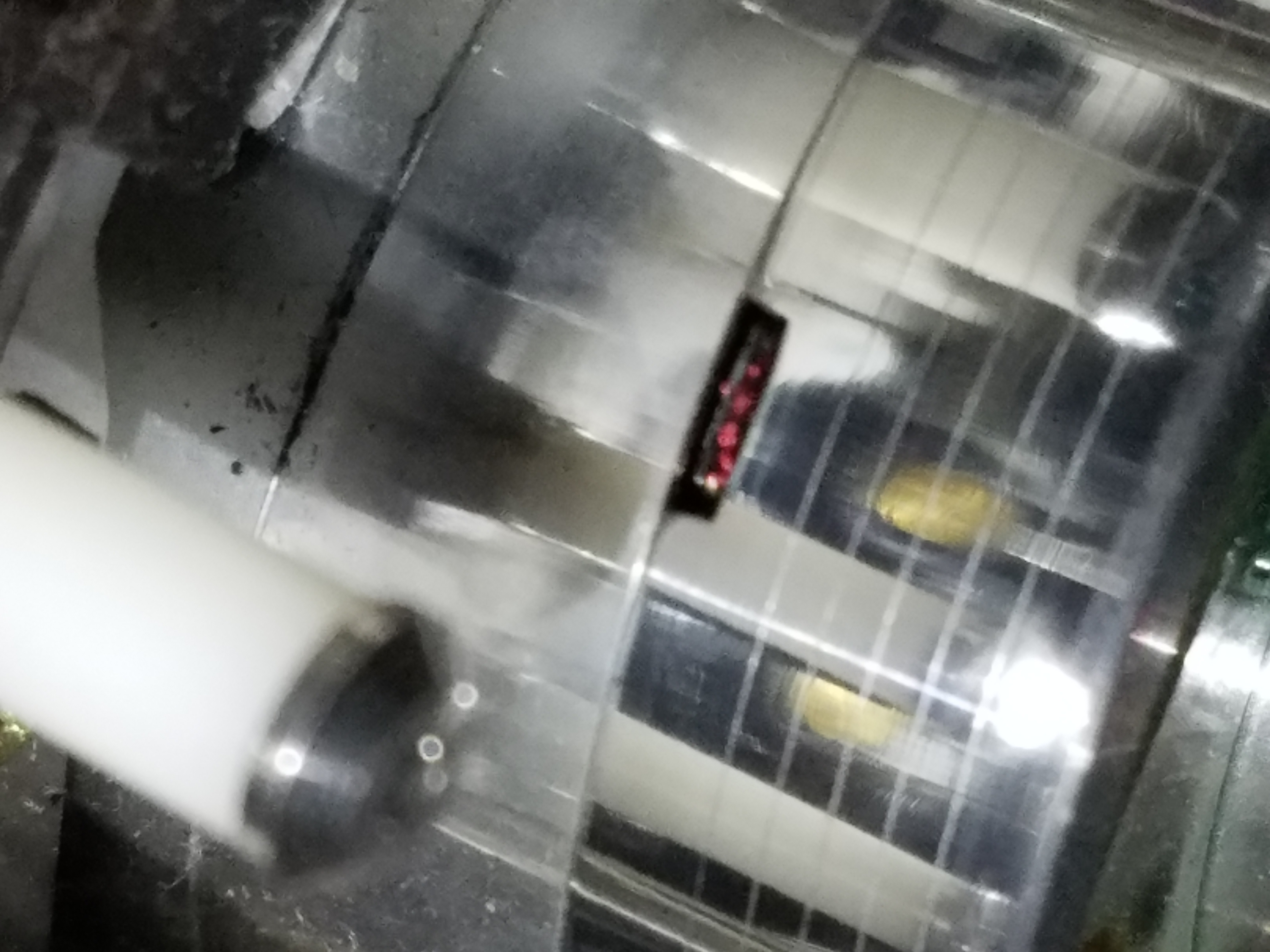

    [Attachment 53005 - Click to enlarge]
    This is the head at the opposite end of the trio (rightmost I believe) of the 3 heads:
    [Attachment 53006 - Click to enlarge]
    I hooked up composite video from the old camera to a TV - same banding lines visible, so I'm thinking this was laid down on the tape by the old camera...

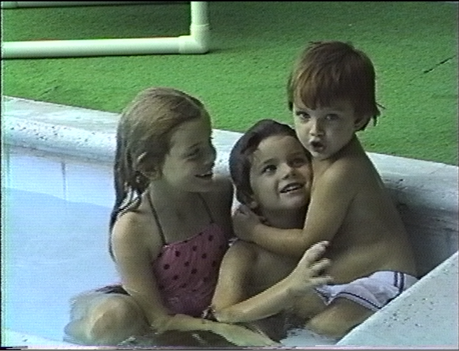

  27. In this DV video brought in via firewire, the field-to-field (every other scanline) banding is present full frame. The interlace combing seems to line up with the banding. The images are screen captures from VirtualDub.
    [Attachment 53016 - Click to enlarge]
    This field-separated DV video is confusing. For some reason, the separate fields look cleaner than the s-video capture, but the fields (attached video and image below) show the horizontal lines that were evident in the s-video capture. (this image of a single field is resized to 640x480)
    [Attachment 53017 - Click to enlarge]
    Shouldn't the resized Field have blank lines where the other Field would be interlaced? Maybe the Field banding is the blank scan lines that aren't being filled by the other field?
