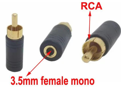

Sorry for taking this long, i completely forgot about it, but now im thinking of finally doing this setup, so
1)First i get a splitter like this
2)Then i get an rca to 3.5mm to one end, to get sound to my bluetooth
3) And finally an rca to rca mono that gows to the sub
I'll getter generic products for Splitter and rca to mono, but Are there any brands that are better than others for the rca subwoofer cable that will give me best results
