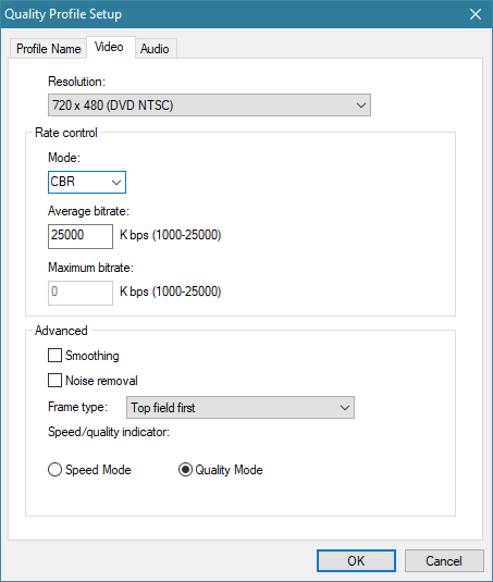

  1. I'm recording some VHS tapes using the Hauppauge USB live 2 than capturing the footage on PowerDirector 18.
    The customs settings are in the photo I provided. Even though it says 25000, the most it went was 15000 on a few minute test video I did.
    Problem is when the full capture was finished, it only gave me a video bitrate of 11200 mbps and changed it to variable. How do I make it to be a constant 15,000 to 20,000 bitrate video?

    I do not use Power Director but I do have a USB Live 2. Something puzzles me.
    Reading your OP literally you are capturing with the USB and then re-capturing with Power Director. Surely I have that wrong. Maybe you meant encoding/exporting with the latter. And I ask this since I can see no such instructions for capture settings in the Power Director User Guide.
    But also assuming that this is an encode/export why so much bitrate. What is your final storage medium ? Certainly dvd maximum bitrate is lower than what you are attempting and there is no point in encoding higher than what you capture in the first place (assuming that was done in the USB Live)
  3. Most likely you've 'saturated the codec'. That term means it's using all the bitrate it can. It's maxed out the quality,
    You don't want constant bitrate and you'd probably be better off using a quality-based encode, rather than a bitrate-based one. It might be called CRF or something similar and needs only a single pass. I don't use Power Director either.
  4. Did you I'd try to fill in that box with max bitrate, same effect?
    11000kbps for SD resolution (and guessing H264) should be fine.
    Maybe it is following your set profile or a default profile, Main 3.0 and keeps max values by specs:
    https://en.wikipedia.org/wiki/H.264/MPEG-4_AVC#Levels
    Or change your profile if it is possible, maybe it will allow higher max values.
