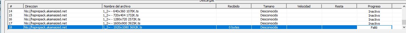

Thank you for sharing two options, I am trying to get youtubeDigger to work, without luck until now:
I got the stream addresses and clicked on start download but it just does not start downloading.
there is always 0.00% under "Progress" and after some time it says "failed", I don't know what I am doing wrong.
