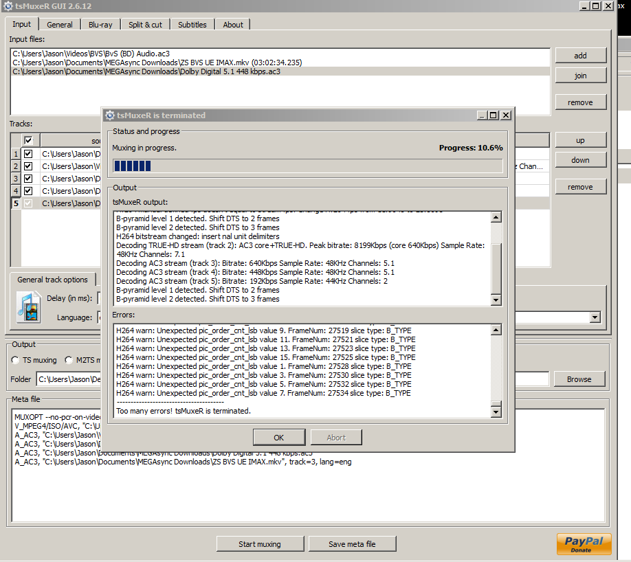

    I am trying to mux a movie for a Blu-ray, and while the mkv is 23.976 fps (confirmed in mediainfo), tsmuxer is reading it as 23.8095. It won't support that, so I change it to 24000/1001. It starts to run--with the disclaimer that the SPS parameters are not consistent throughout the stream--and then gives me a never-ending string of this error: "H264 warn: Unexpected pic_order_cnt_lsb value 11. FrameNum: 8227 slice type: B_TYPE".
    First, why is it misreading the fps? And second, how do I fix this?

  6. Same thing...it won't even let me get started, as "non standart [I assume that means standard] value do not supported for PGS streams." I remove the subtitles file and it actually gets started, but then it gives me that never-ending string of errors again and then terminates, so I never actually get a final output. This happens also when I keep the subs but change the fps to 24000/1001.
