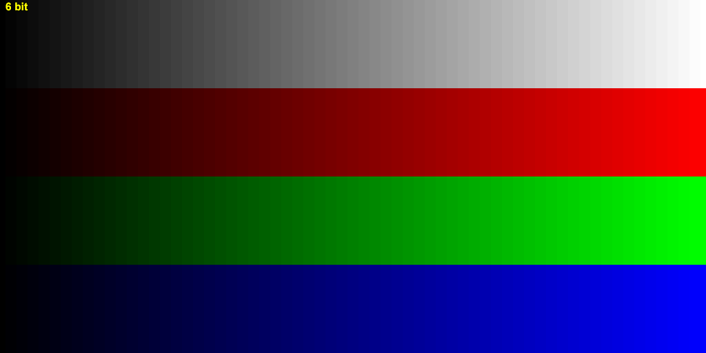

    The 10 bits don't get you a wider gamut of colors, just more in-between colors. For example, here's an RGB image with 6 bits of each primary (be sure to view the full size images):
    [Attachment 52814 - Click to enlarge]

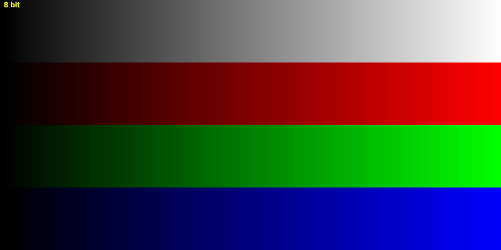

    Compare that to a RGB image with 8 bits of each primary:
    [Attachment 52815 - Click to enlarge]
    As you can see, the overall range of colors is the same. But the 8 bit image has more in-between colors. The 6 bit image can only encode 64 different shades of each primary (and you can probably see every transition on your monitor), the 8 bit image can display 256 shades of each primary. A 10 bit image would cover the same range of colors but would have even more intermediates colors, a total of 1024 different shades of primary.
