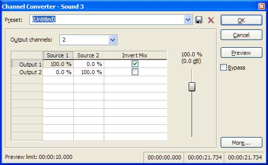

    I opened the Audio in Sound Forge and converted to one channel mono.
    The intro survives, but that's all.
    My guess it the rest of the audio is out of phase, it gets converted to mono on the phone and disappears

  9. Can you explain "out of phase" and what you could suggest I do to get it in phase?

    Mar 2008
    When I was a Hi-Fi geek more than 30 years ago, you could get this effect by reversing the wiring of one of the loud speakers.
    When you play a mono record and brought the speakers close together facing each other, the music disappeared.
    One speaker is exhaling while the other is inhaling, cancelling each other out.
    In the digital signal, one channel is inverted versus the other so you get a similar result.
    Why it got like that in the first place, I don't know but I'd say go back to the original file created from the microphone
    and start there. I can upload a fixed audio if necessary

    Mar 2008
    Here's the fixed audio from the original mp4 upload, and an image showing the remapped channels (from Sound Forge)

    Mar 2008
    When I opened audio in Sound Forge (I use this because I'm more used to it and the basic controls, such as channel conversion are simpler to do)
    You see the audio and at first glance, it looks OK. But if you do a convert to mono, only the intro and outro wave forms are there,
    the center speech is just a flat line.
    I copied the speech to a new file, did the channel conversion, and copied it back into the original replacing the bad section
    You can use something like Avidemux to mux it back into the video
    Here's one of the other files I added the audio back to the video.
    You better look through your processing chain carefully to figure out where the audio inversion is happening.
