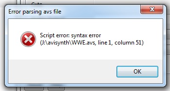

  7. Is this also an AviSynth script? Because i got an error message:
    deleted the "-" at the end, i got this:
  8. No that was a command line to use FFmpeg.

  10. @selur
    Sorry, my bad. Now it worked:
    @Jagabo
    Thanks, but how i set the path to my video file? At the moment it says: Script error: There is no function named 'LWlibavVideoSource'
