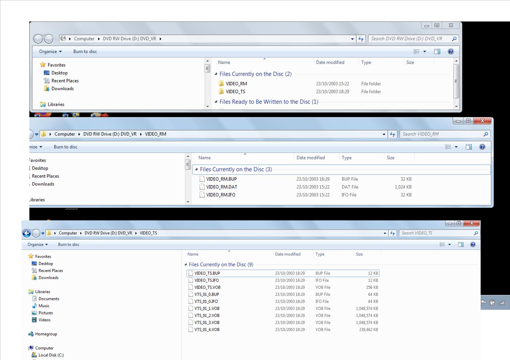

    This is what I see

  8. Member DB83's Avatar
    Jul 2007
    As I thought. The dvd was created in a dvd-recorder in video-recording mode (RM is the clue here) rather than the standard dvd-video mode. Modern PC players can handle this but if you attempted to play this disk in a dvd-player and not the machine it was created in playback would more than likely fail.
    It is also much harder to extract the video from such disks since most the methods quoted above only work for dvd-video disks. Maybe the method quoted by ProWo can do this but I have not tried and I do not have a recording-mode disk to try it on.
