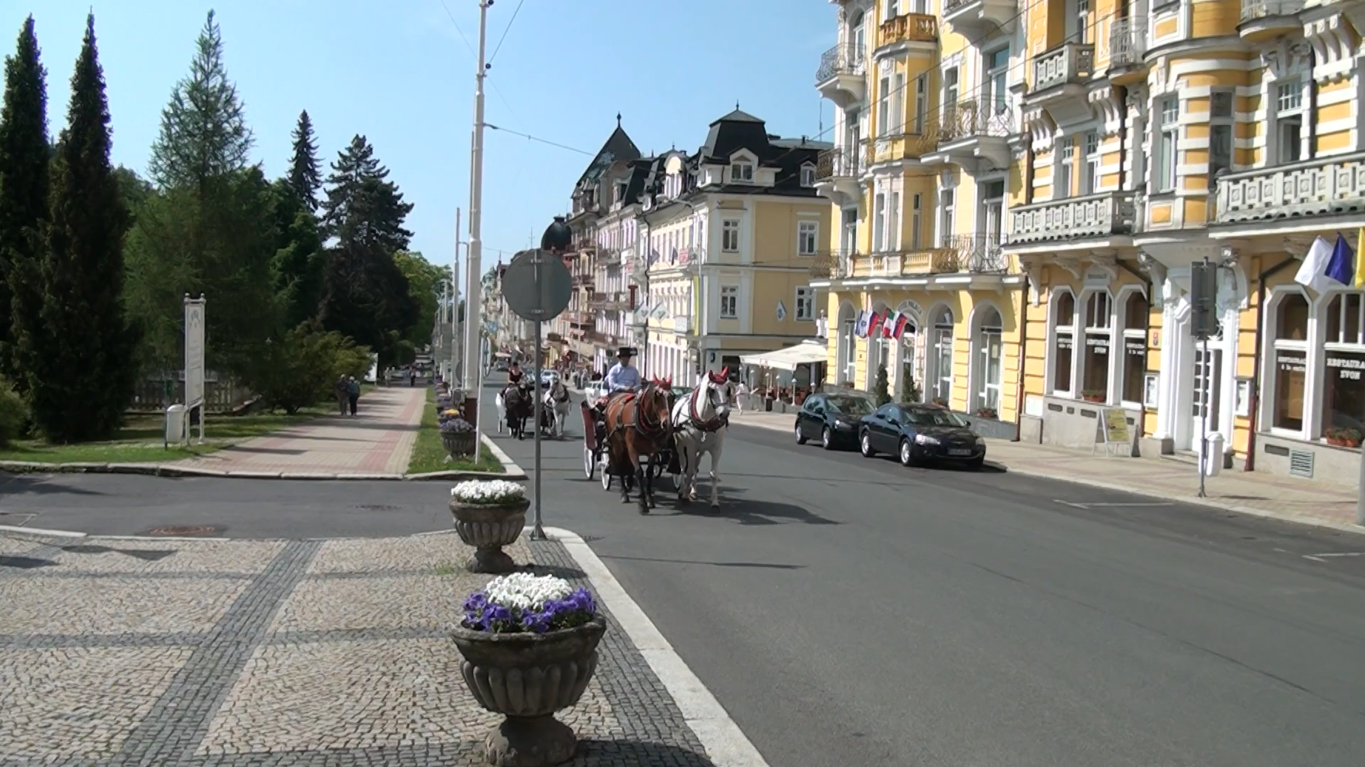

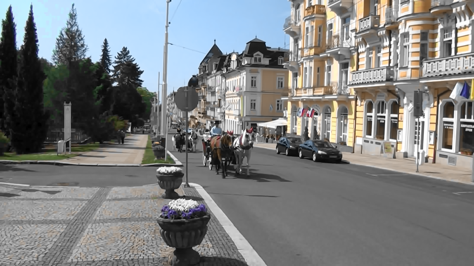

  13. images in this order:
    src, edgemask, denoise, result
Name:	clip_01_[1920, 1080, 0, 0]_frame_0000000.png
Name:	clip_02_[1920, 1080, 0, 0]_frame_0000000.png
Name:	clip_03_[1920, 1080, 0, 0]_frame_0000000.png
Name:	clip_04_[1920, 1080, 0, 0]_frame_0000000.png
  14. to break down retinex_edgemask:
    this line:
    edgemask = kagefunc.retinex_edgemask(src).std.Invert()
    is this:
    def kirsch(src: vs.VideoNode) -> vs.VideoNode:
        Kirsch edge detection. This uses 8 directions, so it's slower but better than Sobel (4 directions).
        more information: https://ddl.kageru.moe/konOJ.pdf
        weights = [5] * 3 + [-3] * 5
        weights = [weights[-i:] + weights[:-i] for i in range(4)]
        clip = [core.std.Convolution(src, (w[:4] + [0] + w[4:]), saturate=False) for w in weights]
        return core.std.Expr(clip, 'x y max z max a max')
    Y = core.std.ShufflePlanes(src, 0, vs.GRAY)
    retinex = core.retinex.MSRCP(Y, sigma=[50, 200, 350], upper_thr=0.005)
    kirsch_edge_mask  = kirsch(Y)
    tcanny_edge_mask = core.tcanny.TCanny(retinex, mode=1, sigma=1)\
                .std.Minimum(coordinates=[1, 0, 1, 0, 0, 1, 0, 1])
    edgemask = core.std.Expr(clips = [kirsch_edge_mask, tcanny_edge_mask], expr=['x y +'])\
                   .std.Invert()
    so looking at that last expression,
    kirsch_edge mask value and tcanny_edge value are added up, and guessing it should be clipped to max value where for some reason it was not and those values were doubled?
    or it could be limited right there: expr=['x y + 1023 min']
