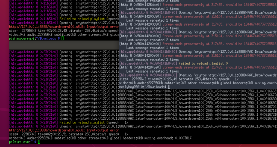

So I had a couple of raspberry pi's laying around. I installed two different deb variants (rasbpian buster and ubuntu) on each of them. Got them all updated and all hosting the same content (streaming out on 127.0.0.1:8888). All three of them exit with the same error of Input/output err at the same time.... I am absolutly stumped... the resulting file is perfectly playable it just quits early.Code:.... [hls,applehttp @ 0x23f21e0] Opening 'crypto+http://127.0.0.1:8888/AAC_Data/howardstern100/HLS_howardstern100_256k_v3/howardstern10...0112987_v3.aac' for reading [hls,applehttp @ 0x23f21e0] Failed to reload playlist 0speed= 1x [hls,applehttp @ 0x23f21e0] Opening 'crypto+http://127.0.0.1:8888/AAC_Data/howardstern100/HLS_howardstern100_256k_v3/howardstern10...0112988_v3.aac' for reading http://127.0.0.1:8888/howardstern100.m3u8: Input/output error size= 225830kB time=02:00:26.51 bitrate= 256.0kbits/s speed= 1x video:0kB audio:225829kB subtitle:0kB other streams:0kB global headers:0kB muxing overhead: 0.000381% R610:~ $

[Attachment 52690 - Click to enlarge]
You can see all three boxes with same errored output after 2 hours... all three boxes can save via vlc gui or streamlink for many hours. It has to be something simple I am missing. Thanks again
