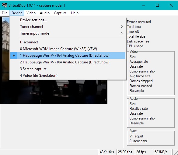

    CAPTURE RESOLUTION with VirtualDub

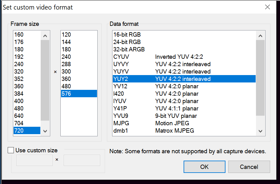

    This is the main problem I have been tackling. Here is how the device appears in VirtualDub, which is basically the same as it appears in all the other programs I mentioned.
    The device has what seems to be the typical label of "Hauppauge WinTV-7164 Analog Capture (DirectShow)".

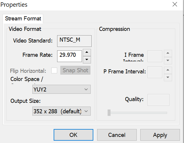

    The capture pin screen only has 1 color space options (YUY2), and 1 output resolution of 352x288.
    The capture filter screen has basically no options.
    The crossbar settings are interesting, and will be referred to later. #2 and #3 show the picture, but #5 and #6 do not. I reckon #5 and #6 relate to the onboard connectors that apparently can be used to connect more physical connectors, for swapping between devices. Not sure why #0 appears, as this doesn't relate to the tuner.
    So yer, not happy about the 352x288 resolution. Looking this resolution up on the internet, the wikipedia page for "Common Intermediate Format" (CIF) (https://en.wikipedia.org/wiki/Common_Intermediate_Format) talks about it, and also refers to it was "Source Input Format" (SIF), and labels the format as "CIF/SIF(625)". The page also says "[CIF] is a standardized format for the picture resolution, frame rate, color space, and color subsampling of digital video sequences used in video teleconferencing systems. It was first defined in the H.261 standard in 1988." and "In contrast to the CIF compromise that originated with the H.261 standard, there are two variants of the SIF (Source Input Format) that was first defined in the MPEG-1 standard." So now I am wondering if the card only outputs MPEG encoded analogue video at this resolution, which some posts on the internet certainly imply. This is no good!

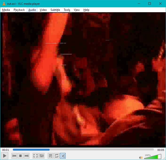

    And success! As ffmpeg was capturing, it reported the input was uncompressed video, as you would hope! Here is a screenshot. Note the buffer error that I haven't looked into yet.
    When I put in the following command, it reports the following for the video;
    .\ffmpeg.exe -f dshow -i video="Hauppauge WinTV-7164 Analog Capture" S:\out-test.avi
    Stream #0:0: Video: rawvideo (YUY2 / 0x32595559), yuyv422, 352x288, 25 fps, 25 tbr, 10000k tbn, 10000k tbc
    So that defaulted back to the CIF/SIF size, but it still says 'rawvideo'. Now I wonder if it was always returning raw video, and there was just something wrong with the dialogues in VirtualDub etc? Interestingly, I went back to Debut, because I remembered it had lots of format options, but they were all the same size. Check this out;
    I counted, 14 options in Debut, and 14 reported by ffmpeg. So, something must be falling down in the drivers or similar that is preventing these options from coming through to programs like VirtualDub and GraphEdit. Very interesting...
    Unfortunately, I have NFI how to fix that. As I said, with my limited knowledge, I poked around in the driver files to no success. I even ran a few searches in my PC registry, but found nothing.

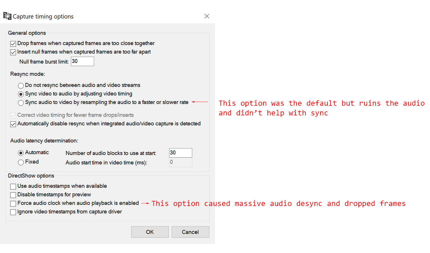

    So now, I am nearly able to rip with this card. Unfortunately, I can't connect VirtualDub and ffmpeg to it at the same time, so I don't know how to monitor the progress of my rips. Maybe I can watch the file with VLC? Or can I fork the feed with GraphEdit? My tapes are mini VHS from home camera, so I could always just let them play start to end. However, I would like to receive some advice from the pro's on how best to proceed, given the above info. Will it be possible to fix the issue of formats in programs? That would be ideal, for me and anyone else in the future who happens to use this card.

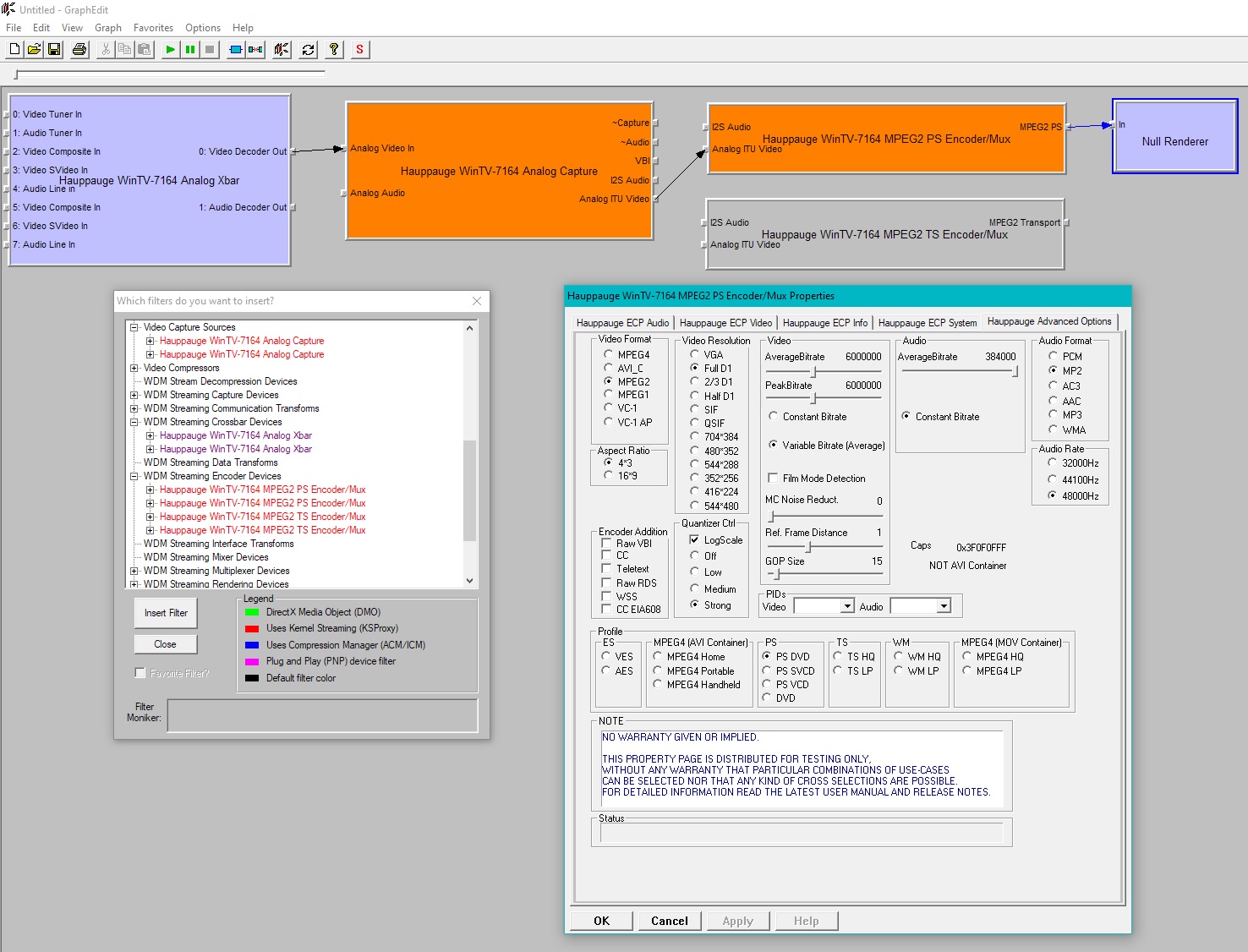

    So that got me thinking that I need to find that filter and connect to it, which I managed to do. I also found the crossbar filter. Here is what I found in GraphEdit;
    [Attachment 52645 - Click to enlarge]
    But within that properties box, you cannot change the "Video Format", nor the "Profile", except to another PS option. The same occurs on the "TS Encorder" filter, you cant change format, and can only choose a TS profile.
    Any more suggestions?

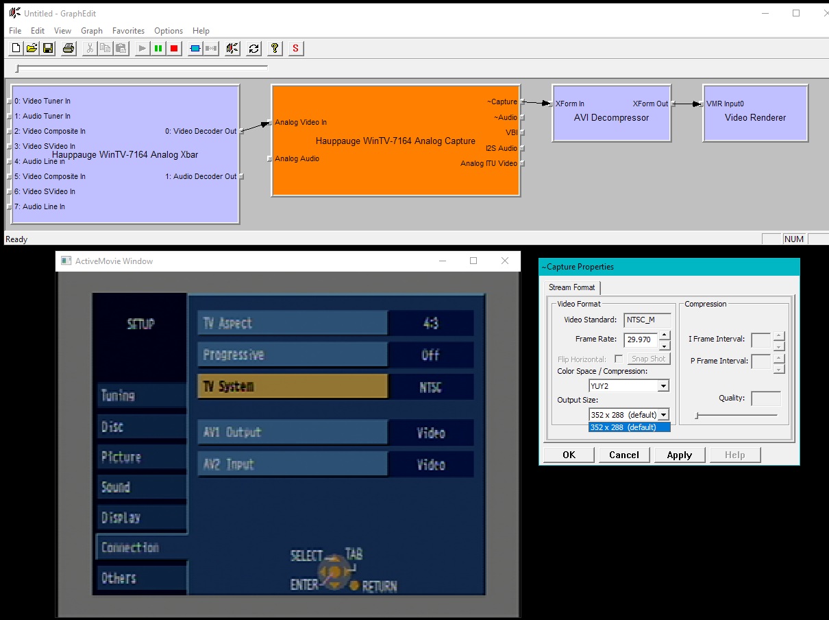

  5. I can (just did) set the dvd player to ntsc, but when I play my dvd, it reverts to pal. So I can only see the menu as ntsc, which does get detected automatically by the properties boxes in GraphEdit, but the resolution options stay the same.
    [Attachment 52646 - Click to enlarge]
    Re ffmpeg, yes I did 3 small captures with it in 720x576, 704x576, and 352x288 resolutions. This was with exact command I posted above, which didnt have any compression set for the output (so it defaulted to whatever mpeg-4 settings ffmpeg desired). All 3 reported raw video input, as above. The smaller 2 didn't have the buffer error. The bigger 2 had some white lines appear in the capture though. Here is a screenshot of one of them;
    [Attachment 52647 - Click to enlarge]

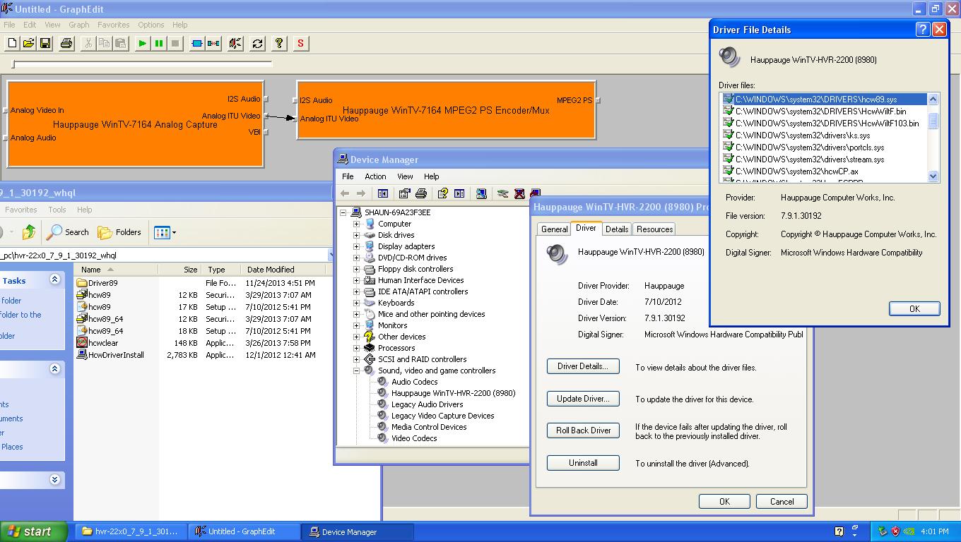

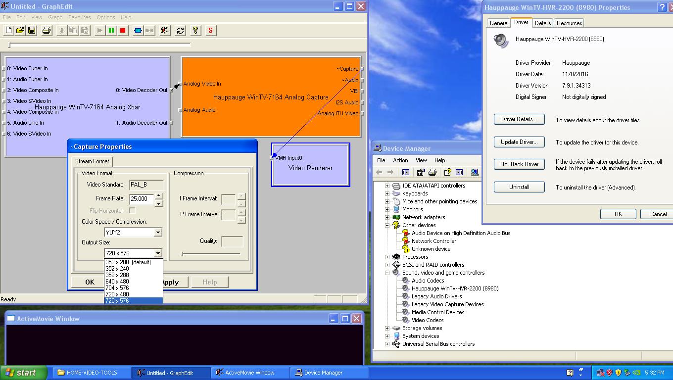

  6. Well I thought I should be thorough at my investigations, so I set up an XP machine. Check out how the capture card barely squeezes in between the GPU heatsink, the mobo heatsink, and how it presses on that capacitor! :S All the slots below the GPU were PCI.
    [Attachment 52648 - Click to enlarge]

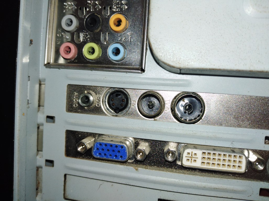

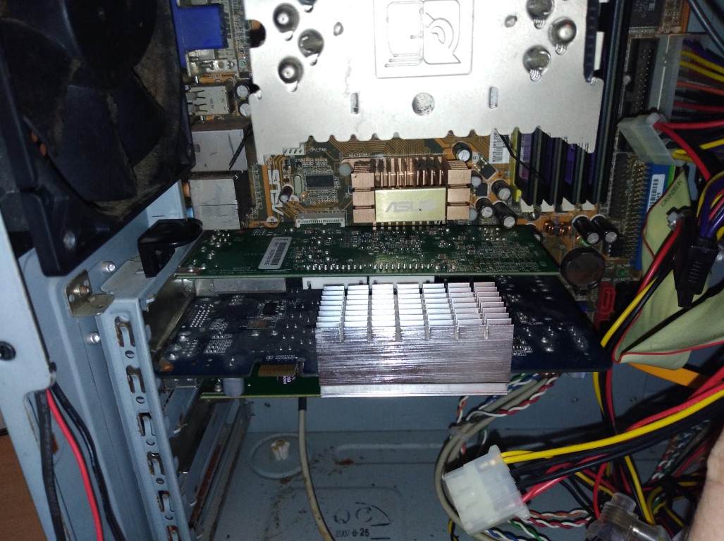

    I also took a picture of the rear panel whilst I was at it, for proof;
    [Attachment 52649 - Click to enlarge]
    I used Win XP SP3 32bit "final" disc I had laying with all updates inlined from 2013, installed gpu and chipset drivers, and disabled the other devices like audio and lan (CBF installing). I installed the "original" working driver that I mentioned earlier, and everything appeared to be working (didn't actually test). Check out the screenshot below. Notice it doesn't have the ~Capture pin at all, like I eluded to in my first post. This must be a rather new driver feature - post 2012 at least.
    [Attachment 52650 - Click to enlarge]
    So I installed the latest "stand-alone" driver from their website - 34216 - which installed, but the device wouldn't run. It had an exclamation next to it in device manager, saying driver corrupt or similar. I wiped the drivers with the HWClear tool from the first lot of drivers, installed again, and it was still broken. It seems these drivers from their website are broken!
    So I thought I would do my trick of installing WinTV 10, but it needs an internet connection to run the installer. OMG, so much effort. So I installed that, which needed .NET 4.0 now too, but it eventually got there. And it fixed the driver issue. And I just noticed as I was doing the screenshot below, it is a new driver version too - 34313. That explains why WinTV 10 is the secret sauce! Here is the glorious result;
    [Attachment 52652 - Click to enlarge]
    So good call Brad, you were right. The "ActiveMovie Window" was rendering on my screen, it just wouldn't save in the screenshot - but note it's size was 720x576. I had to connect the crossbar to get it to work, because it didn't default to any input pin. Also note that only some of the resolution options came through. It is strange how not all did though. Something else must be at work here...
    But there are other differences in this setup other than XP, and any of them may be responsible;
    First, on the PC I was originally using - a Win 10 x64 PC - I was using GraphEdit x64. But on the 32bit XP machine, I was using the 32bit GraphEdit. So maybe using 32bit GraphEdit is the answer?
    Second, when I right clicked > render pin on the XP machine, it fed the ~Capture pin directly to the Video Renderer filter. However, looking at the screenshots above, it put an AVI Decompressor filter in between. Maybe that is causing the issue?
    Lastly, even though I did install the WinTV 10 drivers on my newer PC, I'm not 100% sure that they are actually getting used by the device. So I might do a driver flush and reinstall, and see if that helps.
    Will report back in due time.
    Edit: Rebooted the XP machine to test theory #2, and have made a discovery. When using the AVI Decompressor filter, it shows and lets you select the other resolutions, but when you apply it says "The format is not currently available". So it must be that filter forcing the other filter to output 352x288. Note, I can select either "352x288 (default)" or "352x288" options in the dropdown.
    Edit2: Tried connecting a few different things to the output, and each does different things. For example, the compressor "Cinepak Codec by Radius" put the "AVI Decompressor" in between, and then only allowed 720x576 resolution to be used. Strange.

  9. So the Win10 machine was running 34216, even after the WinTV10 "install". I then tried to manually set the size in VirtualDub, and it worked, for all sizes in the first post! Except, not all of them showed a picture (mostly the unusual sizes didn't).
    Next I tried 32bit GraphEdit, which was no different.
    Then I changed the driver to 30192 (in device manager I could just pick a different driver from a list), but there were no differences in graphedit or with the ffmpeg query.
    So now I went on the hunt for the mysterious 34313 driver, and I discovered a lot in the progress. I eventually found it at this link: https://drp.su/en/hwids/PCI%5CVEN_1131%26DEV_7164%26SUBSYS_88000070
    That link is for a nearly 40mb zip file, and it seems to contain ALL of the latest Hauppauge drivers (as of 2019), for all their devices on all Windows versions! It comes with an installer exe, and uninstaller (the hcwclear.exe I mentioned previously).
    The HVR-22xx drivers are regularly called "driver89" and "hcw89", so that must be their internal device number (89). That's important to mention, because drivers with number 34313 exist for other Hauppauge devices.
    So I opened the file driver inf files and found;
    "hcw89.inf" had version "11/08/2016,7.9.1.34313"
    "hcw89_64.inf" had version "08/03/2016,7.9.1.34216"
    So that explains that - the 64bit drivers didn't get updated. And you can't install the 32bit drivers on the 64bit system - I tried.
    Now in the process of doing the above, I completely borked my driver install. Even after flushes and driver re-installs, the device would no longer capture. In GraphEdit, the filter only had the 3 output pins like in the first screenshot I took from XP. I had to do the WinTV10 reinstall method again, and then it started working. But then I realised what the problem most likely was - the crossbar wasn't configured. Doh! I'm betting that if the crossbar was configured correctly, the ~Capture pin would have appeared. And this was most likely the drama I had at the start of the first post - unconfigured crossbar. The WinTV10 installer must have some additional routines within it to get the crossbar working.
    So yer, I think I've reached the end of the road with regards to what I can do. It seems like it will do a clean capture with VirtualDub and a custom format, so that's what I'll do.
  10. Hi,
    Late reply and for anyone who comes here but I want to give some of my own notes when using this card for capturing NTSC VHS tapes.
    Specs: Windows 10 20H2, Virtualdub 64-bit 1.10.4, Wintv-hvr-2250
    VCR is connected to the card through the composite (RCA) breakout cable
    I first also tried the driver from the support page for this product but Virtualdub would report "failed to build filter graph" capture pin. I wanted to try their WinTV app to see if it was a Virtualdub error but I noticed, as you did, it updates the drivers on install. You can stop the installation when it asks for a software key.
    Once I restarted Windows Virtualdub was able to switch to the device for capture but under "capture pin" only 352x288 was shown.
    [Attachment 57808 - Click to enlarge]
    However if you go to set custom format you can manually select up to 720x576.
    [Attachment 57809 - Click to enlarge]
    I ran a lossless capture test (UTvideo) between 352x288 and 720x576 and the interlacing effect was finer in the higher resolution capture which in turn made the image clearer.
    Here's a small part of the background from screenshots of each. The capture was lossless but you can see how much detail is lost. What I don't really understand is that NTSC VHS is supposed to be equivalent to around 240 lines of resolution but the 720x576 capture looks better. Maybe this is due to the interlacing effect being more prominent with the lower resolution capture.
    [Attachment 57812 - Click to enlarge]
    Some other notes about this card:
    - I disabled the decomb and noise reduction in video->capture filter because I want to store an archive lossless copy then deinterlace/ apply noise reduction later
    I also assumed their decomb and noise reduction wouldn't be that great
    - There were some timing settings that had to be adjusted to avoid drop frames and audio pitch problems. Screenshot from the capture->timing menu
    [Attachment 57811 - Click to enlarge]

    Correction on video container, else users may obtain a non-playable video using ".yuv" suffix.
    Use a proper AVI video container:
    c:\ ffmpeg -f dshow -crossbar_audio_input_pin_number 5 -crossbar_video_input_pin_number 2 -i video="Hauppauge WinTV-7164 Analog Capture":audio="Hauppauge WinTV-7164 Analog Capture" -c copy test.avi
    Example of using huffyuv lossless compression:
    c:\ ffmpeg -f dshow -crossbar_audio_input_pin_number 5 -crossbar_video_input_pin_number 2 -i video="Hauppauge WinTV-7164 Analog Capture":audio="Hauppauge WinTV-7164 Analog Capture" -vcodec huffyuv -acodec copy test.avi
