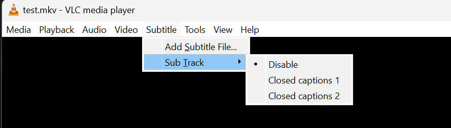

  11. I separated video audio and subtitles with Inviska MKV Extract, then merged them with MKV Muxing Batch GUI v2.3 but this closed captions curse didn't go away. Is there an easier way to delete it, a new updated way. I don't want to see it in the subtitles section on VLC.
  12. For x264 video use:
    ffmpeg -i input.mkv -codec copy -bsf:v "filter_units=remove_types=6" output.mkv
    For mpeg2 video use
    remove_types=178
    To extract them use clever ffmpeg-GUI.
  13. thank you a lot for your reply. but unfortunately I don't know using these codes. I only am good at using softwares. like Inviska MKV Extract, JMkvpropedit 1.5.2, MKV Muxing Batch GUI v2.3, MKVToolNix GUI v74.0.0. Is there any way to solve this issue with any of these softwares or other than that similar to these? Or I need a video to show me how to do what you said.

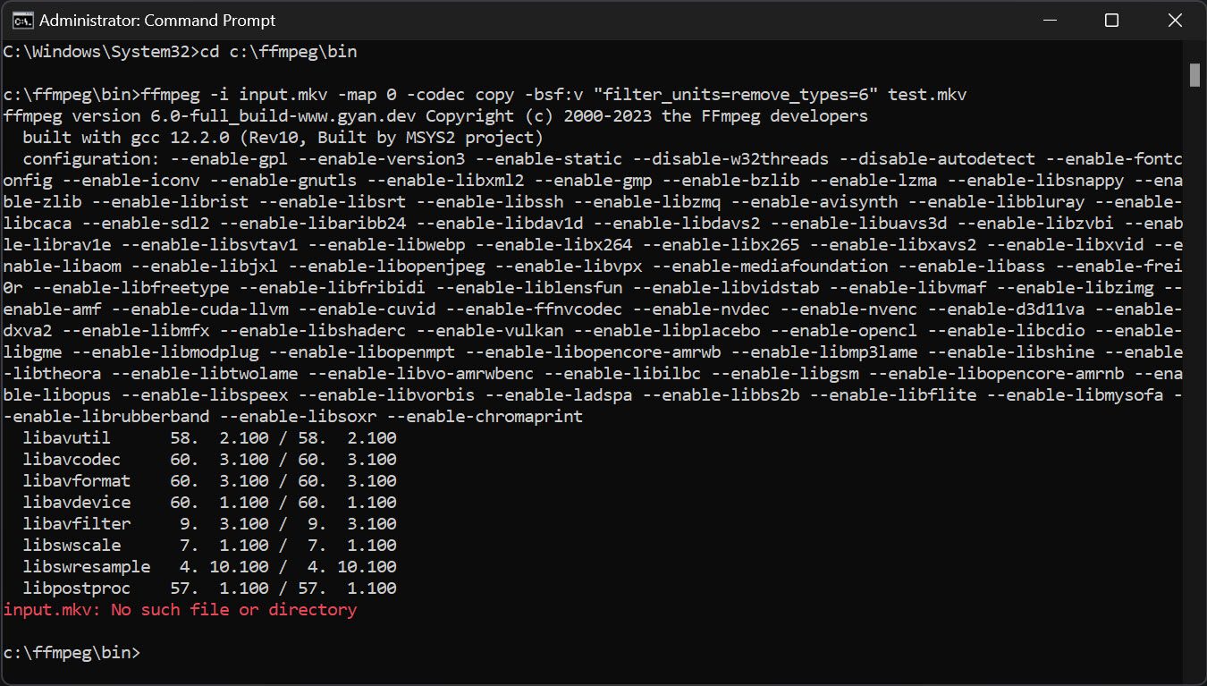

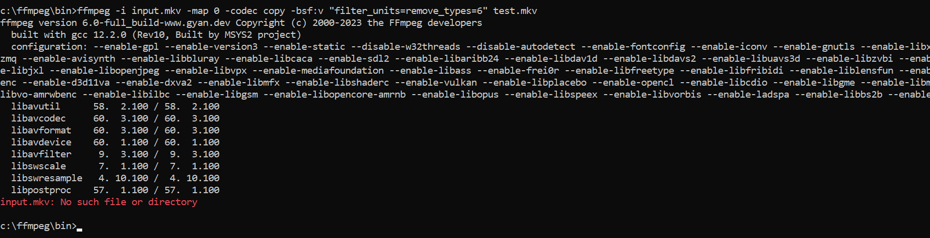

  19. @ProWo Sorry for being late. I tried it now. I did all the required things as you told but it says:
    [Attachment 71035 - Click to enlarge]
  20. @Pusat
    I wrote in post #17:
    Rename input.mkv to the name of your video.
    If the name contains spaces, you have to put them in quotes, e.g. "My personal video.mkv"
    So you must use
    ffmpeg -i test.mkv -map 0 -codec copy -bsf:v "filter_units=remove_types=6" output.mkv
    if your video file name is test.mkv.
    unfortunately, you have turned off the display of file extensions in windows explorer, so you can't see it.
    See here: https://www.autodesk.com/support/technical/article/caas/sfdcarticles/sfdcarticles/How-...n-Windows.html

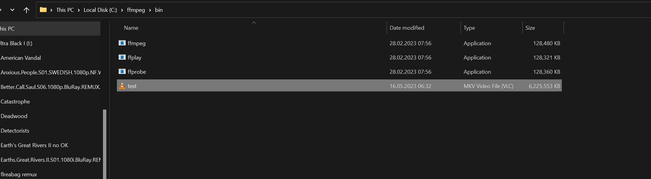

  21. @ProWo
    there's no space in the file name. It's only "test"
    yes displaying of file extensions was turned off and after you told this I turned it on. But still ffmpeg can not see the file. I don't know why?
  22. You must replace input.mkv with test.mkv and the final test.mkv with output.mkv

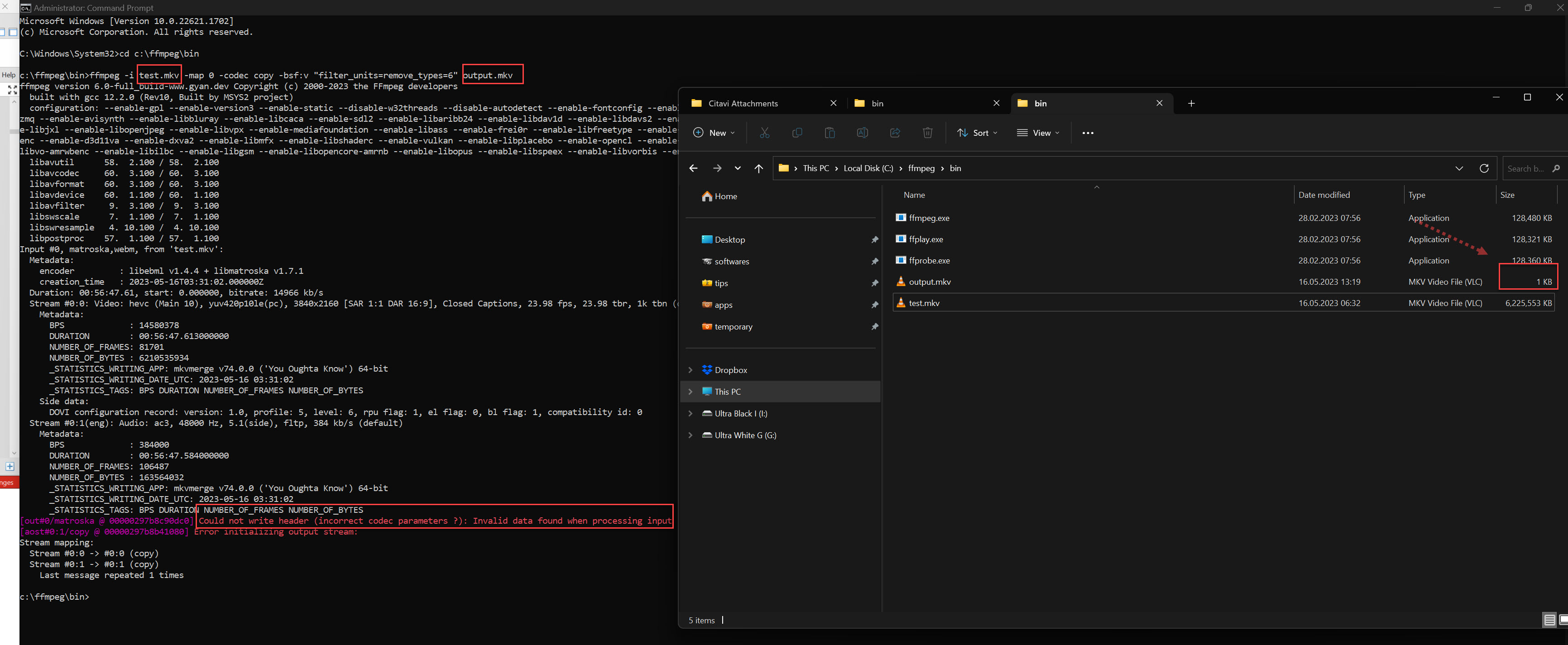

  23. Dear @ProWo I made the correction you mentioned in the command line.
    Now it seems to try to create a new mkv file but the size is only 1 KB and the text you see in the screenshot appears. What could be the problem?
    [Attachment 71049 - Click to enlarge]
  24. Your video is x265 (hevc), not x264 (avc), so the command can not work.
    I must investigate further and will come back to you later.
  25. ok thank you.
    this was mp4 I converted it to mkv with mkvtoolnix. this may be the reason. I don't know. This isn't the video that I want to make changes on it. I just wanted to try this command. I have other mkv files for tv shows.
    Anyway, if this is the way to remove close captions it will be useful for me for other videos.
  26. This should work for your test.mkv (hevc):
    ffmpeg -i test.mkv -map 0 -codec copy -bsf:v filter_units=remove_types=39 output.mkv
