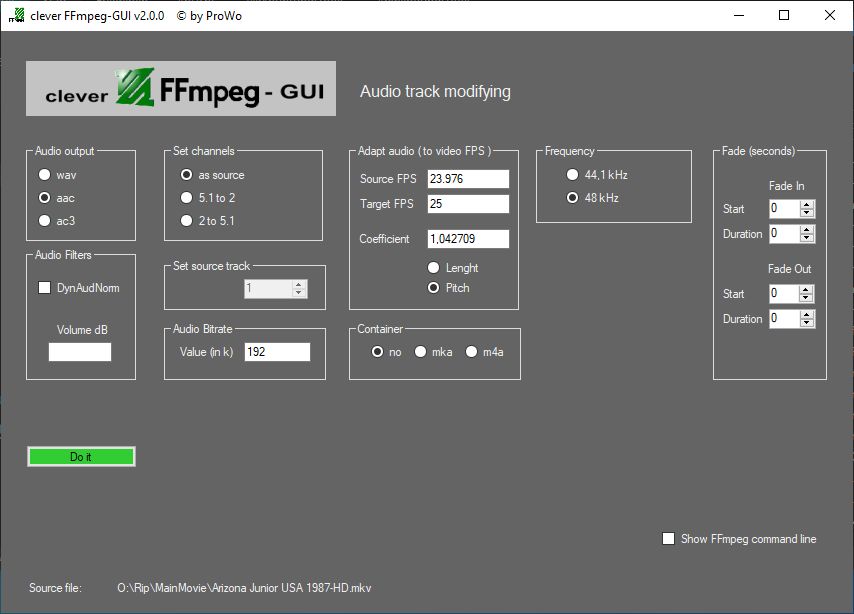

    First you must know the movie FPS (you can see this with MediaInfo). Then you need to know the fps of FisherKing.avi. For example, assuming the DVD movie has 25 fps and the avi has 23,976 fps, you can adjust that with my clever FFmpeg-GUI (section Audio track modify); load the avi as source and export to aac or ac3: See pics for example:
    https://forum.videohelp.com/threads/396490-clever-FFmpeg-GUI-a-new-small-GUI-for-FFmpeg

    I checked in MediaInfo fps Dvd and FisherKing.avi both have 25,000 fps. Your program is great. I try to change a little fps, but it is difficult to do, make them match.
