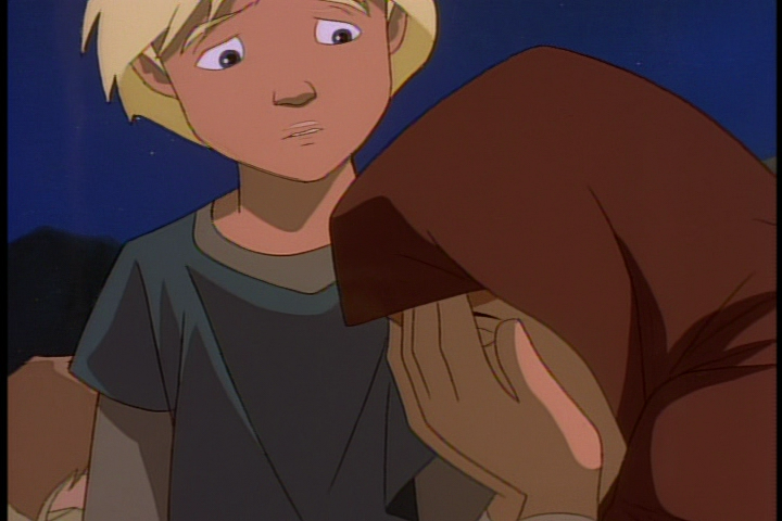

So for these motion artifact, if you look close to the mouth, there is the shadow of the previous frame blend into the next one. Like I said these are more obvious in a close-up, you can see the motion of eye, mouth, eye brown, of previous frames. Look at the mouth of the first sample. But that's when using QTGMC( Preset="Slow", InputType=1 )
[Attachment 52596 - Click to enlarge]

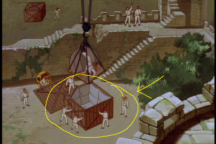

For the jaggy line look at the second sample. The problem seems to occurs when lines are to close from each others.
[Attachment 52597 - Click to enlarge]Last edited by Altruo; 4th Apr 2020 at 00:47.

Sorry but I'm looking at the raw 29.970 version of the sample video, in the area your screenshot shows, and the only movement I see in that area is rainbowing.
Do you still see movement in that region with this script?
Code:MPEG2Source("VTS_01_1.demuxed4.d2v") #Honor Pulldown Flags Greyscale()
Well they appear as well at the end of the sample within the building. But, it seems that I'm going to have to live with either that shakyness or the motion trail. Was just wandering if there was a way to fix it without going through all episode to find scene by scene to fix it with QGTMC.
But I admit that without the rainbow, doesn't look like much. I should just accept it...

With TFM().TDecimate() I see a shimmer at 0:26 caused by TFM's post-processor incorrectly detecting the fine detail of the buildings as interlacing, therefore deinterlacing it using its default low-quality method.
But you said the jaggies were in the original 29.97 unaltered source:
Besides, these default settings don't trigger deinterlacing on the scene that you highlighted in yellow.
So I'm still confused, unless you looked at the unaltered source using a player rather than MPEG2Source (in that case your player deinterlaced it). -
