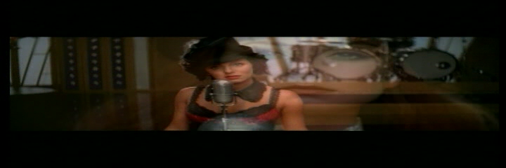

    Field blend at shot change

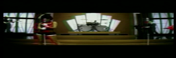

    Static field where only the colors have moved, so the edges of the whites in middle of screen bleed with false green & magenta, there's a red ghost of the singer, etc.
    [Attachment 52585 - Click to enlarge]
    Maybe try a bob deinterlace + SRestore but you may have to try both 23.976 and 25 as the underlying frame rate.
