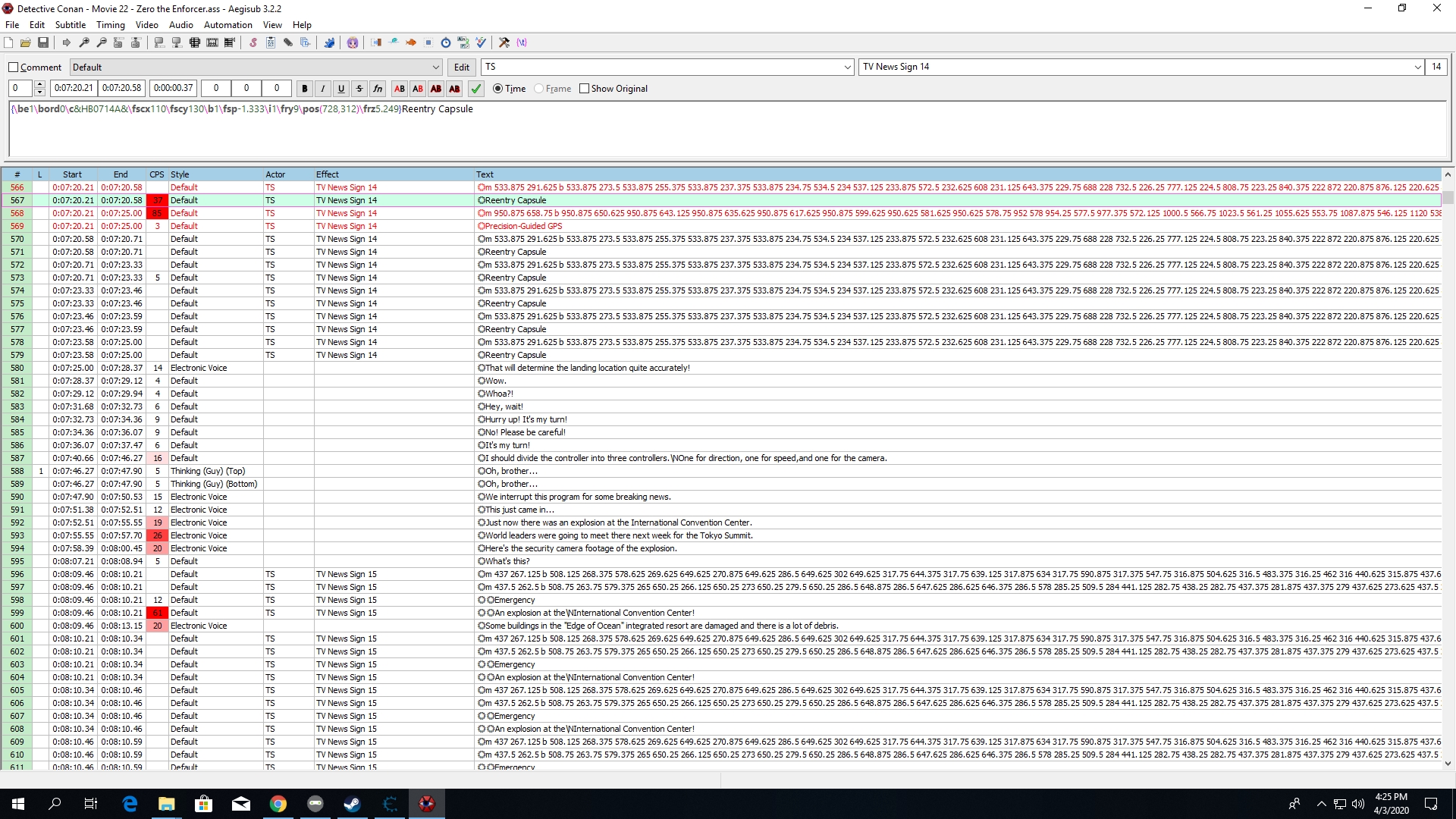

  1. i have an .ass subtitle file which was made by using aegisub. the subtitle file has beautiful effects but because of that the file is huge. it has 30,000 lines and it is 29mb
    some of the lines are repeated as you can see in this pic:-
    [Attachment 52576 - Click to enlarge]
    the subtitle file is filled with lines like that. is it possible to clean the subtitle file and delete all those repeated lines without damaging the subtitle effects? if yes then how?

  5. Better get a simple subtitle, this .ass contains karaoke and signs, in karaoke the words are divided into syllables for each line, how could you remove that without spoiling the file.
    But if you insist ... you can remove the signs, E.g. in Aegisub "Subtitle"->"Select Lines", "Contains" "TS" in "Field" "Actor". Then hit ctrl+del. (you must have a backup .ass)
    In the end export in Aegisub using File->Export Subtitles and save...

  10. i can't merge or delete repeated lines. if i do that then the text effects will spoil. english text is covering the japanese text which shows on the screen like if there is text on tv or on a signboard and repetition is needed to make the text effect
    the only thing that i can do is completely delete each set of repeated text which makes a text effect and i put lines on the top of the screen instead of text effect
