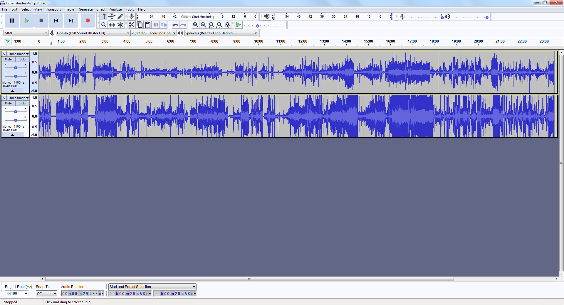

  1. I have two 8mm film audio files that comes from the same source. First audio is played on a projector and is in sync with the video but bad quality due to damaged sprocket holes. The second audio is captured from a sprocket less 8mm sound editor, audio is good quality but out of sync with the video. I've changed the speed of the second audio so it matched the duration of the first audio but it's still out of sync. I've attached a pic of the waveform of the two audios.
Name:	8mm audio sync.jpg

  2. Originally Posted by digicube View Post
    It looks to me like you only have to set the correct delay. Can't you delay the bottom audio so that it matches the top audio? And that bottom one clips, too.
  3. No I don't think delay will work because both audio runs at different variable speeds. Top audio from projector runs at 18fps +/- X%, bottom audio from sound editor runs at 18fps +/- Y%.
    Thought there is some AI magical audio software that can superimpose one audio onto another by matching the waveform, guess not.
    Is there an audio software that allows you to select a portion of the audio and stretch/compress it with your mouse so I can match the bottom waveform as close to the top one kinda like an image editor?

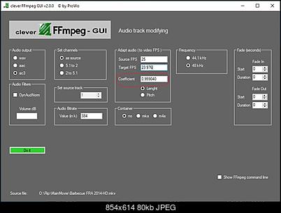

  4. Try my clever FFmpeg gui, Audio track modifying section.
    try different coefficients until your result fits. The audio can be saved as AAC, AC3 or WAV.

  10. Originally Posted by digicube View Post
    You should be able to do it right there in Audacity by splitting up the track and adjusting segments as you go.
