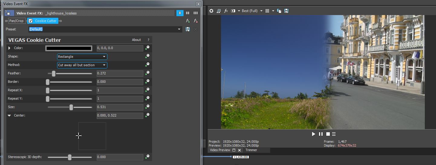

  2. Is cookie cutter effect in Movie studio?
    Use that one on the top event, select rectangle, change size and drag center to desired position. Then you can use feather so borders are not apparent.

  3. image

  4. Yes I just Used Cookie Cutter and also under Cookie Cutter is Crop.
    Both of these work but the Right Side of the Video witch is the Top Video overLay is still very Bright.
    As soon as I Ad the Video ontop of the Other and then Drage or Crop it or use Cookie Cutter to take the Left Side out the Video under it shows Darker then the Video ontop witch is the Right Hand Side.
