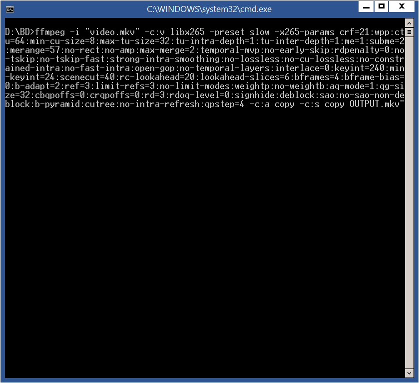

  4. Originally Posted by odin89 View Post
    But even if i remove them i get the error that the command -c:v is not found
    Be sure you didn't also remove the \ at the end the previous line. The \ means the command is continued on the next line. If you remove the \ the command line interpreter will assume the next line is a new command, not a continuation of the previous. This code works for me in Windows:
    ffmpeg -y -hide_banner ^
      -i "test.mkv" ^
      -map_metadata 0 ^
      -map_chapters 0 ^
      -metadata title="TITLE" ^
      -map 0:0 -metadata:s:v:0 language=eng ^
      -map 0:1 -metadata:s:a:0 language=eng ^
      -map 0:2 -metadata:s:s:0 language=eng ^
      -c:v copy ^
      -c:a copy ^
      -c:s copy ^
      "OUTPUT.mkv"
    All i did was remove the extra "-metadata:s:a:0" and "-metadata:s:a:0" and change the \ to ^ (I'm using Windows, and Windows uses ^ instead of \ as the continuation character).
