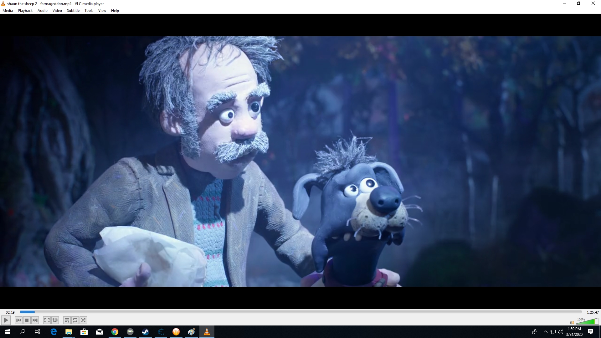

i am using vlc media player to watch my movies
i have video A which is:-
[Attachment 52548 - Click to enlarge]

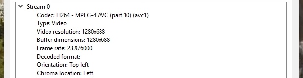

and the resolution of video A is:-
[Attachment 52549 - Click to enlarge]
when i press F to make it full screen i will get this:-
[Attachment 52550 - Click to enlarge]
as you can see the video is nearly full screen. i need to press A once to make it completely full screen and i will get this:-
[Attachment 52551 - Click to enlarge]

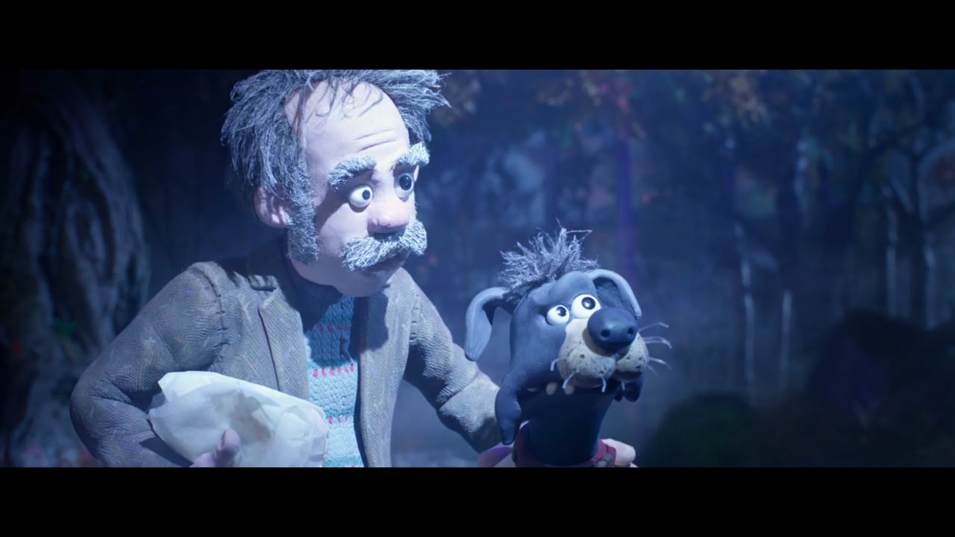

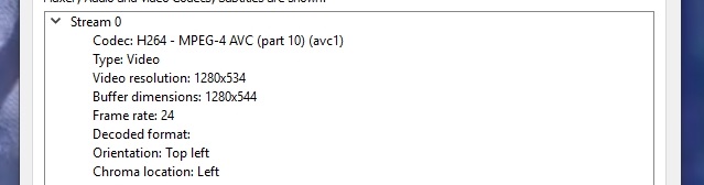

i also have video B which is:-
[Attachment 52552 - Click to enlarge]
and the resolution of video B is:-
[Attachment 52553 - Click to enlarge]

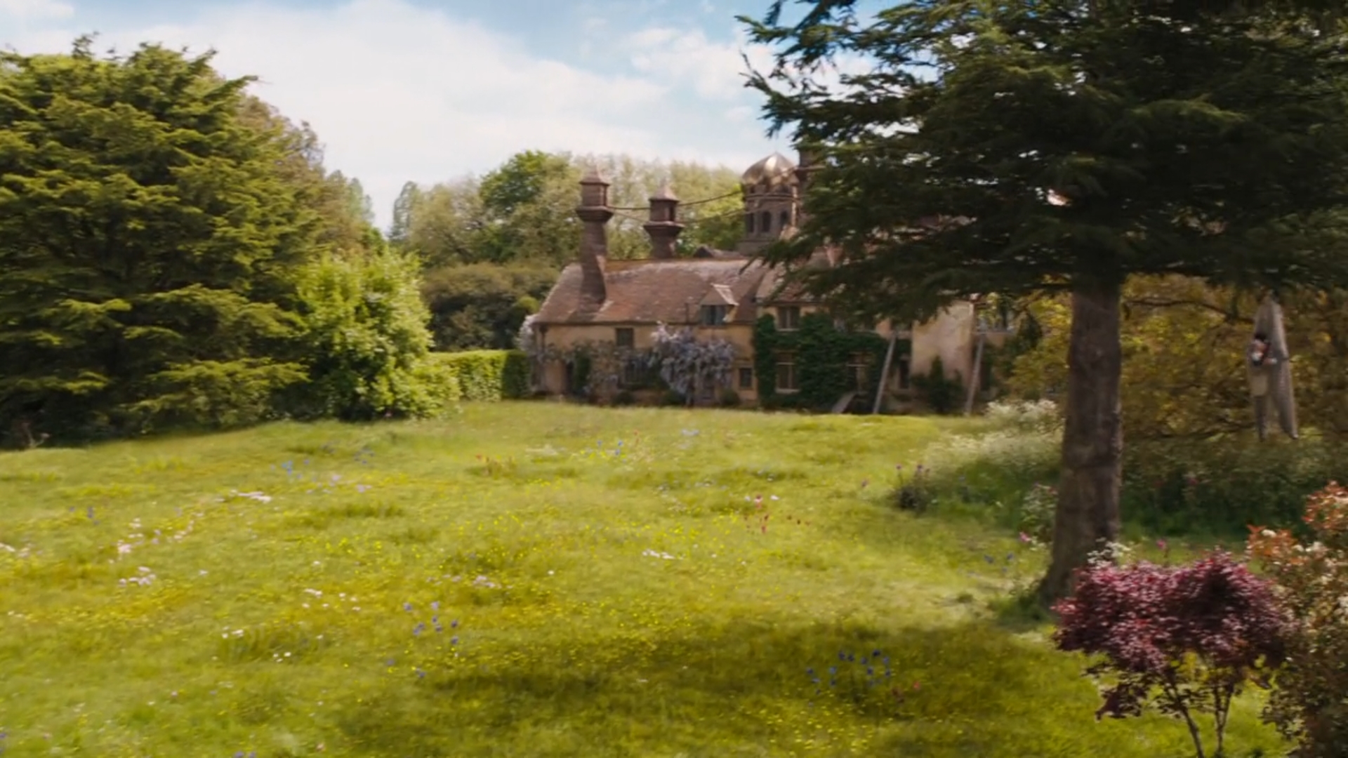

[Attachment 52554 - Click to enlarge]

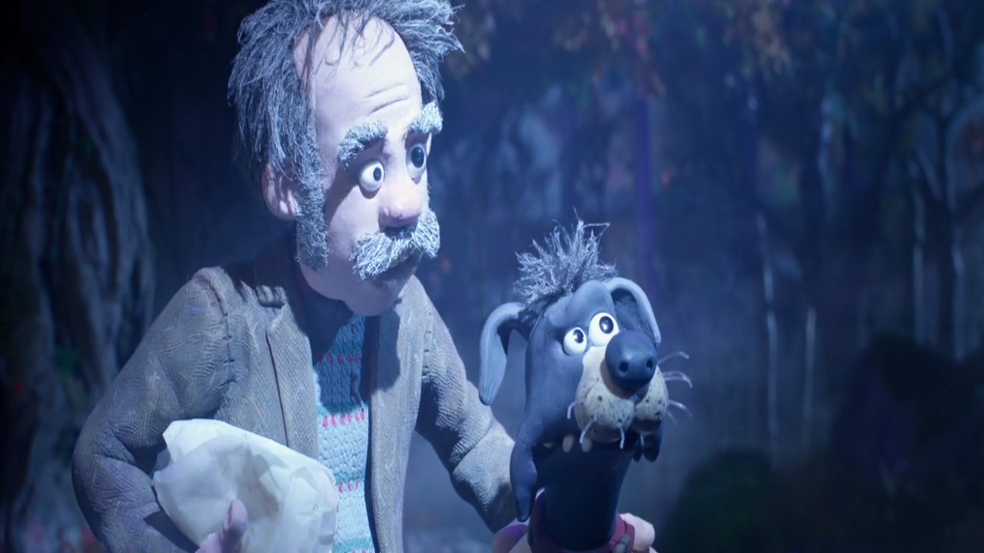

as you can see the video is not properly full screen and there is black blank space on top and on the bottom. i need to press A once to make it completely full screen and i will get this:-
[Attachment 52555 - Click to enlarge]
as you can see the head became warped and stretched. how come in video A it is still ok when i made it completely full screen and it got warped and stretched in video B when i made it completely full screen?
how do i make video B completely full screen without warping and stretching it?

Short answer is you can not.
For perfect full screen for both videos the frame height would have to be 720 pixels. Video 1 is 688 pixels and video 2 is even smaller at 544 pixels.
So both are being stretched for total full screen although video 1 has less visual affect since it is closer to 720. Both should be played with the black bars, which are called letter-boxing, to have them displayed correctly. -

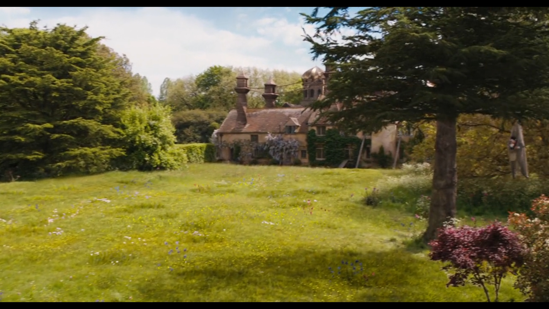

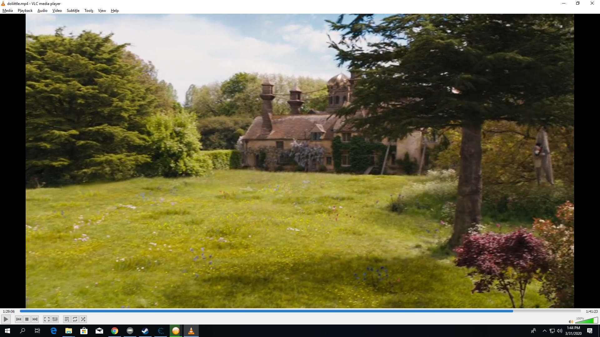

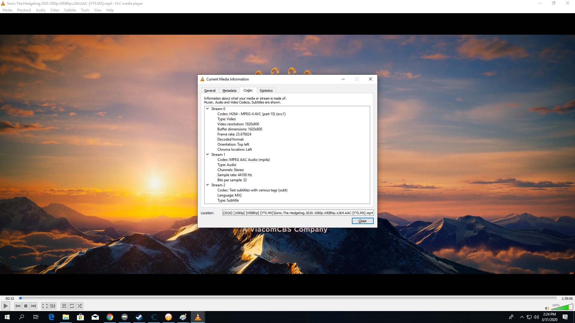

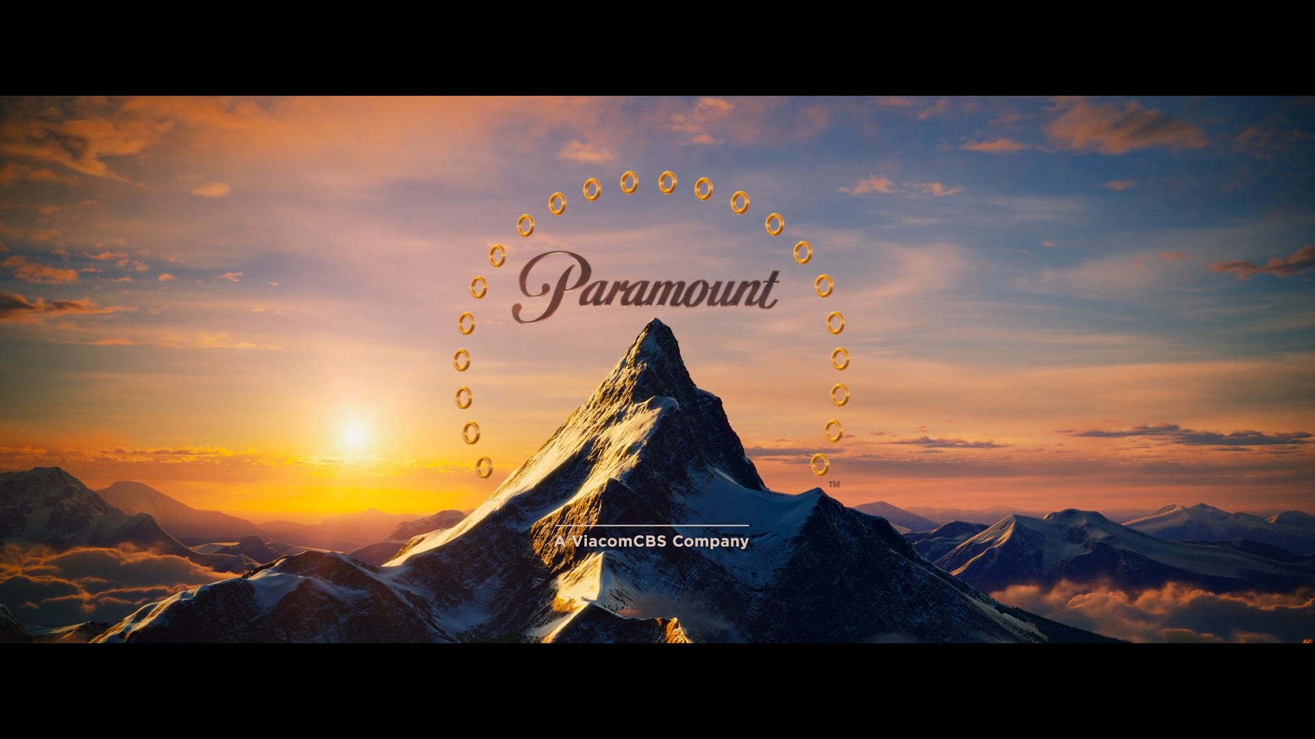

see this video:-
[Attachment 52556 - Click to enlarge]
it is 1920x800. when i did full screen i got this:-
[Attachment 52557 - Click to enlarge]
it's also letterbox. why?

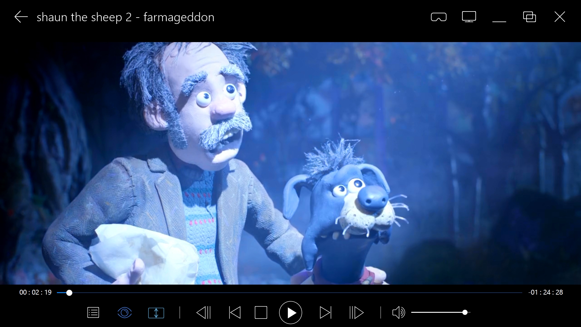

also i have cyberlink powerdvd 18. i played video B in it. there is an expand button:-
[Attachment 52558 - Click to enlarge]
when i pressed it i got this:-
[Attachment 52559 - Click to enlarge]
it made completely full screen without warping. can i have the same effect in vlc media player? -
The first video is full HD so that would require 1080 pixels against the 800 you have. So, again, you get the letter-boxing.
The second video has been zoomed to fill the screen and retain the aspect ratio. So if you are happy to lose detail especially left and right of the frame then that is the way to go. But if you want to see all the picture you have to accept the letter-boxing. Same as when you watch a film on the tv expecially wide-sceen 2.35:1 or 2.40:1 you will see the bars unless the tv company has pan/scanned it and, again, you lose information.
Can vlc to this ? Not sure. It does have a crop feature from within playback but, again, you risk losing information. -

Your screen has, probably, a dimension of 1920 * 1080 pixels (width * height). Any video height less than 1080 pixels and the player add these black bars to keep the aspect ratio or as you put it they way the video was encoded. Look at the screens you posted and you see the dimensions of each video. Not a single one of those is 1920 * 1080.
Your last video had 800 pixels. 1080 - 800 = 280. Or bars of 140 pixels top and 140 pixels bottom.
Even if the screen is not 1920 * 1080 it will be 16:9. Not one of the videos is true 16:9 >> check them in a calculator >> 1920 * 800 = 2.40:1 (one of the examples I stated above) -
