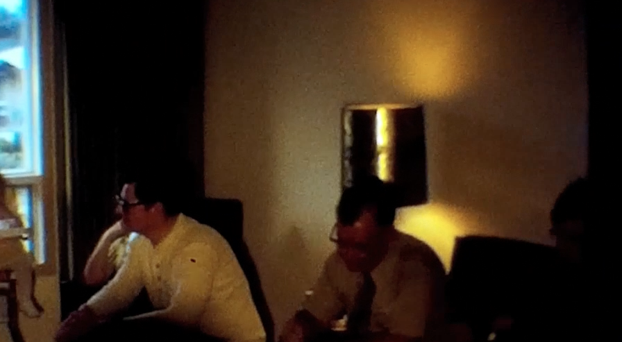

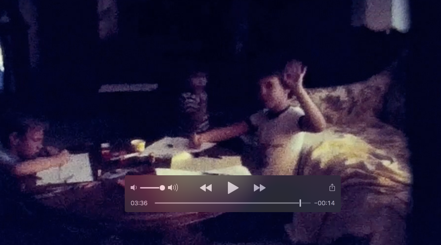

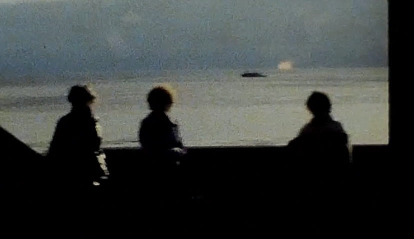

  6. Hello again, After more failed attempts with various programs I'm giving up on this for the time being. Too complex for me lol. Can anyone recommend someone, or an online service who can help me clean up these movies? Here are some examples of the 8mm family footage that I transferred with a Wolverine Moviemaker. The outdoor results are ok but some indoor footage is really grainy. I would prefer to not re-do them on a different machine. Thanks Image
    [Attachment 52750 - Click to enlarge]
    [Attachment 52751 - Click to enlarge]
    [Attachment 52752 - Click to enlarge]

  8. I agree that a video sample would help. The still shots look like pretty standard low light noise and you should be able to make significant improvements.

  10. I see quite a few issues with those samples which may not be related to your transfer.
    1. They appear to have MASSIVE compression artifacts. Are these two samples exactly what you transferred, or did you cut and then re-render to MP4? For instance, the attached frame shows nothing but compression artifacts. Whatever film grain might be there is swamped by the JPEG artifacts. Those artifacts are there because you did the wrong thing when saving the file. You need to change what you are doing and fix that because it makes no sense to try to fix a problem that you created, and which can be avoided.
    2. The clip of the kids waving indoors in front of the couch probably does have some grain issues, but like the other clip, you need to solve the compression artifact problem first.
    3. Both clips have massive color problems. As you watched during the transfer, was the film really this yellow? I have seen blue, red, and yellow film which results when one or more color layers fade, but one does not. However, your clips don't quite look like that, and instead they look like something was wrong in the capture setup.
    The good news is that the captures appear to be frame-accurate (one frame of film for each frame of video); the highlights are not blown out very much (could be a little better, but it's good enough); and you have timed them to play back at what looks like approximately the correct speed (most 8mm and 16mm silent film plays at 16 fps and all Super 8 plays at 18 fps).
    So, tell us more about whether those two samples were simply cut from the original transfer or, if not, how you created those two clips. Hopefully your original transfer does not have those compression artifacts. If we can get pristine samples, then we can figure out how to make them look really good.
