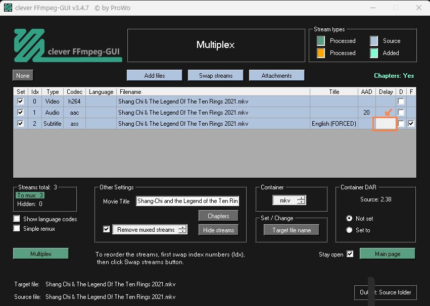

  7. How do I add a delay to an ass sub in an mkv container?
    Clever isn't taking any input in the sub delay field !!
    [Attachment 89490 - Click to enlarge]
  8. Originally Posted by videoAI View Post
    I have never tried to delay a subtitle stream. I need to test whether that is possible.

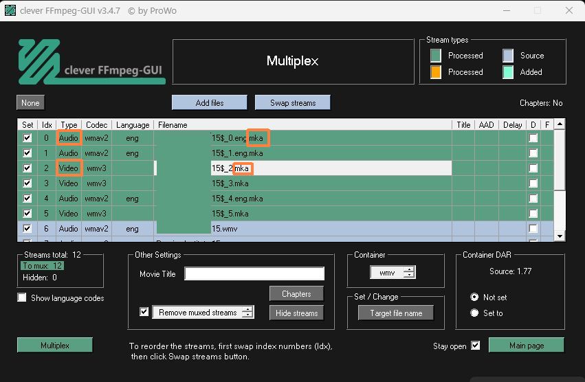

  16. @ProWo
    v3.4.7.01
    Another minor change ..

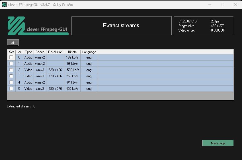

    The new extract streams function
    extracts audio streams into mka containers and
    extracts video streams into mka containers also.
    shouldn't those be extracted to mkv instead?
    as you can see it becomes a bit difficult to tell them
    apart in the grid, or at the file system.
    [Attachment 89501 - Click to enlarge]
    [Attachment 89502 - Click to enlarge]
    [Attachment 89503 - Click to enlarge]
  17. Originally Posted by videoAI View Post
    Yes, of course.
    EDIT: Found the bug. Is fixed in the next nightly.

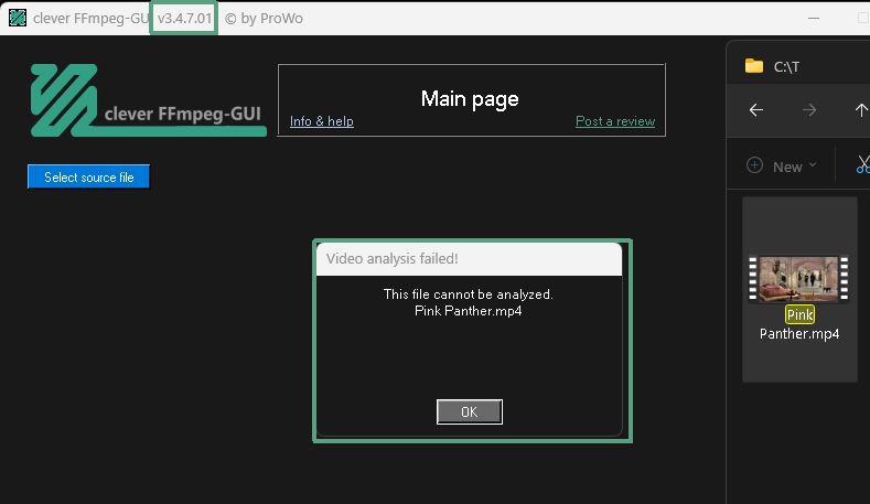

    ** Are you up for a challenge? !! **
    I came across an mp4 movie that will not open in Clever ..
    even though, as you can see, windows explorer loves the file and even generates a thumbnail for it.

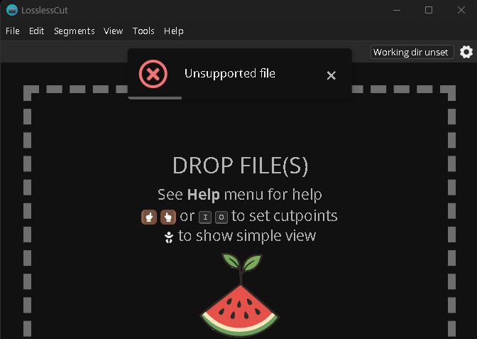

    The movie does not open in losslesscut as well ..
    [Attachment 89509 - Click to enlarge]

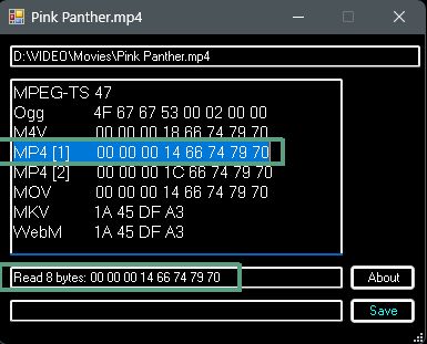

    A while back I had a different issue with few videos in my collections
    where the media hex signature was tampered with .. I ended up writing
    a new program to detect media signature [1st 8-16 bytes] to detect
    tampering. I call it Byte Editor.
    I tested this movie with my Byte Editor, and it looks good.
    [Attachment 89512 - Click to enlarge]

    Potential bug .. with ffmpeg ??
    ffprobe version N-121583-g4348bde2d2-20251031
    ffprobe -v quiet -print_format json -show_format -show_streams "D:\VIDEO\Movies\Pink Panther.mp4"
    generates no JSON file
    ffprobe -show_format -show_streams -show_chapters "D:\VIDEO\Movies\Pink Panther.mp4"
    generates this error:
    [aac @ 000001d7d4f70b00] Sample rate index in program config element does not match the sample rate index configured by the container.
    [aac @ 000001d7d4f70b00] decode_pce: Input buffer exhausted before END element found
    [mov,mp4,m4a,3gp,3g2,mj2 @ 000001d7d4efdf40] Failed to open codec in avformat_find_stream_info
    [mov,mp4,m4a,3gp,3g2,mj2 @ 000001d7d4efdf40] Could not find codec parameters for stream 1 (Audio: aac (mp4a / 0x6134706D), 24000 Hz, 0 channels, fltp, 94 kb/s): unspecified number of channels
    Consider increasing the value for the 'analyzeduration' (0) and 'probesize' (5000000) options
    Input #0, mov,mp4,m4a,3gp,3g2,mj2, from 'D:\VIDEO\Movies\Pink Panther.mp4':
    Metadata:
    major_brand : isom
    minor_version : 1
    compatible_brands: isom
    creation_time : 2005-12-22T13:20:35.000000Z
    Duration: 01:50:23.57, start: 0.000000, bitrate: 886 kb/s
    Chapters:
    Chapter #0:0: start 0.000000, end 285.600000
    Metadata:
    title : Chapter 1
    Chapter #0:1: start 285.600000, end 389.120000
    Metadata:
    Metadata:
    title : Chapter 32
    Stream #0:0[0x1](und): Video: h264 (High) (avc1 / 0x31637661), yuv420p(progressive), 608x256, 789 kb/s, 25 fps, 25 tbr, 25 tbn, start 0.080000 (default)
    Metadata:
    handler_name : GPAC ISO Video Handler
    vendor_id : [0][0][0][0]
    Stream #0:1[0x2](eng): Audio: aac (mp4a / 0x6134706D), 24000 Hz, 0 channels, fltp, 94 kb/s (default)
    Metadata:
    creation_time : 2005-12-22T13:22:00.000000Z
    handler_name : GPAC ISO Audio Handler
    Stream #0:2[0x3](swe): Subtitle: mov_text (tx3g / 0x67337874), 0 kb/s (default)
    Metadata:
    creation_time : 2005-12-22T13:22:21.000000Z
    handler_name : GPAC Streaming Text Handler
    [aac @ 000001d7d4f887c0] Sample rate index in program config element does not match the sample rate index configured by the container.
    [aac @ 000001d7d4f887c0] decode_pce: Input buffer exhausted before END element found
    Could not open codec for input stream 1
    So error was :
    and potential remedy was :
    Increasing 'analyzeduration' and 'probesize' :
    ffprobe -analyzeduration 100000000 -probesize 100000000 -show_format -show_streams -show_chapters "D:\VIDEO\Movies\Pink Panther.mp4"
    still generated errors ...
    [aac @ 00000248a08d1ac0] Sample rate index in program config element does not match the sample rate index configured by the container.
    [aac @ 00000248a08d1ac0] decode_pce: Input buffer exhausted before END element found
    [mov,mp4,m4a,3gp,3g2,mj2 @ 00000248a08cdc00] Failed to open codec in avformat_find_stream_info
    [mov,mp4,m4a,3gp,3g2,mj2 @ 00000248a08cdc00] Could not find codec parameters for stream 1 (Audio: aac (mp4a / 0x6134706D), 24000 Hz, 0 channels, fltp, 94 kb/s): unspecified number of channels
    Consider increasing the value for the 'analyzeduration' (100000000) and 'probesize' (100000000) options
    Metadata:
    major_brand : isom
    minor_version : 1
    Chapters:
    Metadata:
    title : Chapter 1
    title : Chapter 32
    Metadata:
    Metadata:
    Metadata:
    [aac @ 00000248a0916c00] Sample rate index in program config element does not match the sample rate index configured by the container.
    [aac @ 00000248a0916c00] decode_pce: Input buffer exhausted before END element found
    Summary: FFmpeg can't inspect or open stream 1 [AAC Audio stream] in the file
    and keeps asking me to increase 'input buffer,' analyze duration', and 'probe size'.
  28. Could you upload this video to a hoster and post the download link here?
  29. No need, I figured out the issue.
    ffmpeg chokes on this movie file because the audio has 0 channels.
    I extracted the video and the audio streams separately, clever can load the video
    but not the audio stream.
    no ffmpeg front end can read the audio stream with 0 channels, even
    though players can play the movie [both streams] fine. I tried many programs
    and even online converters, they all give errors trying to read, mux, or convert
    the audio stream.
    I have yet to find a program that can mux or convert 0 channel audio
    stream. Will update when I do.
