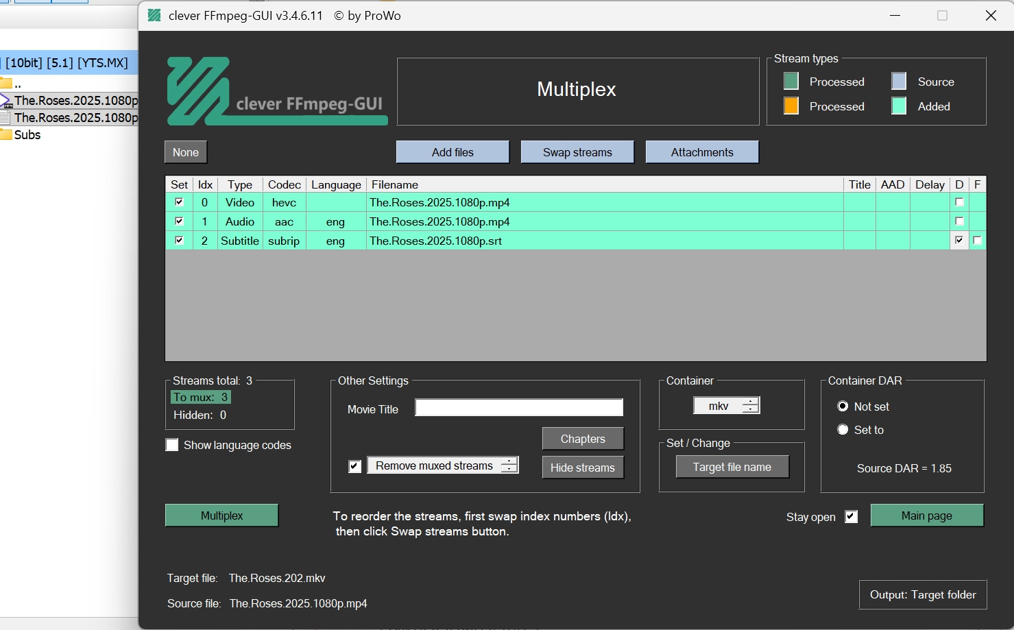

  6. @ ProWo
    The tooltip of the button First/None/All on the mux page still show "Select / deselect all streams".
    Could the tooltip be expanded to "Select / deselect all streams. Or select all streams that contain the name of the first stream."
    Could the tooltip of Delay expand to: "Set delay in milliseconds. Negative values ​​reduce delay."
    Beginners may not know how to fix a delay.
    You show the Bitrate range in Audio encoding. But the formatting varies, with and without spaces around the separator. Can you please standardize this?

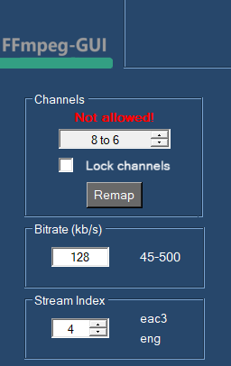

  10. @ ProWo
    How about adding a "Lock channels" option on the Audio page?
    This setting should be saved. It would prevent the bitrate entered by the user from being changed if other files with different channels are loaded.
    This would allow you to use the same audio setting (encoder, channels, bitrate, frequency) all the time.
    [Attachment 89222 - Click to enlarge]
  11. Originally Posted by Findu View Post
    That's not a good idea; different numbers of channels require different bit rates, i.e., more channels, more bit rate.
    Thx, will be changed.
    Not correct: the inserted values are the final result values, that means if you insert 10 ms, then this stream is delayed 10 ms in the muxed video.
    Negative delays on audiostreams postpone the videostream start.
    Will be done.
  13. >> Lock audio channels
    Yes, of course.
    The use case is that some people always use the same audio settings, regardless of how many channels or what quality the source has. For example, aac, 128 bits, 2 channels and 44100 Hz.
    I was looking for a way to retain all four user settings.

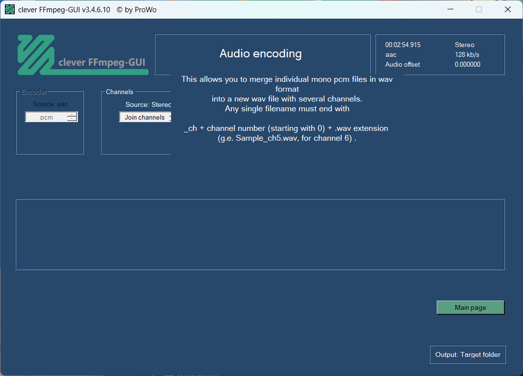

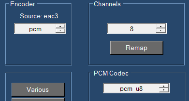

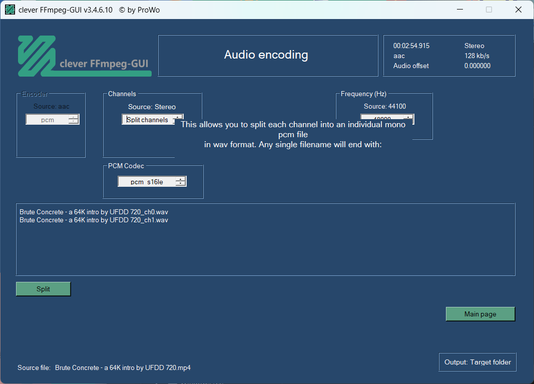

  20. @ ProWo
    v3.4.6.010 feedback
    The Search cut points problem with ffplay and files with offset has been fixed. Thanks.
    I am now able to add delay -/+ to mp4 files with offset. Great.
    And thanks for adding the new clean look to the Audio encoding pages.
    The whole source channel info get loste when you click OK in the D-Mix options window.
    Found two text glitches.
    [Attachment 89299 - Click to enlarge]
    [Attachment 89300 - Click to enlarge]
    Can you move the text in the Encoder and PCM Codec drop-down menus up a little? Some characters, such as “p,” are cut off at the bottom. I use 125% display scaling.
    [Attachment 89301 - Click to enlarge]
    The drop down box of Duration for Fade out is two pixels wider than the other three.
    How about the frame text “Channels (change, split, join)”. Because you don't necessarily expect split/join when you change the channels number.
  21. Originally Posted by Findu View Post
    Thx, bug, will be fixed.
    I calculated the position for 100% scaling. I will change that.
    Unfortunately, that is not possible; the vertical text position cannot be changed in the domainupdown control. I could reduce the font size, but I do not want to do that.
    Will be fixed.
    Good idea, will be done.
    EDIT: Done.

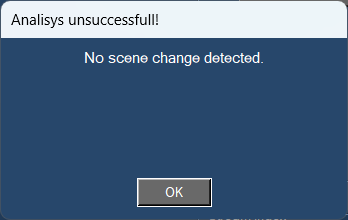

  23. v3.4.6.011 feedback for Chapters
    Chanpers "Start time" default is now one minute instead of zero?
    Oh, I see. It's a counter that counts up by one minute.
    "At fixed intervals" is working well.
    "At scene changes" does not work for me.
    It doesn't matter whether they are clips, series, movies, mp4, or mkv files.
    After processing I often get:
    [Attachment 89310 - Click to enlarge]

  24. @Findu
    It do works but for short video lenght (20 min) as the command is 32bit integer code. For bigger length videos it has to be modified to 64bit integer code.
    Try for short video [Sample Video]
  25. Originally Posted by Findu View Post
    Yes, the first chapter at 0 is created automatically.
    Doesn't work for short videos. Retry with a 90 min movie.
  26. It works for 10 to 15 min short video. For a video to be for 60 min, 90 min, 2 hrs it doesn't. Fixed ones working fine. Can try a third option ... based on video lenght detection [ cut at fixed intervals..5,8,10,5,10,8,5,10 min...and so on] TXT below...

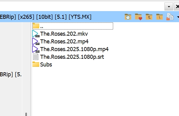

  28. v3.4.6.11
    Name of output file is truncated after muxing.
    The Roses.2025.1080P.mkv becomes The Roses.202.mkv
    Before muxing
    [Attachment 89318 - Click to enlarge]
    After muxing
    [Attachment 89319 - Click to enlarge]
