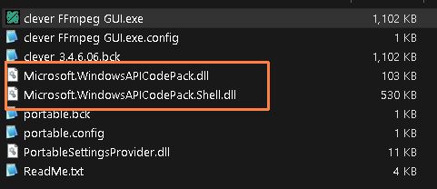

    - Task bar tab icon is not updated when clever is minimized,
    or in normal state.
    You need this 2 files in the clever folder:
    Microsoft.WindowsAPICodePack.dll
    Microsoft.WindowsAPICodePack.Shell.dll
    [Seriously !!, You're going to blame my environment .. again..
    *** What part of "There is nothing wrong .. with my environment" you don't get ?!! ***
    off course I have them in the folder]
    [Attachment 89125 - Click to enlarge]

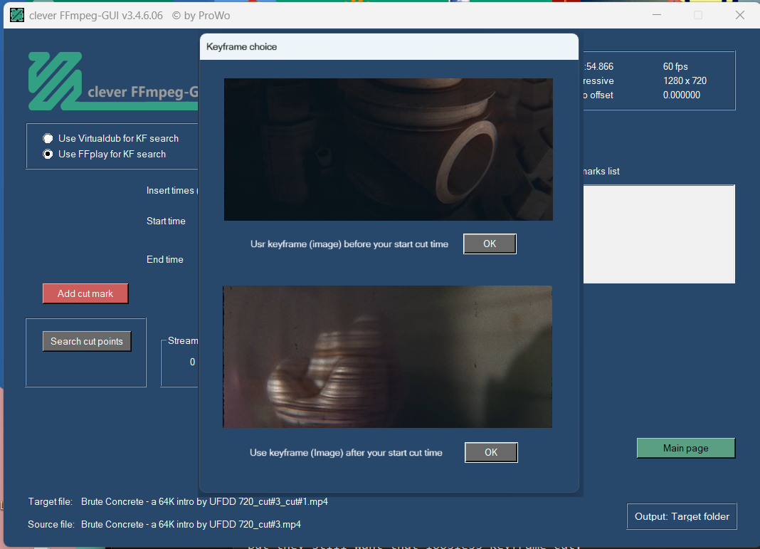

    Idea for a keyframe start cut selection.
    When you use ffplay for the KF search, you need to use the s key to jump to the next frame finding a keyframe or not. Because the left and right arrow keys often jump over i-frames.
    But most users look at the sceene for the cut and don't care if it is a i = k, b or p frame.
    But they still want that loosless keyframe cut.
    When a user enters the start and end values for the cut and click "Add cut mark", a pop-up window could display the thumbnail of the keyframe before and after the entered start value. So with your choosen scene in mind from ffplay, this makes it easier to make the selection for the actual KF start cut.
    [Attachment 89130 - Click to enlarge]
    EDIT:
    No selection is needed when the user start value is exactly a keyframe.
    By the way, the preview of the last added cut marks always behaves the same. It starts playback one keyframe before the actual start cut time or the selected keyframe. This is in this phase necessary for key accrate cut and overall consistent. From that perspective, it's okay.
    But for keyframe cut, it could start exactly at the keyframe in question.
    However, the preview always stops playback at the right time.

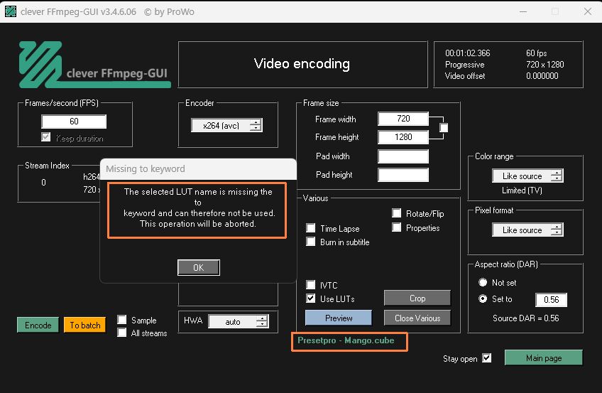

    Potential bug .. ** please don't shoot the messenger **
    I downloaded few free .Cube & .3dl files from https://presetpro.com
    They are [all] giving this error when trying to select them:
    [Attachment 89138 - Click to enlarge]
    #Website: © https://presetpro.com Tim Martin
    TITLE "Presetpro - Mango"
    #LUT size
    LUT_3D_SIZE 64
    #LUT data points
    0.027451 0.027451 0.035294
    To replicate the issue, try loading:
    - Presetpro - Mango.cube
    or
    - Presetpro - Landscape.3dl
    [Files attached]

  10. Originally Posted by videoAI View Post
    No issue, the message explains it.
    The "to" keyword is missing in the LUT name.
    This is used to select the correct color space.
    Simply rename the file to
    Presetpro - Mango_to_.cube

  12. Care to expand on that ..
    1- How does just adding '_to_' help you select the correct color space?
    2- Shouldn't that info be included in the LUT file?
    3- How does other editing tools import the file as is, without renaming?
    4- What other keywords are you using for validation that we should
    include [or exclude] from the file name? for ex: are you using any of
    these words [SDR, HDR, LOG, etc]
    5- Do the keywords apply to all the other LUT formats [ex: DAT,M3D,CSP,XMP,DNG,AML]
    Your explanation would be appreciated ..
    Simply rename the file to 'Presetpro - Mango_to_.cube'
  13. Originally Posted by videoAI View Post
    Care to expand on that ...
    Wait for the next nightly.

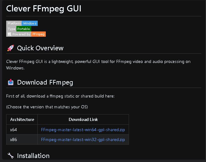

  14. @ProWo,
    As a token of my appreciation for all your hard work and dedication to this project,
    I took the liberty to transform the App plain readme.txt into a Readme.md file.
    If you are not familiar with the new popular standard for creating docs, including
    Readme files, please check this out:
    Mark Down Language
    This is how the attached MD doc looks like in an MD viewer or editor, and it can
    still be read by any plain text editor as well. cool ha ..
    [Attachment 89154 - Click to enlarge]
  15. Originally Posted by videoAI View Post
    Thanks for your efforts, it looks really good.
    The problem is that most users don't have a MD viewer/editor installed and therefore can't do anything with it.
    I'll add the file to the next release anyway.

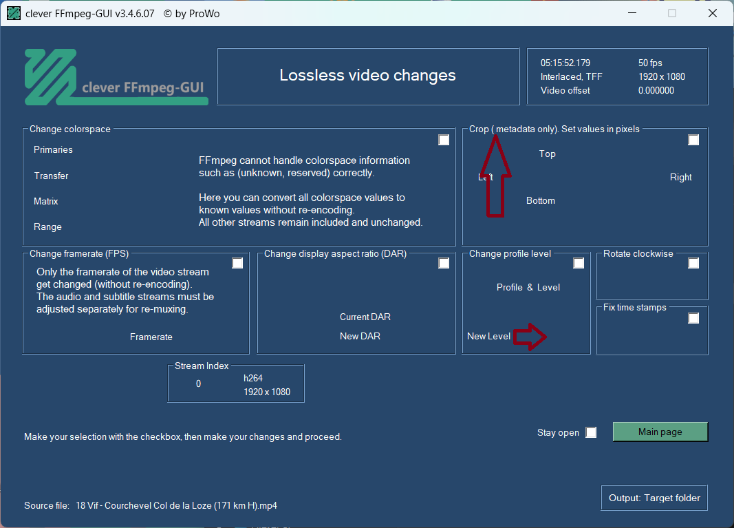

  24. @ ProWo
    Two small text things on the Lossless page.
    There is a space rihgt after the bracket.
    And could you move the text "New Level" a bit to the right.
    [Attachment 89188 - Click to enlarge]

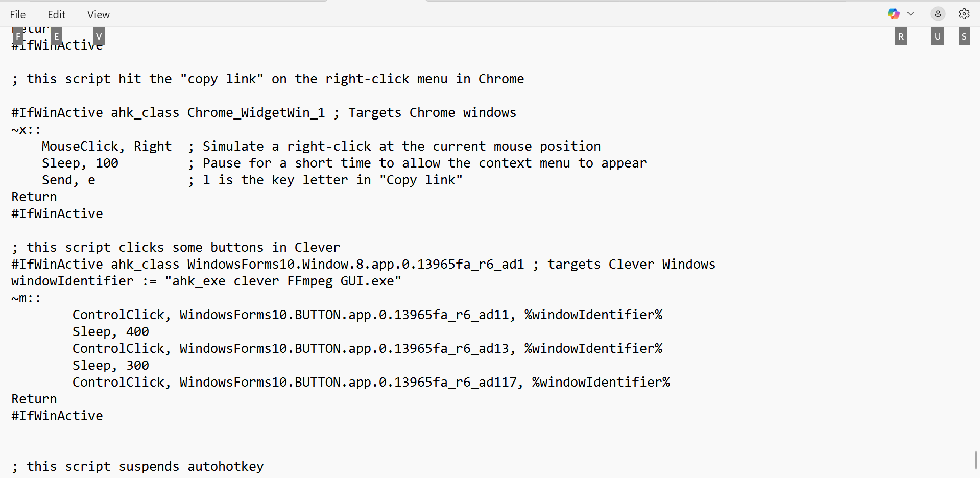

  25. I have a question unrelated to Clever, but don't know where else to ask.
    I use this hotkey control+alt+n to open Notepad. The same hotkey also minimizes and maximizes the Notepad active window. Sometimes Notepad would show the letters FEVRUS at the top of the screen. When this happens, the hotkey doesn't work anymore until I clear the letters by clicking the page. I don't understand what is happening. I would really appreciate any input. Thank you.
    [Attachment 89189 - Click to enlarge]

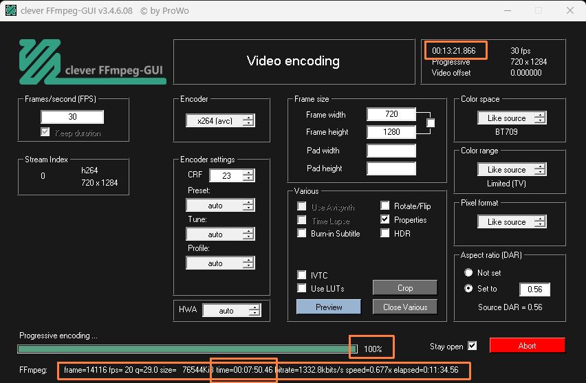

  27. @ProWo
    v3.4.6.08 feedback
    I'm trying to determine why the progress bar is still not working
    properly on some of my mp4 files .. here is more info on such a
    file, with13min 21s duration [V/A] ..
    General
    Complete name : C:\T\MP4\Test.mp4
    Format : MPEG-4
    Format profile : Base Media
    Codec ID : isom (isom/iso2/avc1/mp41)
    File size : 487 MiB
    Duration : 13 min 21 s
    Overall bit rate : 5 099 kb/s
    Frame rate : 30.000 FPS
    Movie name : Test
    Writing application : Lavf61.1.100
    Video
    Format : AVC
    Format profile : Main@L5.1
    Format settings : CABAC / 4 Ref Frames
    Format settings, CABAC : Yes
    Format settings, Reference fra : 4 frames
    Codec ID : avc1
    Bit rate mode : Variable
    Bit rate : 4 962 kb/s
    Maximum bit rate : 250 Mb/s
    Width : 720 pixels
    Height : 1 284 pixels
    Display aspect ratio : 0.561
    Frame rate mode : Constant
    Color space : YUV
    Chroma subsampling : 4:2:0
    Bit depth : 8 bits
    Scan type : Progressive
    Bits/(Pixel*Frame) : 0.179
    Stream size : 474 MiB (97%)
    Writing library : Lavc61.3.100 h264_nvenc
    Color range : Limited
    Color primaries : BT.709
    Transfer characteristics : BT.709
    Matrix coefficients : BT.709
    Codec configuration box : avcC
    Audio
    Format : AAC LC
    Format/Info : Advanced Audio Codec Low Complexity
    Codec ID : mp4a-40-2
    Source duration : 13 min 21 s
    Bit rate mode : Constant
    Bit rate : 129 kb/s
    Channel(s) : 2 channels
    Channel layout : L R
    Sampling rate : 44.1 kHz
    Frame rate : 43.066 FPS (1024 SPF)
    Compression mode : Lossy
    Stream size : 12.4 MiB (3%)
    Source stream size : 12.4 MiB (3%)
    Default : Yes
    Alternate group : 1
    If the progress bar values are calculated as Video time/duration*100
    Shouldn't the progress match the values in this case ..
    (check the image of my file below and compare it to the image you supplied in your reply)
    [Attachment 89201 - Click to enlarge]
    Q: How are you calculating progress values for the progress bar?
    [Attachment 89122 - Click to enlarge]
  28. Originally Posted by videoAI View Post
    Could you upload this video and post the link here so I can check it out?
  29. Originally Posted by davidt1 View Post
    It looks as if these exact keys have already been defined as hotkeys.
  30. @ ProWo
    On the main page, I can edit and delete the list of streams. However, this has no effect.
    The same applies to Cut. But when I delete the list and click on Cut, problems arise. It takes forever and has to be canceled. The app then becomes unstable. Files such as 000_fasc_step3.mkv may remain in the output folder.
    With chapters, I can only mark them and not change anything. So no problem there.
