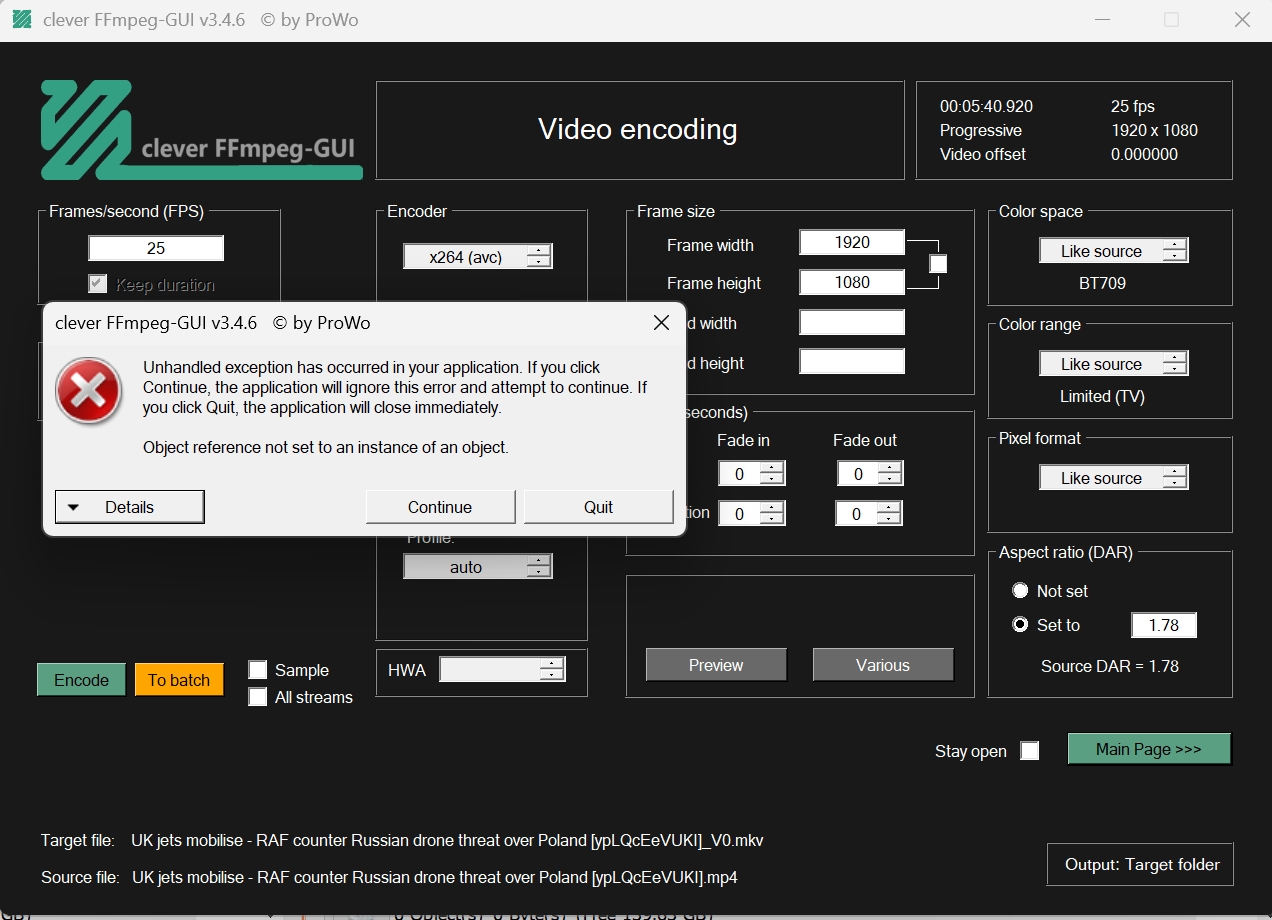

  1. There is an error message when I back out of the encode page by clicking on the main page.
    [Attachment 88878 - Click to enlarge]
  2. Set HWA to none.
  3. Originally Posted by ProWo View Post
    Set HWA to none.
    That works. Thanks.

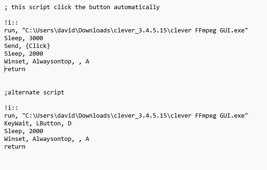

    I only use the drag and drop method for opening files. Why? because dragging and dropping is so much faster. With the "open file" method you can only select one file at a time. The trade off is you have to keep Clever stay on top. That is not a problem, as there are free stay-on-top apps you can download to do the job.
    One of the best is AutoHotkey. Here are two simple scripts for opening Clever and keep the selected page stay on top. Please suggest better alternatives. Thanks.
    [Attachment 88882 - Click to enlarge]

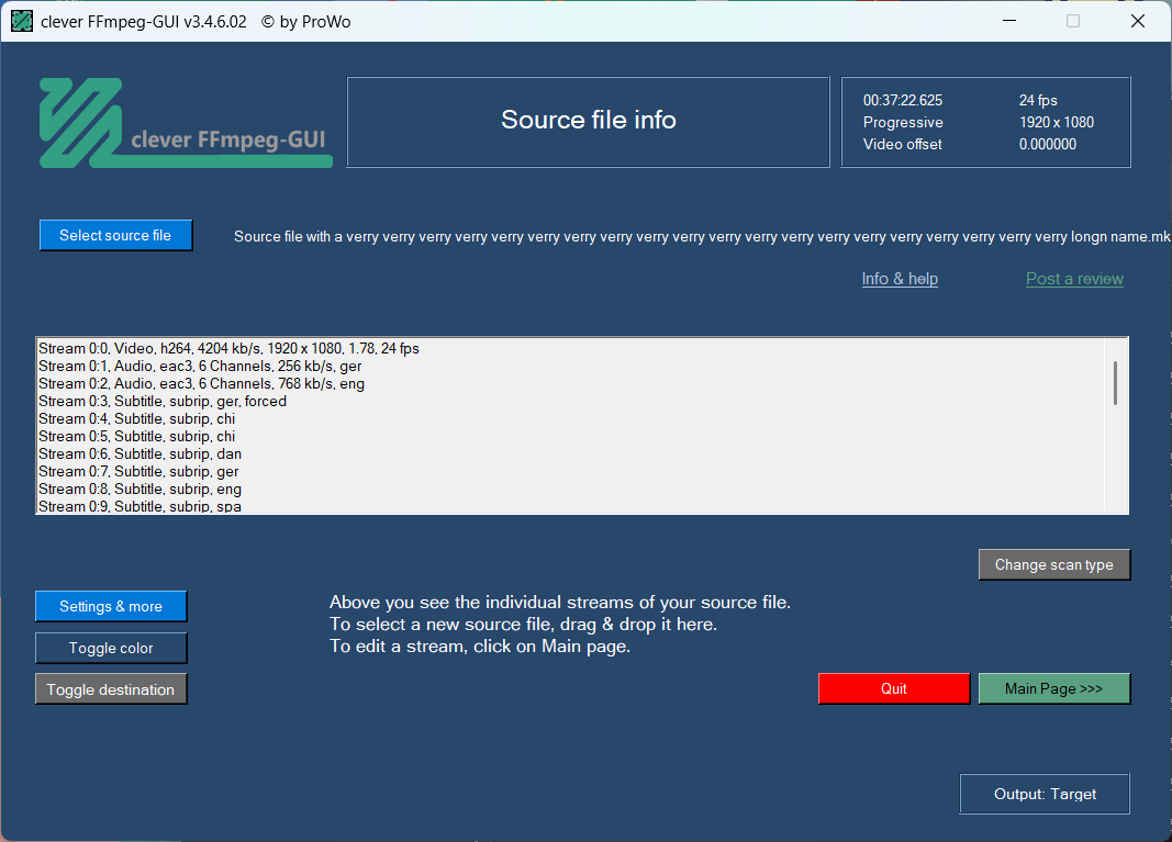

  4. Originally Posted by davidt1 View Post
    I think Clever would be even easier to use if it opens on the main page. The main page has all the options whereas the currently opened page only has two: join and multiplex.
    No big deal. Just a thought.
    That doesn't make sense.
    The normal way to edit a video file is to load it.
    This will display the streams with all the associated information.
    There is no space for this in the main window.
    Loading multiple files only makes sense with multiplex, join and batch.
    No, you can also load multiple files using the button; you just have to select them first.
    Like all programs, clever FFmepg-GUI should not remain permanently on top, as this would prevent other programs from being used at the same time.
    It is programmed so that it returns to the top after encoding, for example.

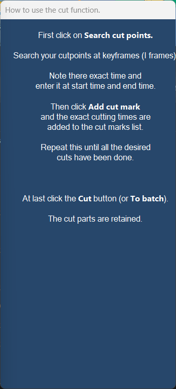

  9. @ ProWo
    v3.4.6.01 Feedback
    Still no DGV issue! Very good!

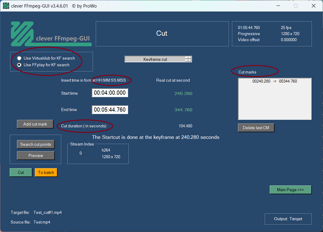

    How about four smaller text changes on the cut page.
    - Replacing "KF" with "frame" as you use the search also for b and p frames in "Frame accurate cut", and not only for i frames?
    - The time format is usually lowercase. ISO 8601 uses (hh:mms.f).
    - The units for "Cut duration" could simply be "(seconds)".
    - And "Cut marks" might be named "Cut marks list". Also on the "How to" page. But that's a matter of taste!
    [Attachment 88901 - Click to enlarge]

  13. Originally Posted by Findu View Post
    The task is to search for KF.
    It goes without saying that you can use frame accurate cut to select any start frame.
    can be changed to
    hh.mm.ss.ms
    With only seconds, it is not clear that this refers to the cutting time.
    Will be done.
  14. >> The units for "Cut duration" could simply be "(seconds)".
    Okay. Can you remove the space bevore in "( in seconds)"?
    EDIT 1: Only when you say yes to "Should the output be HDR10?"
    If you deselect "Use LUT's", the Encoder, Color space and Pxel format are still locked and cannot be changed!
    When I use PQ_to_HLG.cube, the Color space section disappears and is not restored when I disable "Use LUTs".
    EDIT 2: The Color space section disappears and is not restored. It seems to happen not always.

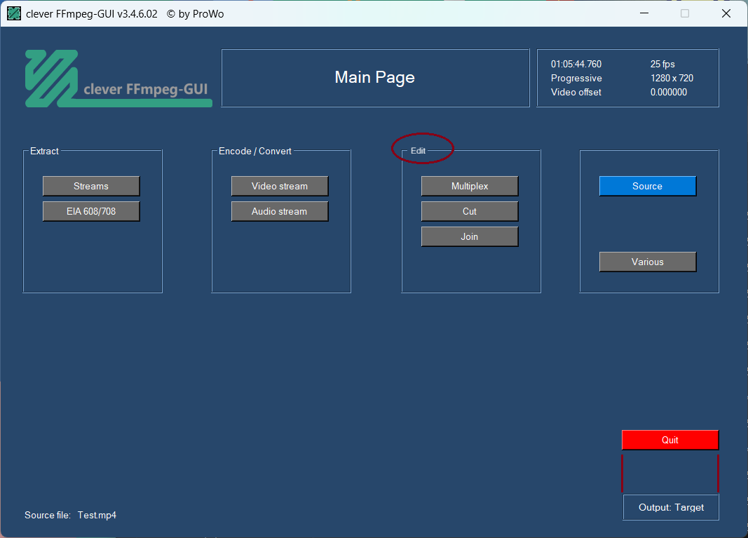

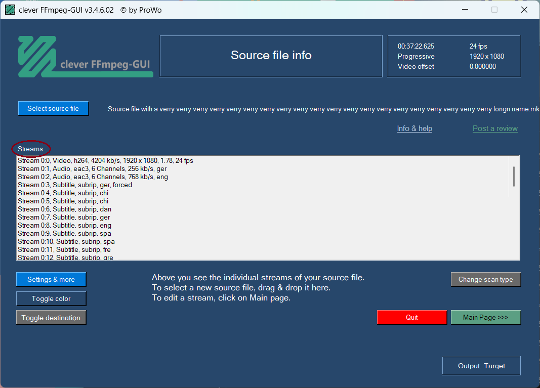

  21. @ ProWo
    v3.4.6.02 Feedback
    Your LUT's deselect fix is working! Thank you.
    I just noticed that Color range does not get reset to Like source, like Color space and Pixel format does when you deselect Use LUT's. The same happens when you deselect HDR.
    How about the Cut page text "Insert time format (in hh:mms:ms)", similar to "Cut duration (in seconds)".
    Good idea from you that the preview settings window in video encoding only appear once as long as you stay in this section.
  22. Originally Posted by Findu View Post
    The color range selection doesn't change with LUT's or HDR.
    If you change the value, it will remain that way until you change it again.

  28. @ ProWo
    Original
    [Attachment 88923 - Click to enlarge]
    Suggestion
    [Attachment 88924 - Click to enlarge]
    The "Streams" text in the red circle only appears when you return from the main page!
    How about expanding the white box further down to show more streams?
  29. A smaller text addition for the main page.
    [Attachment 88925 - Click to enlarge]
    I know you like the size of the "Output" frame as it is.
    But if it's as wide as the buttons above, it will look more coherent.
  30. Originally Posted by Findu View Post
    Will be fixed.
    Good idea, will be done.
