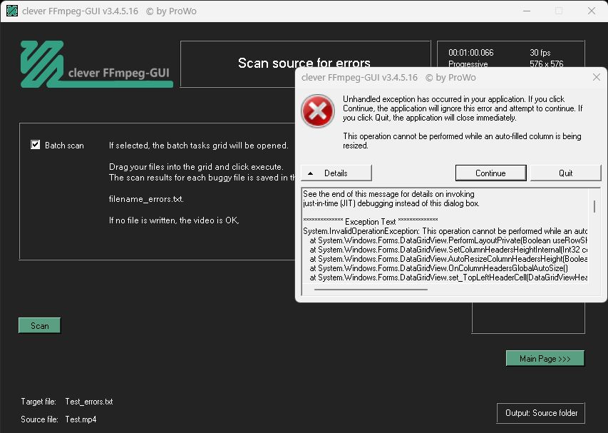

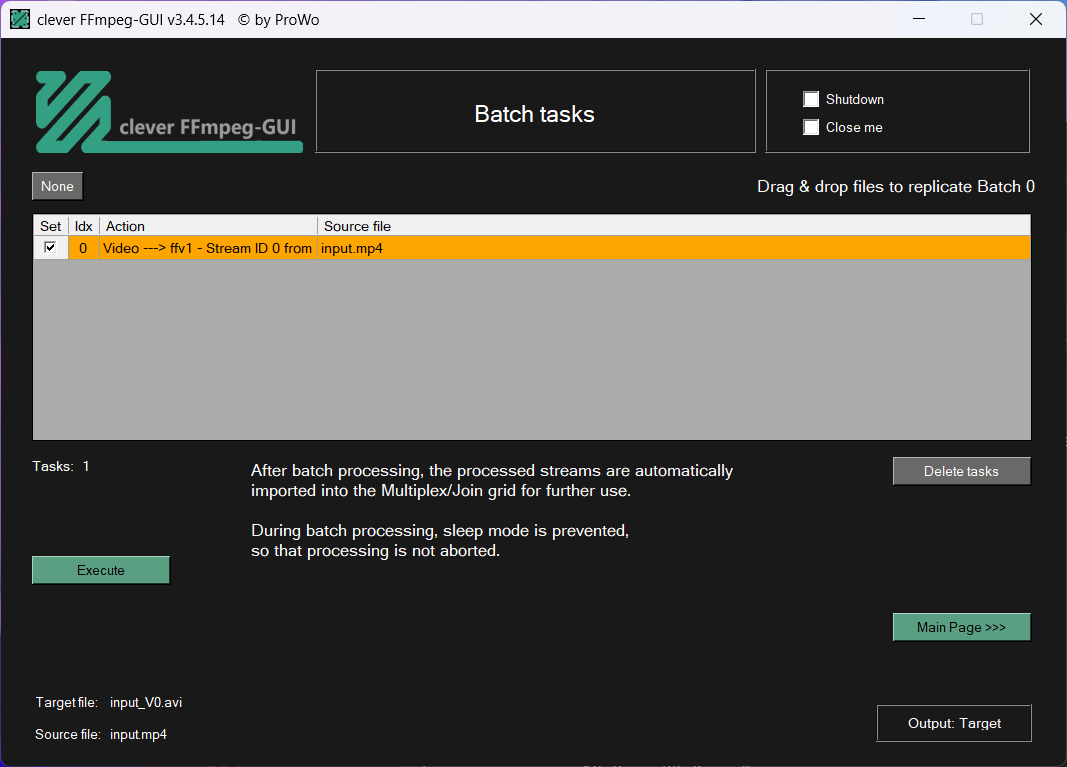

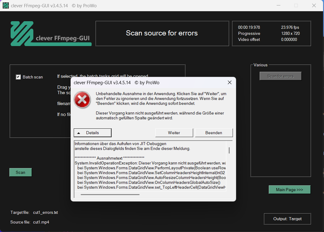

  2. @ ProWo
    v3.4.5.14 Feedback
    DataGridView error message:
    System.InvalidOperationException: Dieser Vorgang kann nicht ausgeführt werden, während die Größe einer automatisch gefüllten Spalte geändert wird.
    Sequence: 0pen a source file, create one video encoding batch task, go to main page, open batch tasks and go back to main page, various, scan for errors, click on batch scan, error!
    Delete the batch task and repeat the sequence.
    I can often reproduce this when I do that sequence quickly, but not always!
    I happens not so often when you skip "open batch tasks and go back to main page" in that sequence.
    It looks like the automatic column width adjustment has a timing issue when opening a filled grid page.
    [Attachment 88698 - Click to enlarge]
    [Attachment 88699 - Click to enlarge]
    [Attachment 88700 - Click to enlarge]
    BTW: Switching from ffmpeg 7.1.1 to 8.0 increases the encoding speed by about 2.5%. The same applies after updating the Intel ACR drivers.

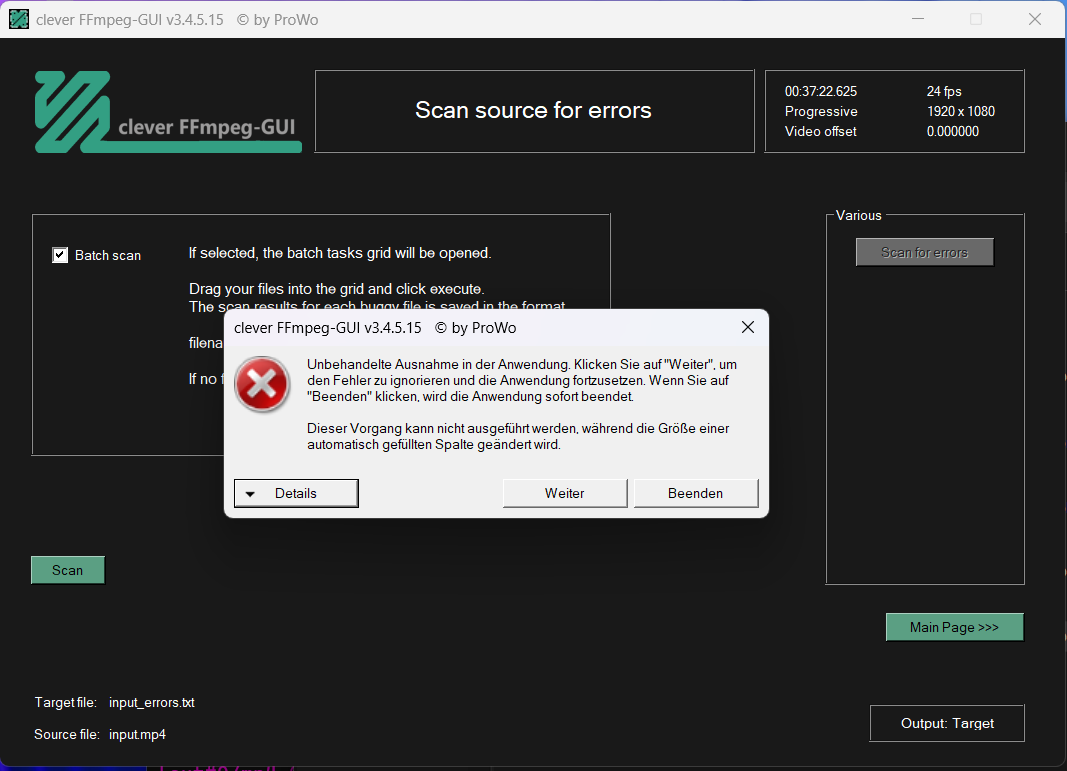

  3. Originally Posted by Findu View Post
    @ ProWo
    v3.4.5.14 Feedback
    Update to .15 and retry.
  4. Same problem at the first try with 15
    [Attachment 88703 - Click to enlarge]
  5. Originally Posted by Findu View Post
    Just tested, doesn't happen here with me.
    Could you click on detail with the error message and post the pic?

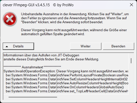

  6. Image
    [Attachment 88708 - Click to enlarge]
    Informationen über das Aufrufen von JIT-Debuggen
    anstelle dieses Dialogfelds finden Sie am Ende dieser Meldung.
    ************** Ausnahmetext **************
    bei System.Windows.Forms.DataGridView.PerformLayoutPri vate(Boolean useRowShortcut, Boolean computeVisibleRows, Boolean invalidInAdjustFillingColumns, Boolean repositionEditingControl)
    bei System.Windows.Forms.DataGridView.SetColumnHeaders HeightInternal(Int32 columnHeadersHeight, Boolean invalidInAdjustFillingColumns)
    bei System.Windows.Forms.DataGridView.AutoResizeColumn HeadersHeight(Boolean fixedRowHeadersWidth, Boolean fixedColumnsWidth)
    bei System.Windows.Forms.DataGridView.OnColumnHeadersG lobalAutoSize()
    bei System.Windows.Forms.DataGridView.set_TopLeftHeade rCell(DataGridViewHeaderCell value)
    bei System.Windows.Forms.DataGridView.get_TopLeftHeade rCell()
    bei System.Windows.Forms.DataGridView.OnCellMouseEnter (DataGridViewCellEventArgs e)
    bei System.Windows.Forms.DataGridView.UpdateMouseEnter edCell(HitTestInfo hti, MouseEventArgs e)
    bei System.Windows.Forms.DataGridView.OnColumnWidthCha nged(DataGridViewColumnEventArgs e)
    bei System.Windows.Forms.DataGridView.AdjustFillingCol umns()
    bei System.Windows.Forms.DataGridView.ComputeLayout()
    bei System.Windows.Forms.DataGridView.OnHandleCreated( EventArgs e)
    bei System.Windows.Forms.Control.WmCreate(Message& m)
    bei System.Windows.Forms.Control.WndProc(Message& m)
    bei System.Windows.Forms.NativeWindow.Callback(IntPtr hWnd, Int32 msg, IntPtr wparam, IntPtr lparam)
    ************** Geladene Assemblys **************
    mscorlib
    Assembly-Version: 4.0.0.0.
    Win32-Version: 4.8.9310.0 built by: NET481REL1LAST_C.
    CodeBase: file:///C:/Windows/Microsoft.NET/Framework64/v4.0.30319/mscorlib.dll.
    clever FFmpeg GUI
    Assembly-Version: 1.0.0.0.
    Win32-Version: 3.4.5.15.
    CodeBase: file:///C:/Users/Findu/Downloads/Software/mp4/tools/clever_ffmpeg_gui/clever%20FFmpeg%20GUI.exe.

  7. Originally Posted by Findu View Post
    DGV issue with batch task grid
    Hi Findu, you have PM.
  8. v3.4.5.16 Feedback
    Still getting the error:
    But I can not reproduce that DataGridView error on the AMD system!!!

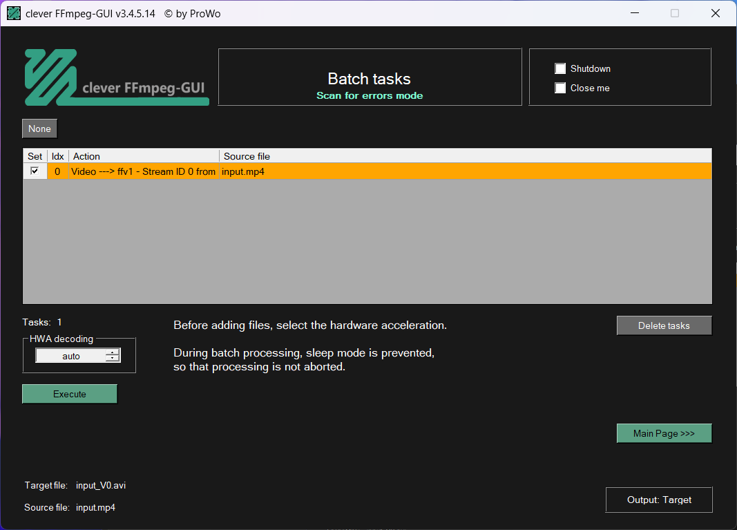

    Quick test of the new HWA decoding for all video encoders.
    I can see that the GPU decoder is doing the work.
    Core Ultra 7 using avc preset veryfast has 0 % and ultrafast 30 % slowing down.
    Same for other encoders.
    Only _qsv encoders benefit from HWA decoding. The best choice there is also qsv decoding.
    Same on the Ryzen 5 system where AMF is the best choice.

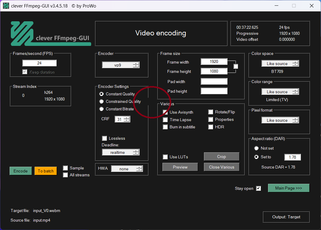

  10. @ ProWo
    Video encoding, Various, HDR reselection not working:
    If the source file is HDR10 or HLG, you can reselect HRD as often you want.
    With SDR source files, and when you select Video encoding, Various, HDR, SDR to HLG or HDR10 and then hevc or av1 and unselect and reselect HDR, you don't get the further options window. You need to close the page and reopen Video encoding to be able to reselect HDR and see the further options window.
  11. Originally Posted by Findu View Post
    Video encoding, Various, HDR reselection not working for SDR videos
    Should be fixed, maybe the DGV issue too.
    Download the last nightly and update manually to the new .16

  14. @ProWo
    v3.4.5.16
    v.16 ... I can reproduce this bug/crash, easily, by following Findu's steps on
    my AMD system.
    I have been pointing out these navigation-type issues/bugs/crashes for a while
    now only to be told "its my system, my environment, that is at fault" which clearly
    isn't the case ..
    Previous Post .. Early Aug ..
    Thank you @Findu for pointing out these types of intermittent issues/bugs/crashes.
    much appreciated.
    BTW, these crashes occur on all screens with grids in them ..
    ************** Exception Text **************
    System.InvalidOperationException: This operation cannot be performed while an auto-filled column is being resized.
    at System.Windows.Forms.DataGridView.PerformLayoutPri vate(Boolean useRowShortcut, Boolean computeVisibleRows, Boolean invalidInAdjustFillingColumns, Boolean repositionEditingControl)
    at System.Windows.Forms.DataGridView.SetColumnHeaders HeightInternal(Int32 columnHeadersHeight, Boolean invalidInAdjustFillingColumns)
    at System.Windows.Forms.DataGridView.AutoResizeColumn HeadersHeight(Boolean fixedRowHeadersWidth, Boolean fixedColumnsWidth)
    at System.Windows.Forms.DataGridView.OnColumnHeadersG lobalAutoSize()
    at System.Windows.Forms.DataGridView.set_TopLeftHeade rCell(DataGridViewHeaderCell value)
    at System.Windows.Forms.DataGridView.get_TopLeftHeade rCell()
    at System.Windows.Forms.DataGridView.OnCellMouseEnter (DataGridViewCellEventArgs e)
    at System.Windows.Forms.DataGridView.UpdateMouseEnter edCell(HitTestInfo hti, MouseEventArgs e)
    at System.Windows.Forms.DataGridView.OnColumnWidthCha nged(DataGridViewColumnEventArgs e)
    at System.Windows.Forms.DataGridView.AdjustFillingCol umns()
    at System.Windows.Forms.DataGridView.ComputeLayout()
    at System.Windows.Forms.DataGridView.OnHandleCreated( EventArgs e)
    at System.Windows.Forms.Control.WmCreate(Message& m)
    at System.Windows.Forms.Control.WndProc(Message& m)
    at System.Windows.Forms.NativeWindow.Callback(IntPtr hWnd, Int32 msg, IntPtr wparam, IntPtr lparam)
    ************** Loaded Assemblies **************
    [Attachment 88728 - Click to enlarge]
    @ ProWo
    v3.4.5.14 Feedback
    I can often reproduce this when I do that sequence quickly!

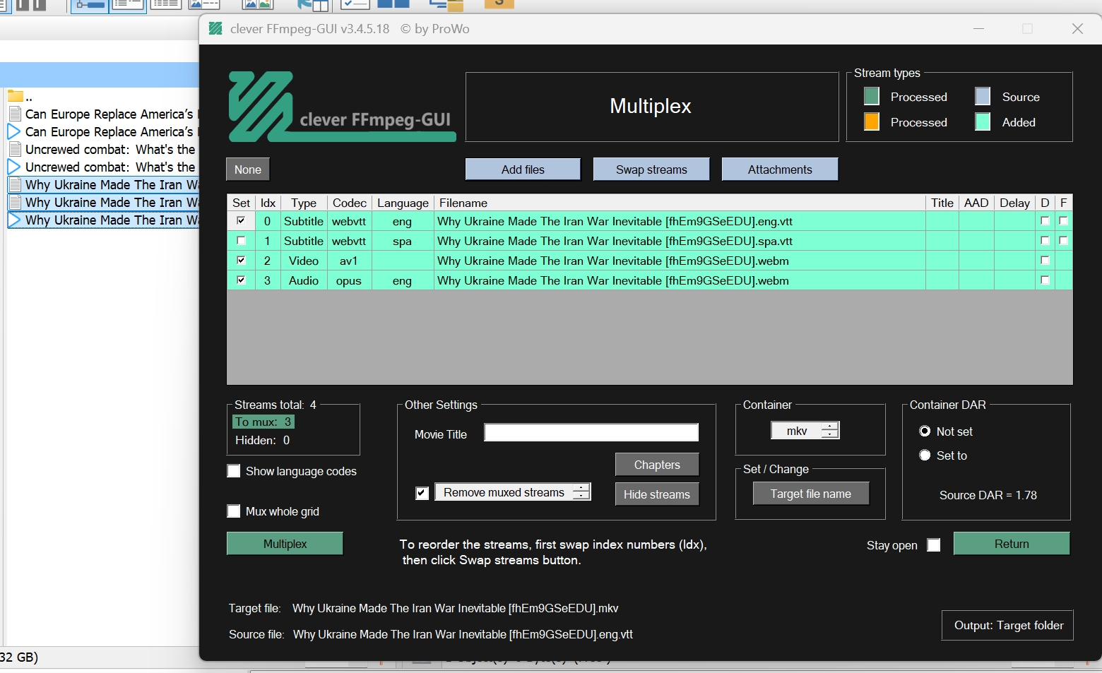

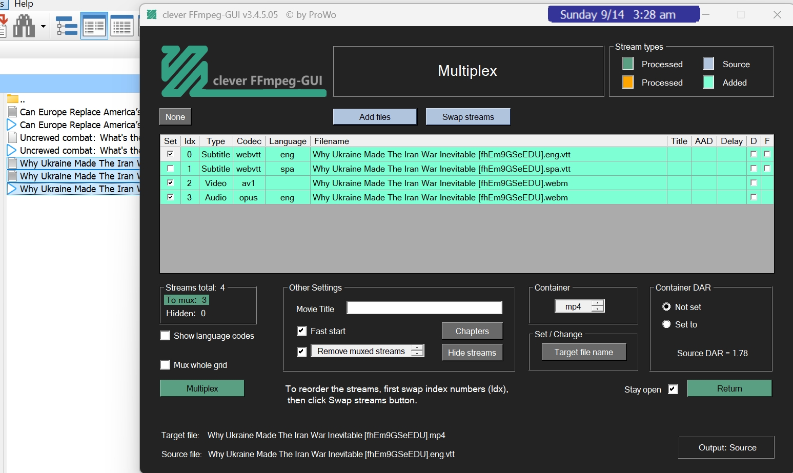

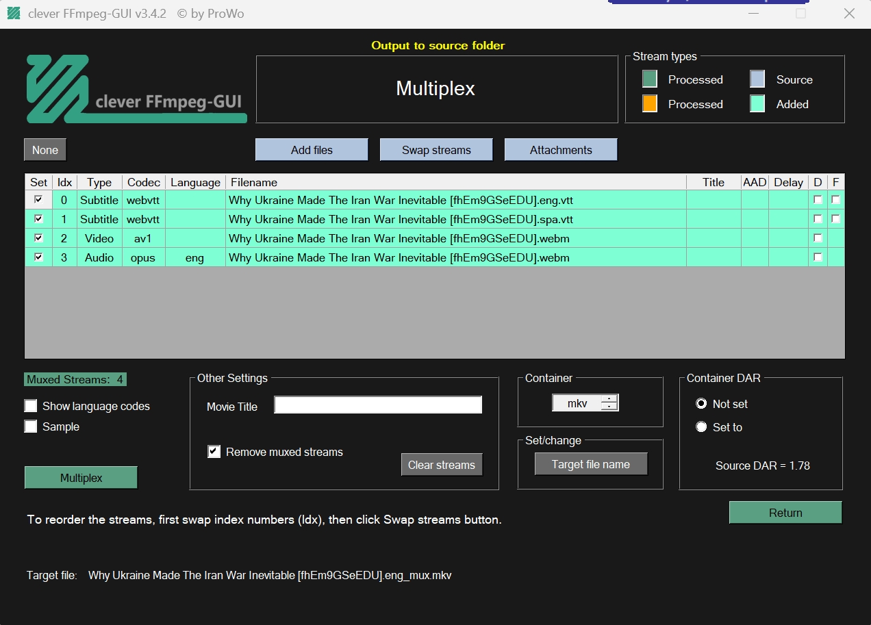

  15. Clever selects only the first subtitle stream, if there is more than one. This is problem for muxing the whole grid.
    [Attachment 88735 - Click to enlarge]
    I found an old version of Clever that selects everything. However this version does not have the new features like "keep open" and "Mux whole grid"
    [Attachment 88736 - Click to enlarge]
    I am now using v3.4.4
    It works but without the "mux whole grid" feature. I am good.
    [Attachment 88737 - Click to enlarge]
  16. @Findu, VideoAI
    This DGV issue is difficult to resolve because I cannot reproduce it on my end.
    I've changed the way, the Datagridviews are created. Check whether the related issue still occurs.
    @davidt1
    I've improved the first file check.
    Update to .18
  17. @ ProWo
    v3.4.5.18 Feedback
    So far, I can not reproduce the DGV issue. Very good!
    It frst appeared in version 3.4.5.14, only on my Intel system. I've never encountered it in other grids.
    My first thought was that it was caused by the mouse hovering over the column header when the grid was performing auto-alignment.
    Thanks for fixing the HDR reselection for SDR videos.
    Question: why is SDR to HDR limited here to av1-svt and x265 (hevc)?

    Still the same issue.
    [Attachment 88751 - Click to enlarge]

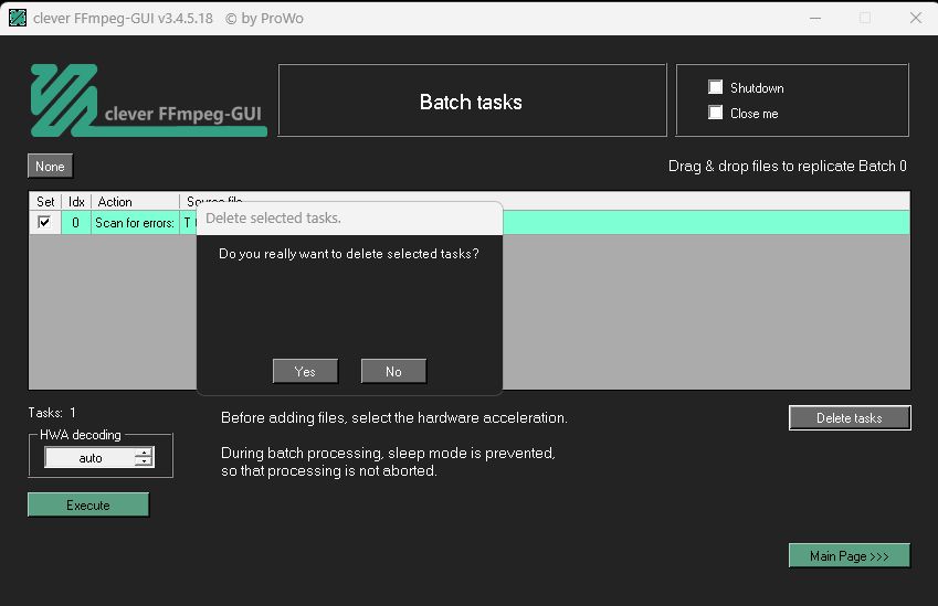

  20. @ProWo
    v3.4.5.18
    Feedback ..
    I clicked 'Delete Tasks' and was prompted by this useless,
    time consuming, energy consuming, code enlarging, ugly
    popup, asking if I really .. [really] want to delete the
    selected tasks !!
    !!! YES I do .. I clicked the button didn't I .. !!!
    Is there really a need for this confirmation popup? it is not like you're
    deleting a file permanently .. my vote is for removal .. It is up to you.
    Btw, the H/W decoding dropdown defaults to none again,
    I thought, the last time, you decided to default it to auto.
    [Attachment 88744 - Click to enlarge]

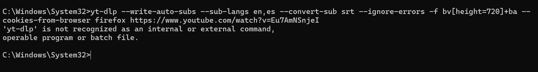

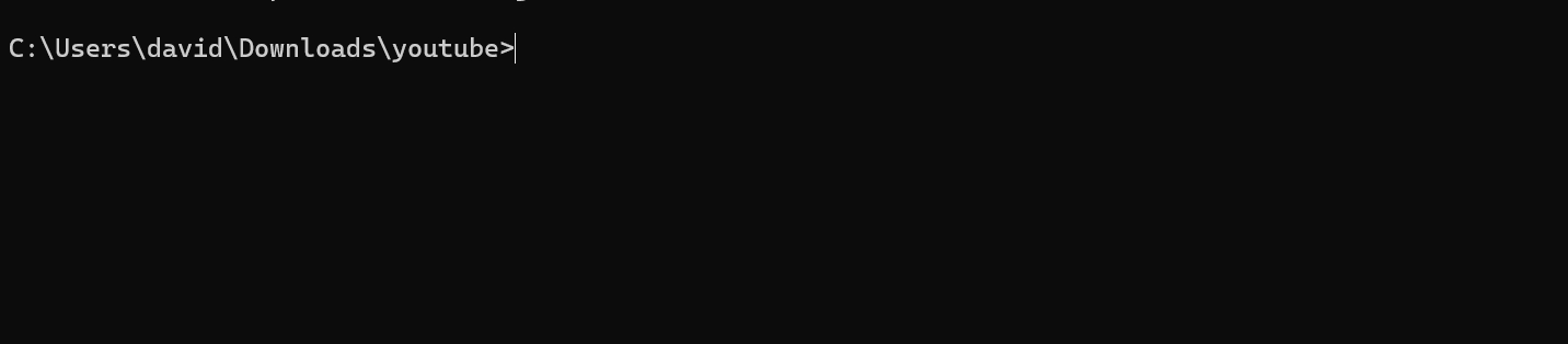

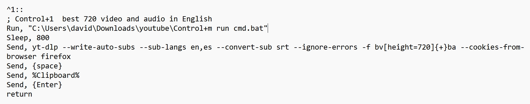

  21. This is not related to Clever. ProWo, I hope it's OK.
    videoAI,
    You mentioned that you use Autohotkey. Can you help me with something?
    I have this simple script to open this bat file to type in some text to download a YouTube video:
    [Attachment 88755 - Click to enlarge]
    The folder should be this one:
    "C:\Users\david\Downloads\youtube\Control+m run cmd.bat"
    [Attachment 88753 - Click to enlarge]
    But it opens the wrong directory/folder instead:
    C:\Windows\System32
    [Attachment 88754 - Click to enlarge]
    What am I doing wrong here?
  22. Originally Posted by davidt1 View Post
    Try to insert this line between English and Run:
    SetWorkingDir, C:\Users\david\Downloads\youtube
    yt-dlp must be in this directory
  23. @ ProWo
    Thanks for the SDR to HDR clarification.
    I'm still not able to reproduce the DGV issue on Intel and AMD. Good so far.
  24. Originally Posted by ProWo View Post
    This works. Thank you so much.

  26. @ProWo
    v3.4.5.18
    Feedback #1:
    Video Encoding -> various
    Properties:
    Standard Filters: C,B,S,G work well.
    Gamma filters: Gamma is fine.
    The Gamma RGB colors are quite off between preview and file output,
    [The weight was =1].
    Are you passing the same arguments to ffmpeg & ffplay?
    No preview-noticeable change for small [0.10] changes in The weight
    dropdown, will test this further.
    I need to do some research before testing Unsharp & Denoise, will test
    them next & feedback.
    HDR:
    Only SDR TO HDR10, SDR TO HLG are active for my system, the rest are grayed.
    HDR/HLG Popup text has already been corrected.
    I am not familiar with av1 .. yet, but will test Hevc next & feeback.
    I like how the encoder dropdown changes to x265 if it is selected and
    go back to the previous setting if it isn't [selected in HDR].
    Rotate/Flip:
    Only Rotate 90 CW/CCW is available [not similar to the Metadata rotate]
    Flip V/H & Rotate work well.
    Time Lapse:
    Time Lapse works well, but during my testing, other filters values bled
    into Time Lapse even when all the other check boxes were off !!
    Please check that all settings within an option are re-set if the option
    checkbox is unchecked.
    * Combining options is fine, if both are checked, like flip & Time Lapse
    or grayscale & rotate.

  28. Originally Posted by Findu View Post
    A smaller graphic thing.
    Should be fixed now.
  29. Originally Posted by videoAI View Post
    Yes, of course.
    Time Lapse:
    Thx for testing and the hint, is fixed now.
