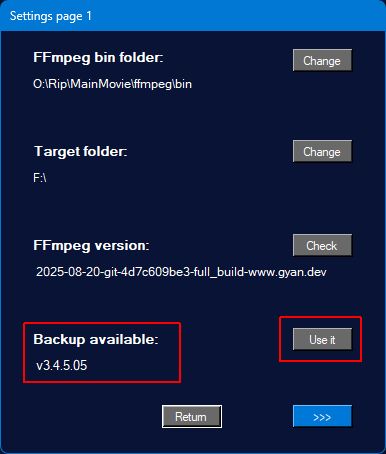

    Since Clever was deleted, how do I go back to .05? Thanks.
    Did you make a backup of v3.4.5.05?
    If so, extract the exe from the v3.4.5.06 zip archive and start it.
    Click on settings, you'll see the info like in the pic.
    [Attachment 88532 - Click to enlarge]
    Click on Use it, set restore, click OK.
    The app will restart with version 3.4.5.05.

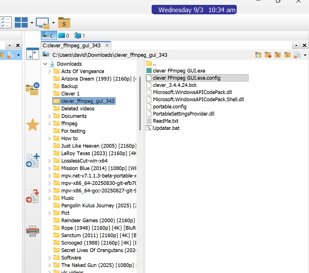

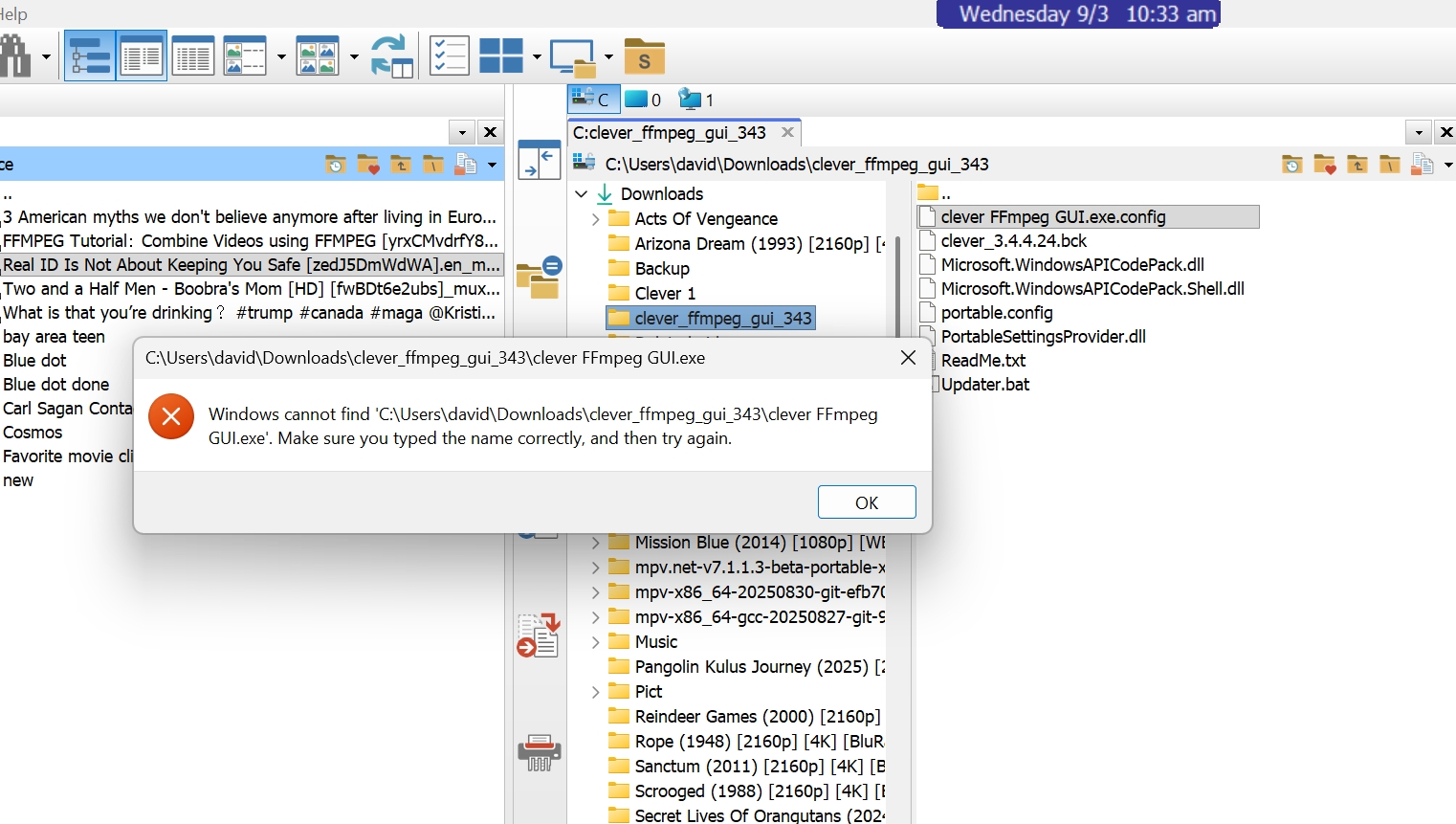

    1. I should have made screenshots of the mux screen. Under the Codex column, there is usually something like H.264, etc. etc. When I dropped a file on the mux page of .06, the codec heading shows some unrecognizable gibberish and when clicked on mux, Clever says the codec is not recognizable.
    2. I did made screenshots of the self-deleted Clever.
    [Attachment 88535 - Click to enlarge]
    [Attachment 88536 - Click to enlarge]

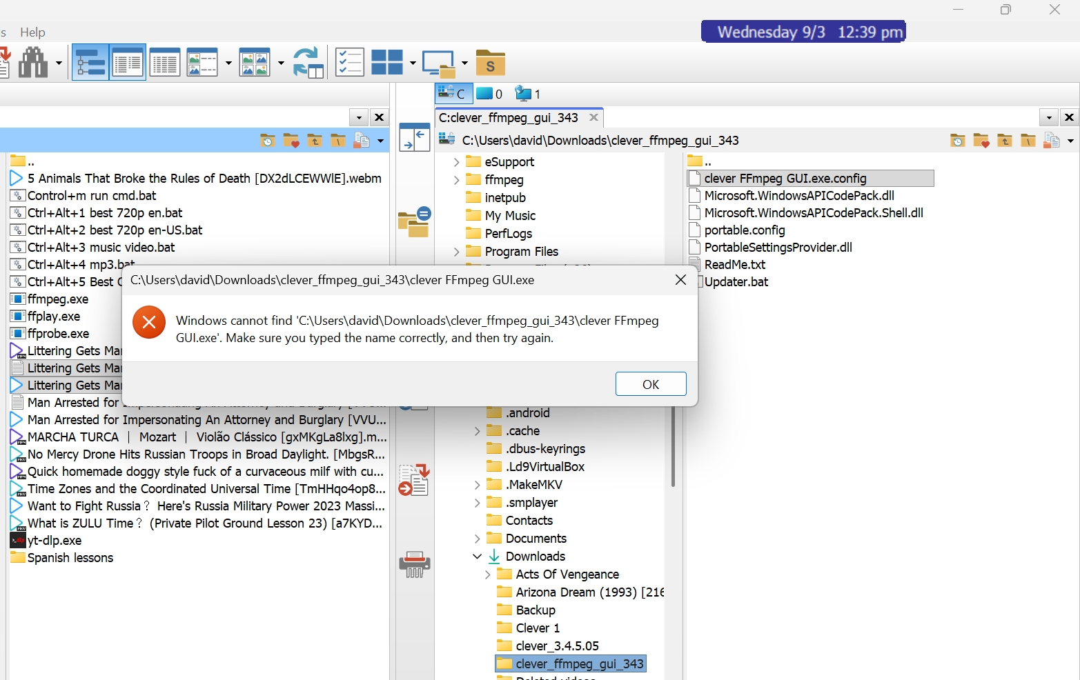

    .06 self-deleted again just now.
    [Attachment 88537 - Click to enlarge]
    Maybe Window Defender deletes it?
    How do I open the backup file you made for me? I double click on it and nothing happens. Thanks.

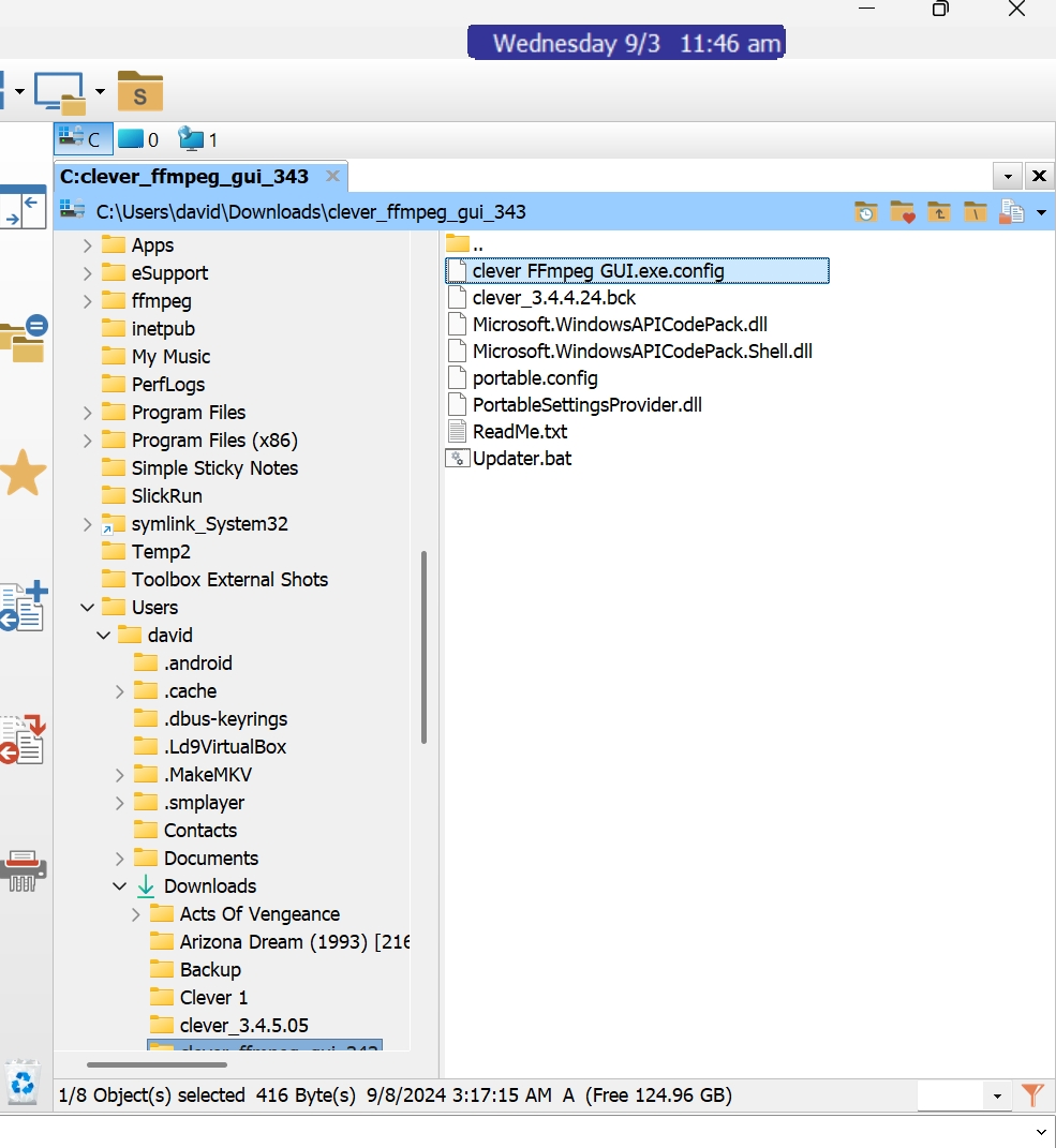

    Update:
    The app folder only contain the usual 7 files.
    I start v3.4.5.05 and update to 06. So 05 get closed and 06 get started. But when I close 06, the 06 "clever FFmpeg GUI.exe" get deleted and Updater.bat stay in the app folder.
    I use W11 x64.

  3. I downloaded the latest beta which is .06
    Sub muxing is working fine now.
    After closing, Clever still self-deletes with this messagebox.
    [Attachment 88541 - Click to enlarge]

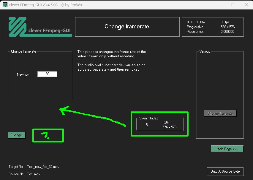

    - Is there a reason why the 'change frame rate' screen is missing 'to batch' button.
    all the other features under various have it.
    - And why is the stream index box placed all the way on the right?
    [Attachment 88551 - Click to enlarge]
    There was a reason, because the previous task involved three steps.
    That is no longer the case, so I will reactivate the button.
    The stream selection is positioned where it is because other elements were taking up the space.
    However, I will change that and move the stream selection to the left.

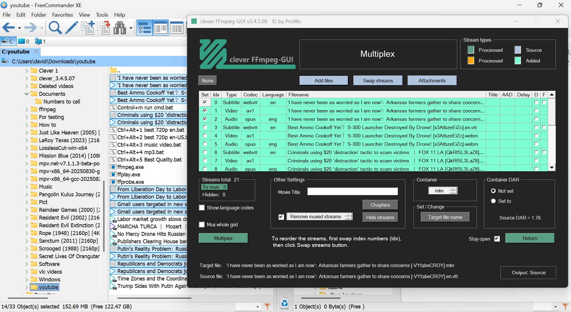

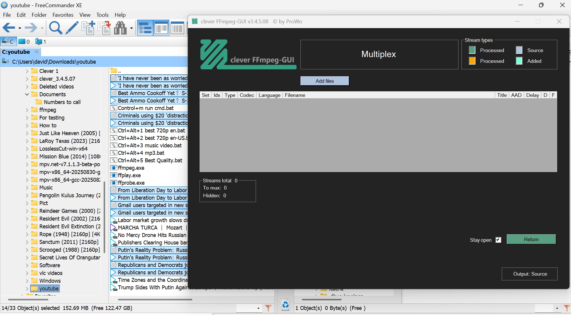

  26. I love Clever.
    I like watching YouTube videos. I download them along with the subtitle and watch later. I use Clever to mux the subtitles.
    It's great that I can drag and drop all the files to Clever. The files are then grouped and the first group is checked. If I am doing MKV and don't need to check the default, I can just click "Multiplex" until all the files are done. Can't do it this fast with MKVToolnix.
    [Attachment 88570 - Click to enlarge]
    [Attachment 88571 - Click to enlarge]
    Now if the are two subs or more, then I would need to choose a default. And if I am doing MP4 and language code is not "eng", then I have to type that in. Can Clever be optimized to automate the process even further?
  27. Originally Posted by davidt1 View Post
    You can use the "Mux whole grid" checkbox, so all streams are muxed automatically, one by one, with one click.
    But caution: hide all unnessessary streams first and make all necessary changes (default, language, forced), before you check the checkbox.
    Then click multiplex.
  28. Originally Posted by ProWo View Post
