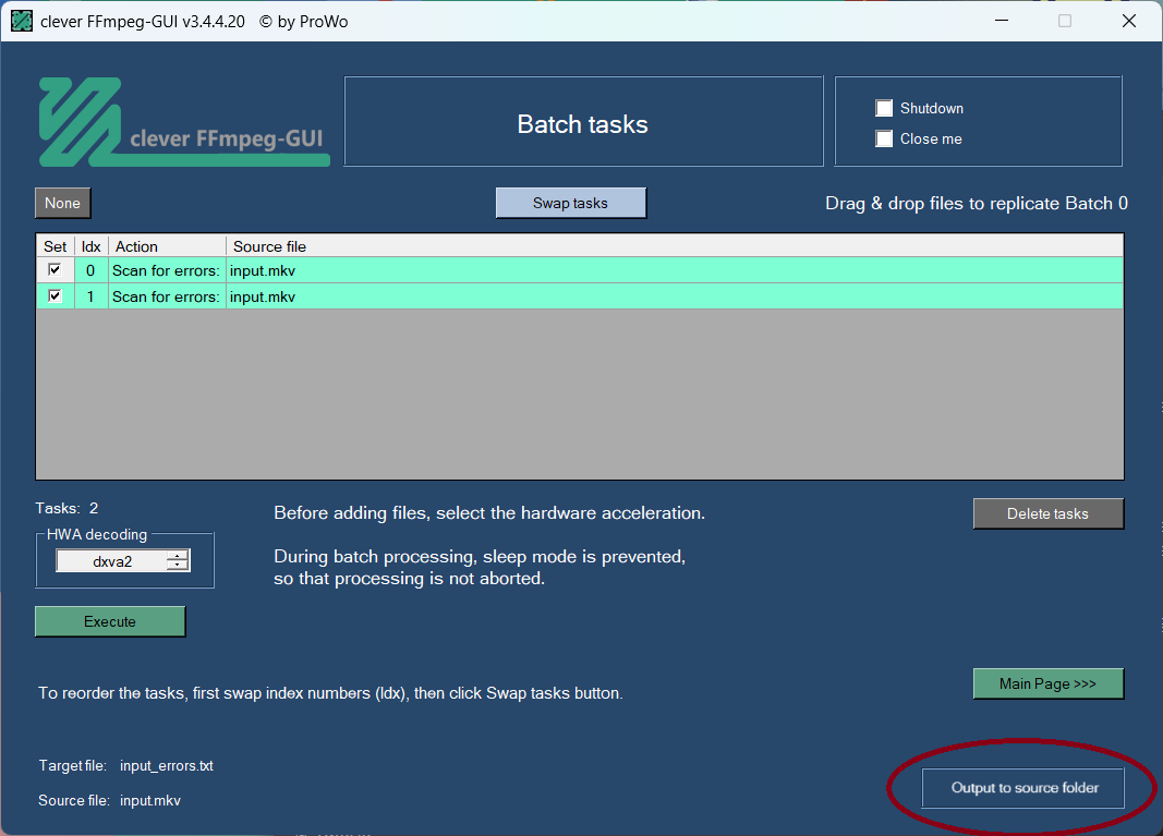

  1. Originally Posted by Findu View Post
    I found batch task thing problems!
    One audio batch task get processed, but two not. A 0 kb file for the first batch is created but the encoding does not start.
    Video batch tasks work normal.
    I cannot replicate this error.
    It could be due to the fact that the index of the audio stream from batch0 does not correspond to an audio stream in the replicated video.
    To avoid this in the future, I have introduced a background check for defective batch tasks.
    When you have one audio batch task and switch to scan for errors batch scan, all is fine.
    When you have two audio batch tasks and switch to scan for errors batch scan, the following exception occurs
    immediately:
    This error occurs when you hover over the action field with the mouse before the grid has loaded.
    This has now been fixed.
    In one of the latest nightlies, I added a new feature to the batch tasks; when you point the mouse at the action field of batch0, the command line of batch0 is displayed. This allows you to see what is being replicated.
    Does not work for stream cut/error scan batches, for obvious reasons.

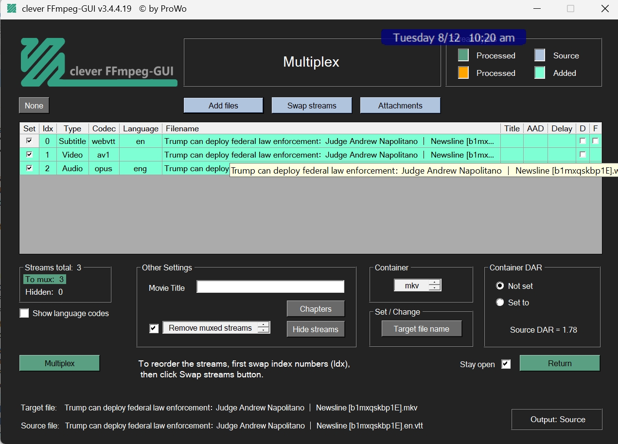

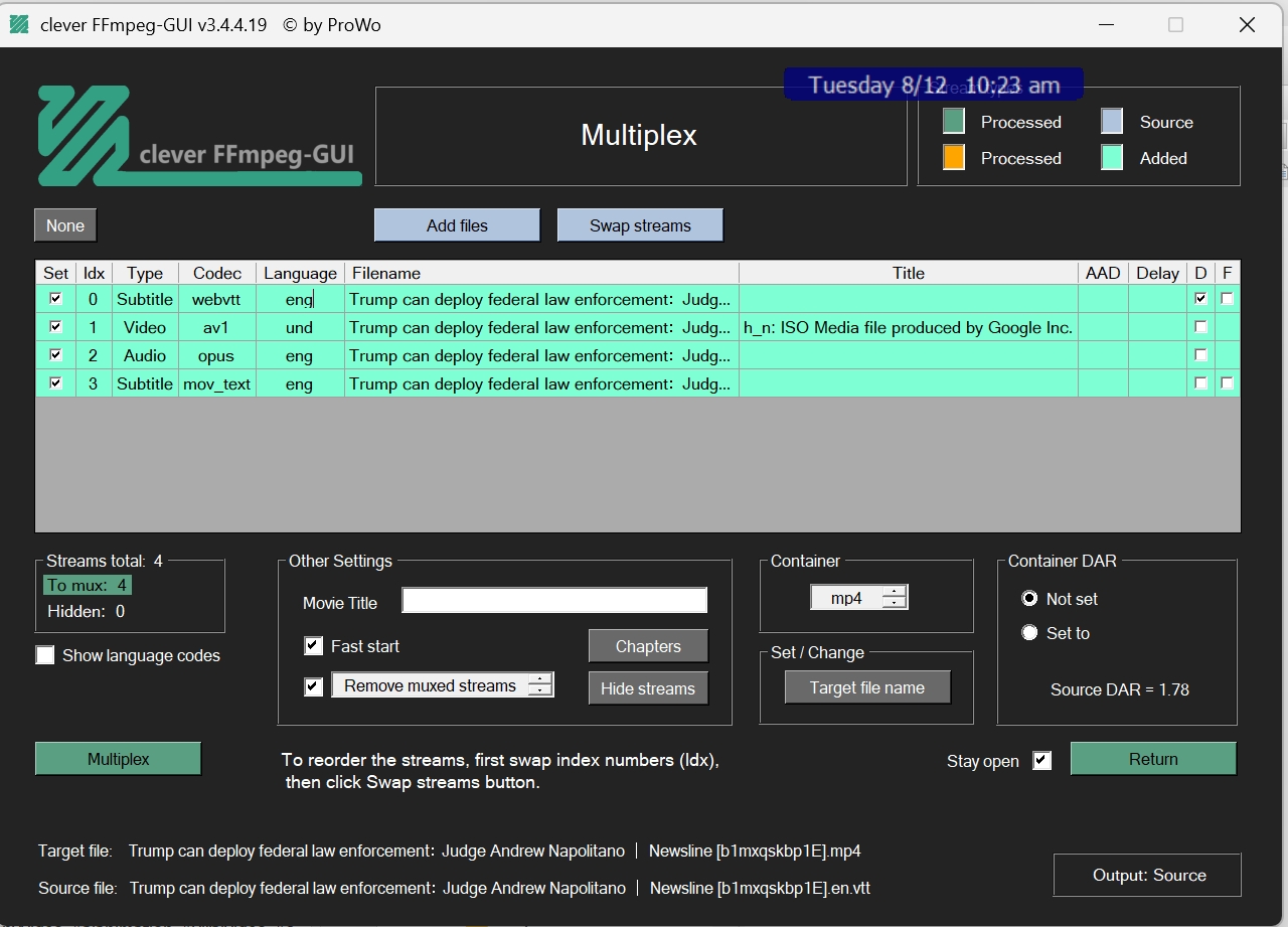

    .19 does not memorize the last format/container used.
    1. Muxed to mp4. 2. Then closed the app.
    [Attachment 88271 - Click to enlarge]
    1. Opened the app. 2. It shows MKV for the new file.
    [Attachment 88272 - Click to enlarge]

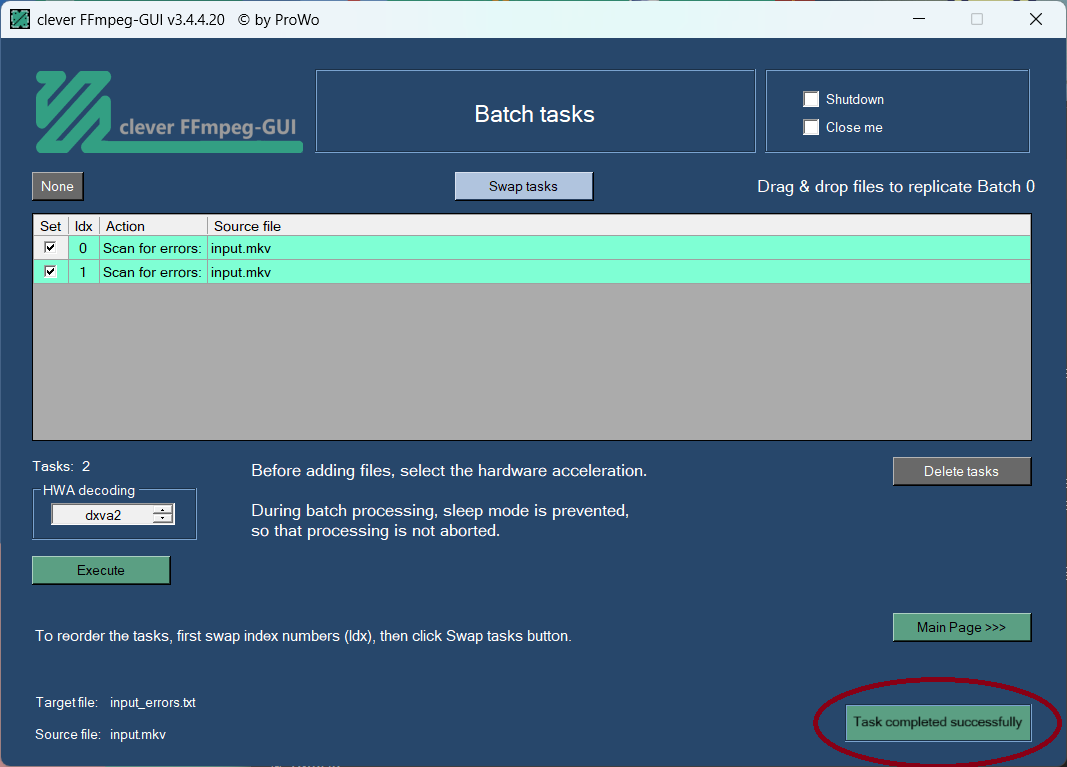

    The fix is working.
    The command line of batch0 is displayed. Good idea and working well.

  12. Originally Posted by davidt1 View Post
    Did you close the app with the X upper right?
    If so, the next time go back to the main page/source page.

  15. Originally Posted by ProWo View Post
    Yes I closed by clicking the X. I believe that's the only to close. Yes, it starts on the main page. Then I click on Multiplex. Then I drag and drop the files. Unlike previous versions, Clever now defaults to MKV even though I muxed the MP4 the last time.
  16. @ProWo
    v3.4.4.19
    Edit #1
    The Apple ecosystem does not support MKV (Matroska Video) files natively across its devices and software.
    While macOS and iOS can play some MKV files through third-party applications, such as VLC or Infuse, the
    default media players like QuickTime do not support this format directly.
    If you want to play MKV files on Apple devices, consider using one of the mentioned third-party apps or
    converting the files to a compatible format like MP4.
    .. and all the other screens that have an mp4 checkbox please.
    I don't understand why you still want to force us to use mkv??
    Unlike previous versions, Clever now defaults to MKV even though I muxed MP4 the last time.
    I don't think he is forcing us to use MKV, as previous versions of Clever defaulted to the last used format/container.
    It seems like every time he updates Clever, something is messed up somewhere.
  21. @ ProWo
    Thanks for adjusting mp3_mf default bitrate and permitted frequencies.
    "Mux whole grid" and output of/to multible sources has been fixed. Also other combinations work now.
    If you drop two files into the mux grid, unselect all checkmarks and select one stream, I would expect "Mux whole grid" to appear again. But it only appears when you click First after the grid has no checkmarks.
    Header text "Scan for errors mode" only show up with one task in the grid.
    If you have a normal batch task and go to scan for errors batch tasks, this mode is displayed under the header. If you drop a file, that text and the HWA selection disappears. If you swap the stream or delete the normal batch task, HWA reappears. That's logical.
    But the header text "Scan for errors mode" does not reappear.
    The same applies if you only have one task to scan for errors from the beginning and drop another.
    Or is that intentional?
    How about sharing the space for the output and the new success notification including the timer?
    [Attachment 88287 - Click to enlarge]
    [Attachment 88288 - Click to enlarge]

  24. .20 defaults to last used format/container. Thank you, ProWo.
  25. Originally Posted by Findu View Post
    That's intentional
    That's intentional too.
    The message should appear only, if you enter batch scan for errors, to make it clear that no other batches can be inserted here.
    Later, in the batch tasks window, you can choose the task type for further files with the batch0 replication.
    That's why the message is superfluous here.
    I don't like that.
