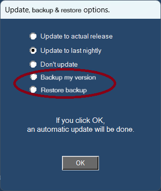

  10. @ ProWo
    Simple backup/restore, user-controlled
    How about offering a backup for the app (can be used before an update) and the abbility to restore it?
    But it's up to the user to decide whether or not to do this starting with the respective version.
    [Attachment 88147 - Click to enlarge]
    A backup cmd just rename the current app to .bak and overwrite an existing .bak.
    copy "clever FFmpeg GUI.exe" "clever FFmpeg GUI.bak" /Y
    The restore cmd rename the current .exe to .bak2, .bak to .exe and .bak2 to bak. All between closing and starting the app.
    taskkill /IM "clever FFmpeg GUI.exe"
    ren "clever FFmpeg GUI.exe" "clever FFmpeg GUI.bak2"
    ren "clever FFmpeg GUI.bak" "clever FFmpeg GUI.exe"
    ren "clever FFmpeg GUI.bak2" "clever FFmpeg GUI.bak"
    start "" "clever FFmpeg GUI.exe"
    So you can switch between two versions as long as they offer this new recovery dialog.

  15. I have thought about the backup/restore function and am of the opinion that the benefit is disproportionate to the effort.
    The backup is not a problem, but the restore is associated with considerable effort; the backups created have to be recorded, then copied into a manipulable selection; then code is needed to select, delete, restore.
    The program inevitably becomes larger and the benefit is small; the update function always provides the latest full release and the latest nightly.
    That should be enough.

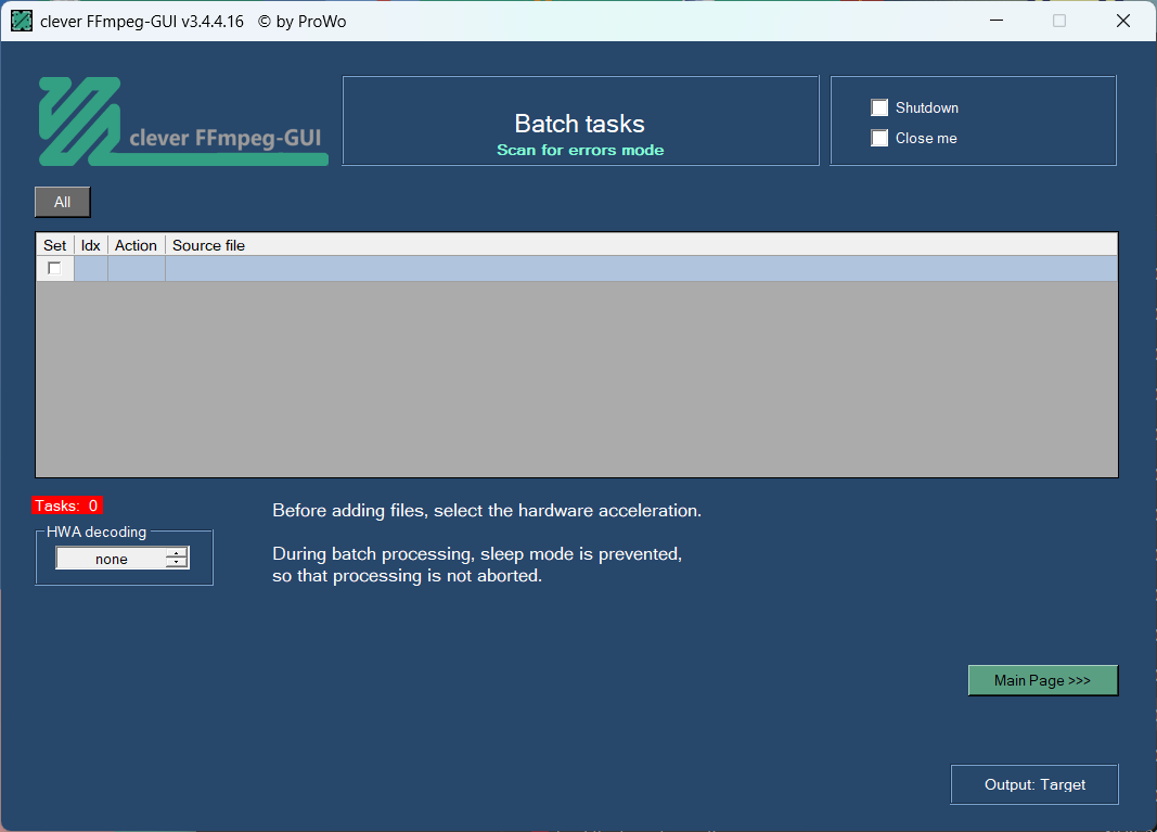

    v3.4.4.16 Feedback
    Can you please align the new "Output folder" box.
    [Attachment 88180 - Click to enlarge]
    When you have usual batch tasks, you also see them in scan for errors. You can process them and you can delete them there. But after deletion, when you add videos, no task discription is showen and the Execute button is missing.
    [Attachment 88181 - Click to enlarge]
    When you go to the Main page and back to scan for errors you see the discription.
    Deleing such tasks can end in an error.
    System.NullReferenceException: Die Objektvariable oder die With-Blockvariable wurde nicht festgelegt.
    BTW, you can add and check audio files with scan for errors as well.

  21. .16 ProWo moved the output folder indicator to the lower right corner. It now shows source or target folder. Works for me. Thank you.
  22. Originally Posted by Findu View Post
    No, I like it this way and it's easy to read.
    I rewrote the whole batch tasks thing. It should work now.

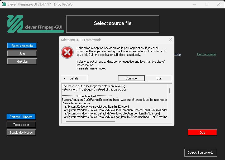

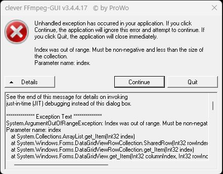

    [Aug 11, using v3.4.4.18 now. The index crashes seems very Rare now.
    Stability has been greatly enhanced. Using clever 24 Hrs a day now.
    Edit #2
    [Aug 8, 8PM, another Crash .. same index error ..]
    ************** Exception Text **************
    System.ArgumentOutOfRangeException: Index was out of range.
    Must be non-negative and less than the size of the collection.
    Parameter name: index
    at System.Collections.ArrayList.get_Item(Int32 index)
    at System.Windows.Forms.DataGridViewRowCollection.Sha redRow(Int32 rowIndex)
    at System.Windows.Forms.DataGridViewRowCollection.get _Item(Int32 index)
    at System.Windows.Forms.DataGridView.get_Item(Int32 columnIndex, Int32 rowIndex)
    at clever_FFmpeg_GUI.Form38.Check_batch0()
    at clever_FFmpeg_GUI.Form38.Streams_selected_count()
    at clever_FFmpeg_GUI.Form38.VB$StateMachine_200_Butto n4_ClickAsync.MoveNext()
    --- End of stack trace from previous location where exception was thrown ---
    at System.Runtime.ExceptionServices.ExceptionDispatch Info.Throw()
    ************** Loaded Assemblies **************
    Edit #1
    [Another Crash .. this time in the scan for errors batch grid, all grids lack index validation]
    [Attachment 88199 - Click to enlarge]
    Another crash ...
    Bug #12 End of batch job crash
    Job processed 2 mp4s, resized from 1920 -> 1280 successfully,
    but clever crashed after job completion as shown below:
    Common causes for this crash include:
    1. Attempting to access a row/cell index that doesn't exist
    2. Empty DataGridView
    3. Incorrect row/column indexing
    4. Asynchronous threading issues
    Hope this helps .. quick fix to try:
    // Before accessing rows, always check:
    if (dataGridView1.Rows.Count > 0 && rowIndex >= 0 && rowIndex < dataGridView1.Rows.Count)
        // Your row access code here
    [Attachment 88192 - Click to enlarge]

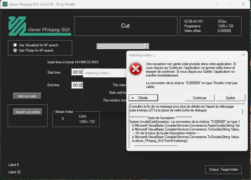

  26. Member
    Aug 2025
    Avignon
    Hello,
    I get an exception when launching the cut function (version 3.4.4.18) on a mp4 or mkv file:
    [Attachment 88221 - Click to enlarge]
    bb

  30. Originally Posted by bb84000 View Post
    Hello,
    bb
    Strange; this conversion shouldn't cause any errors.
    It doesn't happen to me, and I haven't heard anything about it from other users either.
    Anyway, I've changed the code to avoid this conversion. Update to .19
