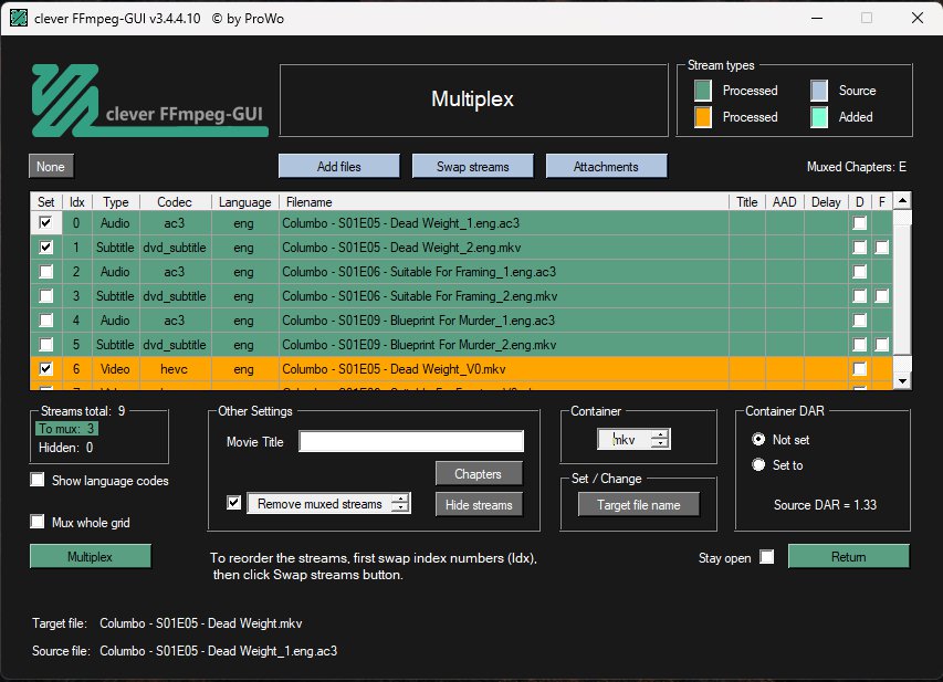

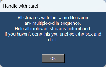

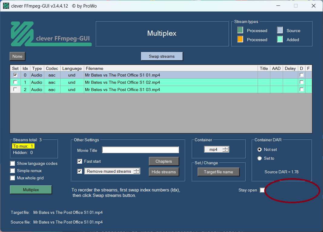

  1. Originally Posted by Findu View Post
    Are these “Mux whole grid” rules are correct?
    - Everything that is visible in the grid will be muxed.
    Yes
    - All selected streams get muxed into one file.
    Yes, but your selection is wrong. E01+E03 are muxed together.
    It should be selected the first file streams only.
    The unselected streams get muxed according to name.
    Correct.
  2. >> All selected streams get muxed into one file.
    To avoid errors here, you could only show the “Mux whole grid” option if only the first stream (or streams with the first file mane) is selected and more than one file name is present in the grid.
    EDIT: If someone makes a wrong selection afterwards, the option will also disappear or inactive.
    EDIT 3: I just noticed that this is already implemented. But when muxing is finished and the hidden streams are displayed again, "Main Page" remains hidden. It appears when you activate "Simple remux".
    [Attachment 88095 - Click to enlarge]
    EDIT 2: “Mux whole grid” for singel audio streams?
    If you only want audio from a video, lets say aac to mp3, should you also mux that stream after encoding?

  5. Originally Posted by Findu View Post
    Should be fixed now.
    If the converted audio stream comes from a video, it is also added to the muxgrid list.

  8. If you place v3.4.4 on the desktop and then update to nightly, the original position remains, just as before. The problem only occurs starting with approximately v3.4.4.07.
    The missing "Main Page" button on the mux page has been fixed.
    The question is whether it makes sense to multiplex MP3 files after encoding them.
    Because the files can be played without muxing as well.

  10. Unfortunately the "Main Page" button now disappears after normal multiplexing.
    Could you start the text with "All visible streams ..."?
    [Attachment 88113 - Click to enlarge]

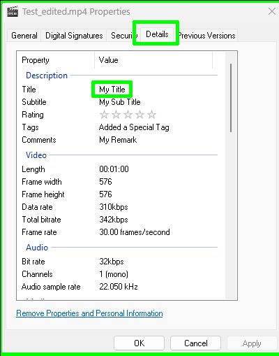

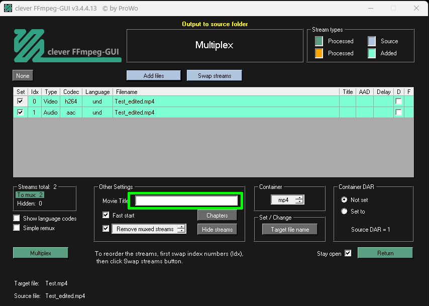

  12. @ProWo
    1- I noticed that the Movie Name [Title] isn't being read by Clever anymore.
    2- Also the Video/Audio stream titles are not read, saved , or displayed anywhere.
    3- Another thing .. the target file name is [Test.mp4] when the source file name is [Test_edited.mp4].
    Does that seem right? you might be using the term '_edited' in your code !!
    4- Any plans to read/write the Metadata field 'Comment' in the future?
    It can go under Various [no encode needed]
    Media Info
    Complete name : C:\T\Test\Test_edited.mp4
    Format : MPEG-4
    Format profile : Base Media
    Codec ID : isom (isom/iso2/avc1/mp41)
    File size : 2.50 MiB
    Duration : 1 min 0 s
    Overall bit rate : 349 kb/s
    Frame rate : 30.000 FPS
    Movie name : My Title
    Writing application : videoAI
    Comment : My Remark
    [Attachment 88114 - Click to enlarge]

  14. Originally Posted by Findu View Post

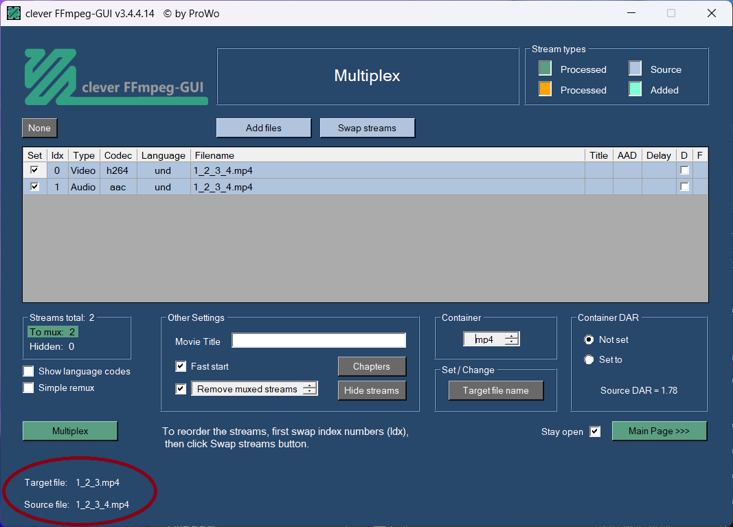

  15. The disappearing "Multiplex" button and the remaining position of the app window after updating are fixed in v3.4.4.14.
    Thank you ProWo.
    With normal multiplexing, _mux is no longer appended to the filename. I suspect this is intentional.
    However, in the output filenames, you truncate everything with the last _ of the original name. But only with muxing.
    1_2_3.mp4 -> 1_2.mp4
    This is intentional.
    For example, if you re-encode mp4 episodes in batches (audio and video) and select mkv as the container in the mux grid and then use “mux whole grid,” you will not need to rename the output files afterwards.

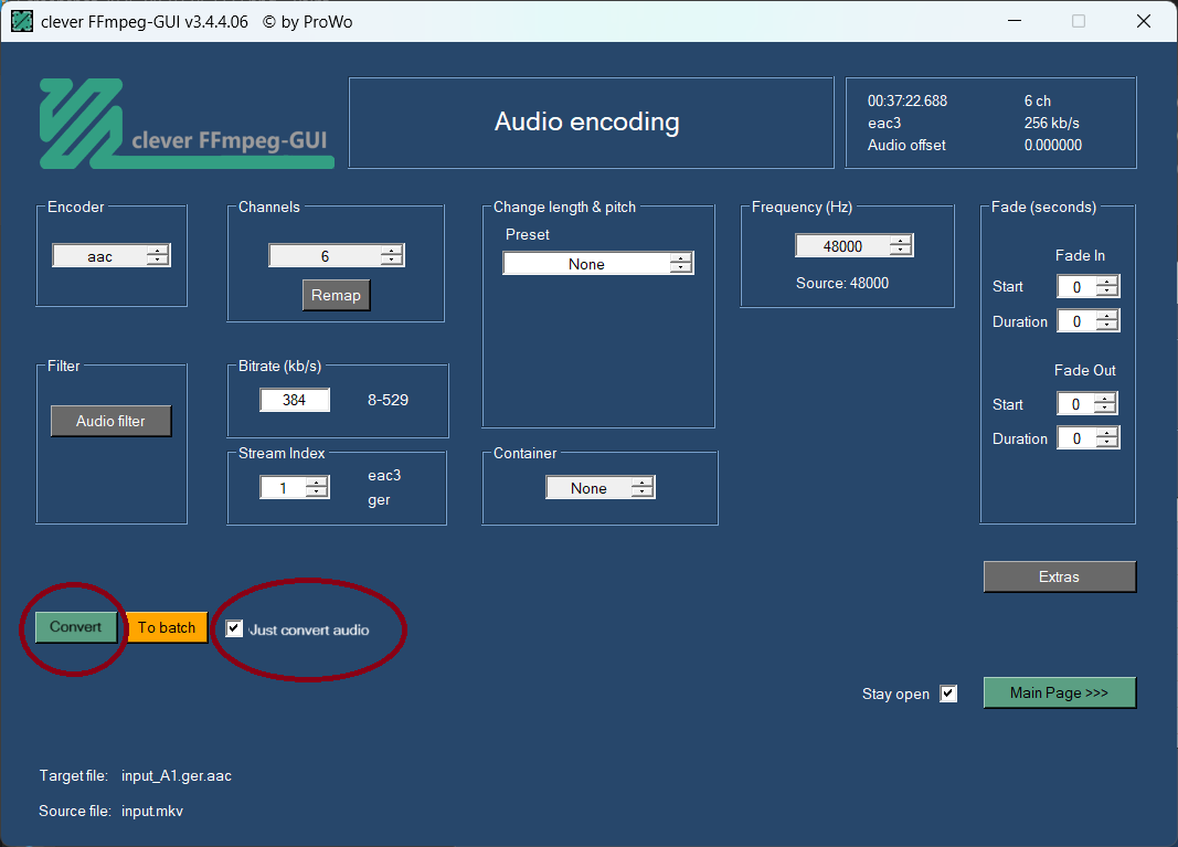

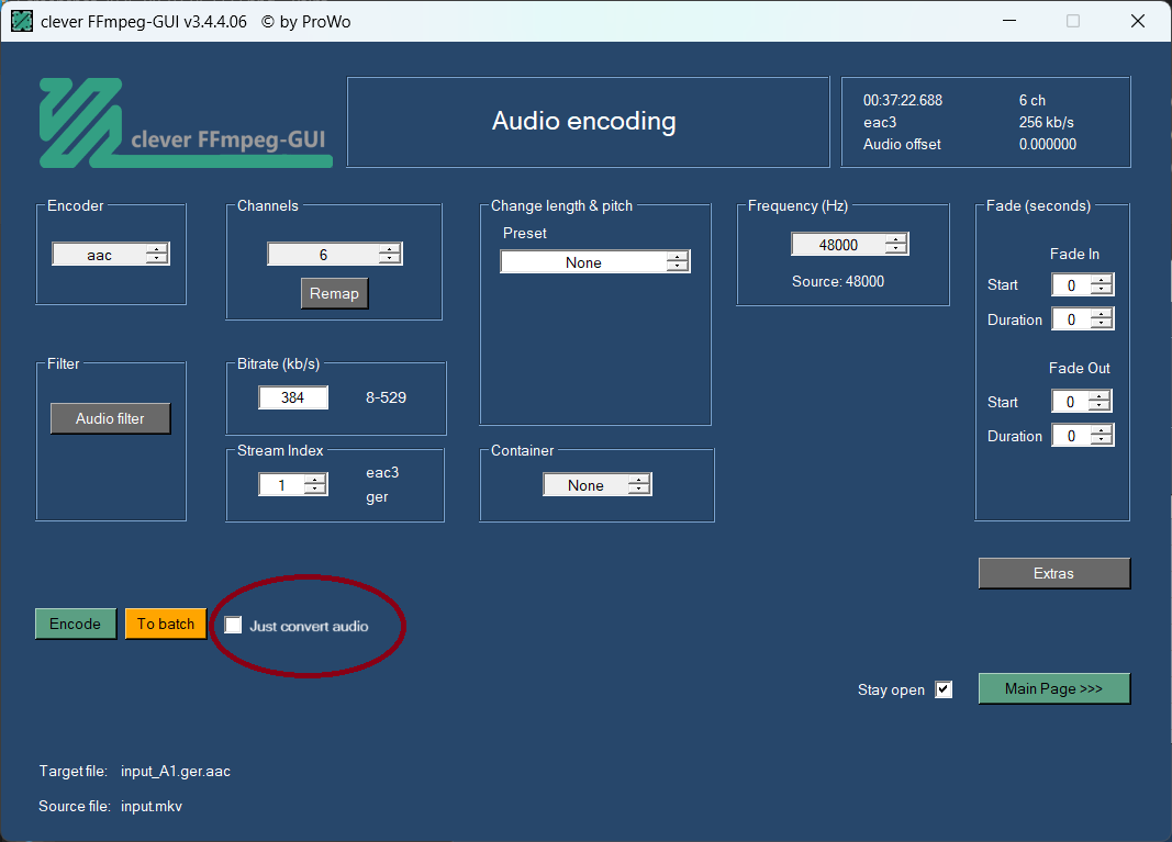

  19. @ ProWo
    Does the following make sense to you?
    As the app can't know that you just want to encode audio from a video file, you could add a checkbox "Just convert audio" with tootip "Just encode audio without data transfer for further processing".
    When you check it, the "Encode" button change to "Convert" as well.
    None of these encoded files are available for multiplexing and therefore do not appear in the “Unused Files” list.
    [Attachment 88117 - Click to enlarge]
    [Attachment 88118 - Click to enlarge]
    I know that convert isn't really the right term here when you extract and encode audio from a video.
  20. Originally Posted by videoAI View Post
    The title tag (as format tag) is read, written and displayed correctly in mux grid (for mkv, mp4, mov).
    The title tag (at stream level) is read, written and displayed correctly for mkv.
    For mp4/mov ffprobe can't find the data, therefore they cannot be read / displayed, but they are written correctly.
    Read my answer to Findu in post #2387.
    No.
  21. Originally Posted by Findu View Post
    Not really; when recoding an audio file, nothing is written to the mux list.
    If the source is a video file, so further use is to be expected.
  22. @ ProWo
    That's correct!
    The target file names get cut at the last "_". But only with muxing.
    Here a screenshot to clarify:
    [Attachment 88120 - Click to enlarge]

  23. Originally Posted by Findu View Post
    That's aspected. The last _ is the necessary separator to identify the same file name.
    But file names like the ones you showed are not common.

    1- Open or drag an mp4 file -> Main -> Multiplex .. meta data is read [ok]
    2- From source page, click Multiplex, click Add file .. meta data is not read [issue].
    If you add more files, their meta data isn't read as well ..
    Kindly add to your issues list
    Clever is not showing anything in the Mux grid title box for this file !!
    [Edit #1] if I Mux the file with clever and add a title , the title shows, and is read back.
    but it seems, clever is not always displaying Titles written by other Apps, to the same field,
    while windows detail, in properties, can.
    Does the 'Writing application' field get anything to do with this issue??
    General
    Format : [1, here]
    Movie name : My Title [2, or here]
    Comment : My Remark

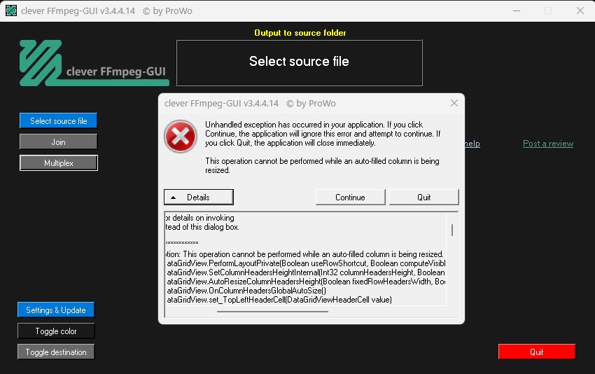

  25. @ProWo,
    v 3.4.4.14
    Another crash ...
    Bug #11 Source Page Crash
    It happens from time to time. It mostly happens going back to the [Select Source] page from the [Multiplex] page.
    had 4 similar crashes in the last 2 days, by just using the app.
    I recommend slowing down the "enhancement changes" and giving more priority to bugs which cause crashes.
    Try:
    Suspend Layout: Before making changes, suspend the layout of the DataGridView.
    Perform Operations: Perform the necessary operations.
    Resume Layout: Resume the layout.
    Debugging tip
    When encountering layout-related exceptions in DataGridView, consider temporarily setting
    dgv.AutoSizeColumnsMode = DataGridViewAutoSizeColumnsMode.None
    to see if it resolves the issue, allowing you to further diagnose and modify your code as needed.
    This approach can help you isolate whether the problem is related to auto-sizing or not.
    *********** Exception Text **************
    System.InvalidOperationException: This operation cannot be performed while an auto-filled column is being resized.
    at System.Windows.Forms.DataGridView.PerformLayoutPri vate(Boolean useRowShortcut, Boolean computeVisibleRows, Boolean invalidInAdjustFillingColumns, Boolean repositionEditingControl)
    at System.Windows.Forms.DataGridView.SetColumnHeaders HeightInternal(Int32 columnHeadersHeight, Boolean invalidInAdjustFillingColumns)
    at System.Windows.Forms.DataGridView.AutoResizeColumn HeadersHeight(Boolean fixedRowHeadersWidth, Boolean fixedColumnsWidth)
    at System.Windows.Forms.DataGridView.OnColumnHeadersG lobalAutoSize()
    at System.Windows.Forms.DataGridView.set_TopLeftHeade rCell(DataGridViewHeaderCell value)
    at System.Windows.Forms.DataGridView.get_TopLeftHeade rCell()
    at System.Windows.Forms.DataGridView.OnCellMouseEnter (DataGridViewCellEventArgs e)
    at System.Windows.Forms.DataGridView.UpdateMouseEnter edCell(HitTestInfo hti, MouseEventArgs e)
    at System.Windows.Forms.DataGridView.OnColumnWidthCha nged(DataGridViewColumnEventArgs e)
    at System.Windows.Forms.DataGridView.AdjustFillingCol umns()
    at System.Windows.Forms.DataGridView.ComputeLayout()
    at System.Windows.Forms.DataGridView.OnHandleCreated( EventArgs e)
    at System.Windows.Forms.Control.WmCreate(Message& m)
    at System.Windows.Forms.Control.WndProc(Message& m)
    at System.Windows.Forms.NativeWindow.Callback(IntPtr hWnd, Int32 msg, IntPtr wparam, IntPtr lparam)
    ************** Loaded Assemblies **************
    [Attachment 88122 - Click to enlarge]
    Clever v 3.4.3.28
    BTW, issue is still there. had 3 crashes since the last time I reported the bug.
    you can arrive at the exception error from multiple scenarios. I narrowed it
    down a bit. it seems to occur when your code is preparing to display a grid.
    seems to apply to all your grids.
    These posts are not very helpful.
    I use the program every day and have not experienced any crashes.
  26. In older version, the top of the screen used to say "Output to source folder" or "Output to target folder". Now it just says "Output to source folder."
    What happened? It doesn't hurt to display "Output to target folder" if target folder was selected.

    Originally Posted by davidt1 View Post
    In older version, ...

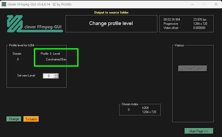

  28. @ProWo,
    v 3.4.4.14
    FYI, .. just a little text adjustment.
    [Attachment 88137 - Click to enlarge]
    If I'm not mistaken, encode is required to change the Profile,
    but is not required to change the Level.
    Since they are paired, I hoped both could be in one place, to check or change.
