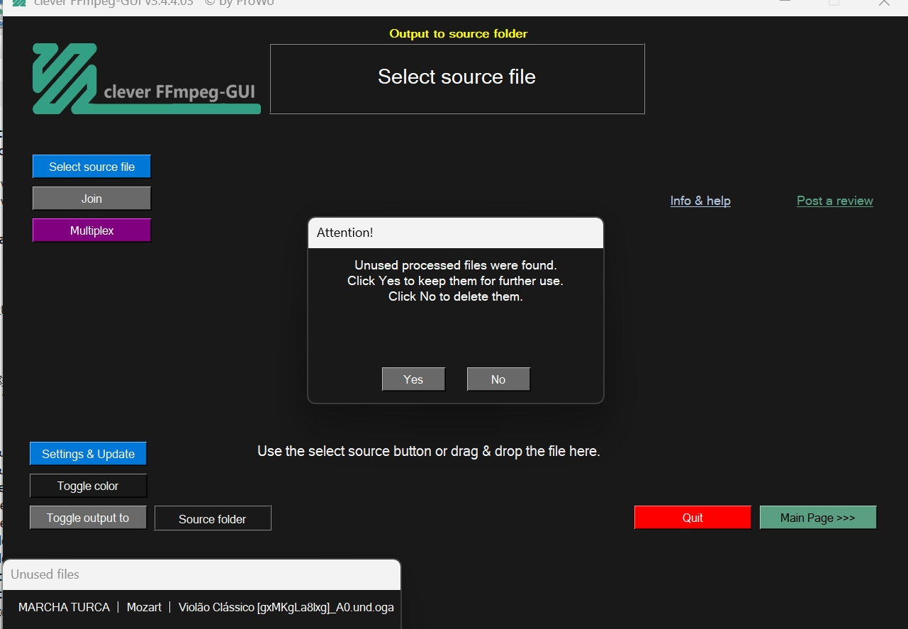

  5. I converted an audio stream to mp3 to listen to. Now every time the app starts it asks me if I want to keep or delete the file. This step is not logical at all. It should be obvious that I want to keep it. That's why I converted in the first place. Would it be possible to make it ask just one time?
    As of now the solution is to rename the file to get out of this silly loop/question.
    [Attachment 88035 - Click to enlarge]
  6. Originally Posted by davidt1 View Post
    Fixed. If you convert a single audio file, it isn't no more added to the list.

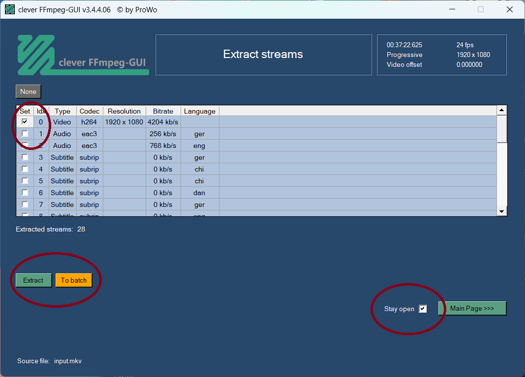

  13. @mannequin80
    Can you run this cmd command "wmic cpu get name" and tell us the exact CPU name.
  14. > Precisely why you should consider adding a checkbox in the video encode screen to add the audio stream to the output container.
    The only use for this is when you want to modify a single video stream and keep the rest and been able to batch replicate it.
    What If you just want to modify a single audio stream and keep the rest also for replication?
    So it would make sense there too.
    Suggestion for your last batch workaround:
    How about an additional entry to the new mux dropdown (Remove muxed streams & Clear grid after muxing) called "Multiplex by name"?
    With one click, all selected streams with the same name (till first _ or .) are muxed into one file. Name by name if different names are selected too. A kind of batch muxing.
    And if you add "To Batch" in the "Extract streams" page or add stream copy (into valid containers) to the encoder selection for video and audio, you are able to batch and replicate "untouched" streams which will appear individually in the mux grid. Ready to be muxed with other streams/files by one click using "Multiplex by name".
    There is no need to add all the original files to get "grid access" to only one or two untouched streams you want to keep.
    And you are not limited to one modified video stream!
    So you remain in the app with the same result including full multiplex background checks and alignments processing.

    I'm working on it, but there are problems to solve.
    Select by name is already implemented; you see it at work with the first mux grid launch.
    I'm thinking to change "All" (with the none/all button left above) to "First file".
    This way, if you make changes on selections, you can restore the "First file selected" with one button click.

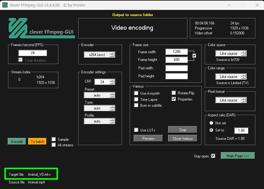

  21. @ProWo
    Hint:
    video encoding - color range dropdown keeps switching from 'Like Source' to 'Limited'.
    Also it doesn't show what the source is.
    [edit#1] Also, you may wish to change 'progressive encoding' to 'encoding in progress'.
    Keep up the good work ..

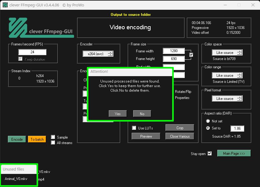

  22. @ProWo
    So may be I was too quick to say 'It works flawlessly'.
    Here are some of the issues noticed with the addition of 'all streams' change in video encode screen.
    1- The progress bar, for mp4, does not show, it is there for mkv. The bar is essential especially for large file encoding.
    BTW, for both [mp4,mkv], when 'Clever' is minimized to the task bar, the icon does not show progress like in other
    apps.
    2- After encoding, even if you rename, delete, or move the output mp4 file, when exiting 'Clever' sometimes insists
    that there is file-name_V01.mkv to be deleted [even when mp4 was selected [All streams checkbox]. I can't find
    such a file anywhere.
    [Attachment 88048 - Click to enlarge]
    [Attachment 88049 - Click to enlarge]
    But the encoding with audio stream(s) works fine so far .. thank you for adding it in.

    1. You load the first file, open the Video page and select the "new stream copy" for the video (into a valide container) from the Encoder dropdown and batch it.
    2. Open the Audio page and select the "new stream copy" for audio 1 and batch it.
    3. Select audio stream 2 and stereo channels and batch it.
    4. Open Batch tasks and replicate all three batches 49 times. Therefore you drop the 49 remaining files 3 times to batch 0 which you have to change before each drop. Click once on "Execute".
    5. Open the mux page and use the upper right boxes to unselect all 29 source streams with one click and select all processed streams with one click too. Select "Multiplex by name" and click once on "Multiplex". Done!
    If we could batch subtitles as well, we had all for replication you need.
    There is no need to add the original files into the mux grid to get access to one or two unprocessed streams out of 29 any longer when it comes to replication.
    EDIT:
    We already have the place for stream copy. It is the "Extract streams" page.
    If you add "To batch", which will appear only when a single stream is selected, and also "Stay open", we had all we need.
    The stream copy to a batch will always extract to a valid container like mkv to keep the timing in the stream for further muxing when it is required.
    [Attachment 88056 - Click to enlarge]
    1. You load the first file, open the "Extract streams" page and select only the video stream and batch it.
    2. Then select only audio stream 1 and batch it too.
    3. Then open the "Audio" page and select audio stream 2 and stereo channels and batch it.
    "Multiplex by name" just use the new grid setting "First", and repeat the Multiplexing till the grid is empty!
    So we stay in the basic property of treating streams separately and been able to batch and replicate quickly many files the same way.

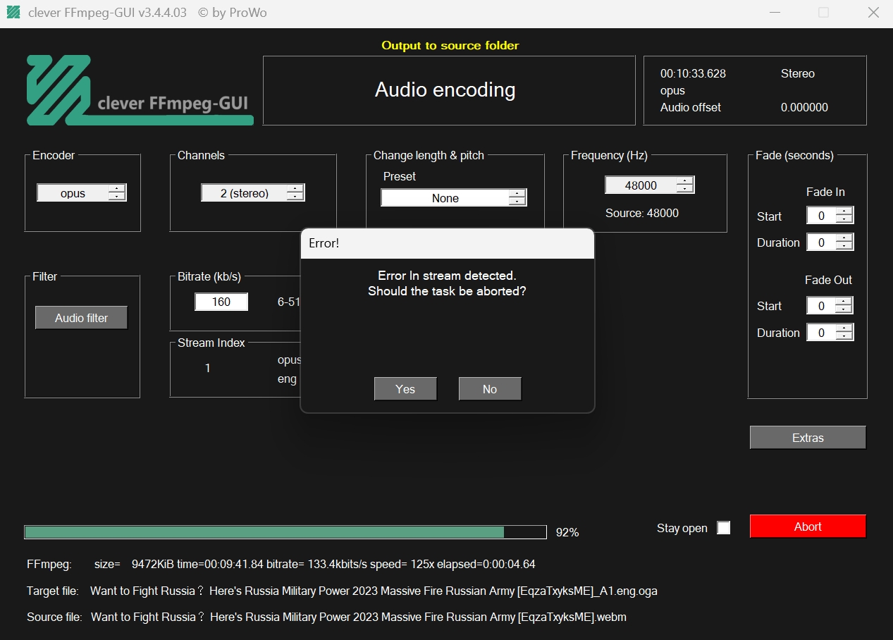

  25. Sometimes Clever gives an error when I convert an audio stream to mp3. But there is no error. The converted file works fine. Is there a way to turn off the scanning for error feature for those who don't want it? Thanks.
    [Attachment 88051 - Click to enlarge]
  26. Originally Posted by ProWo View Post
    Message box still shows up and ask me if I want to keep or delete the file.

  28. Originally Posted by davidt1 View Post
    Because you didn't convert an audio file, but rather an audio stream from a video file.
    This assumes that this stream will be remuxed. This is intentional and not a bug.
    To avoid the message, rename the file after creation.

  29. Originally Posted by davidt1 View Post
    The bug existed.
    Anyway, I'll remove the error check during encoding.
