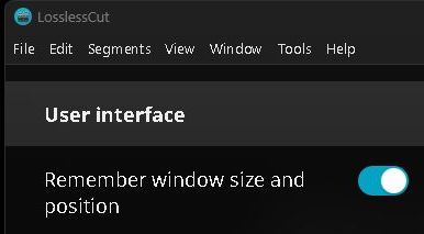

    BTW, LosslessCut has a 'remember size & position' setting, but it never worked for me. Now I know why ..
    [Attachment 87920 - Click to enlarge]

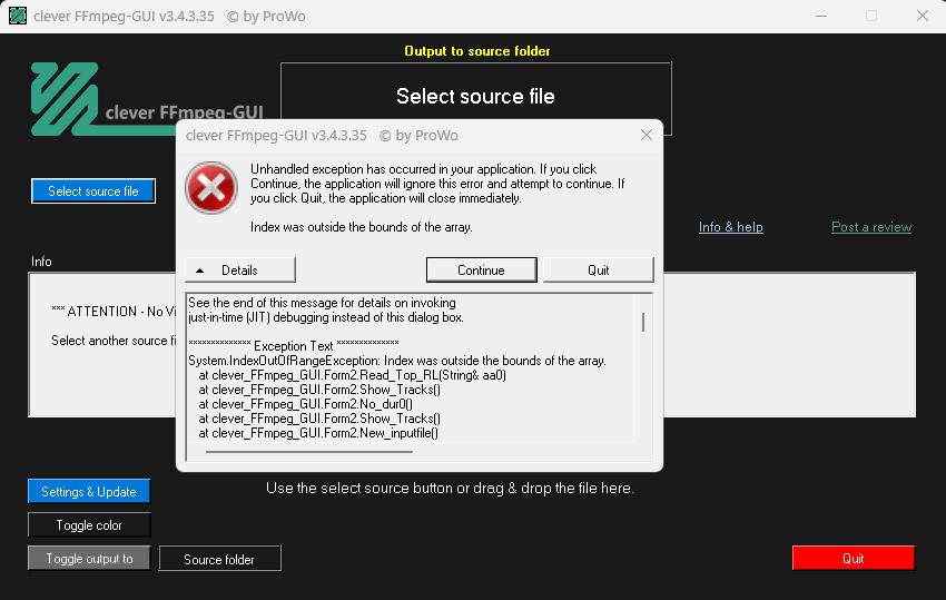

    Originally Posted by videoAI View Post
    @ProWo
    Another crash ..
    ************** Exception Text **************
    System.InvalidOperationException: This operation cannot be performed while an auto-filled column is being resized.

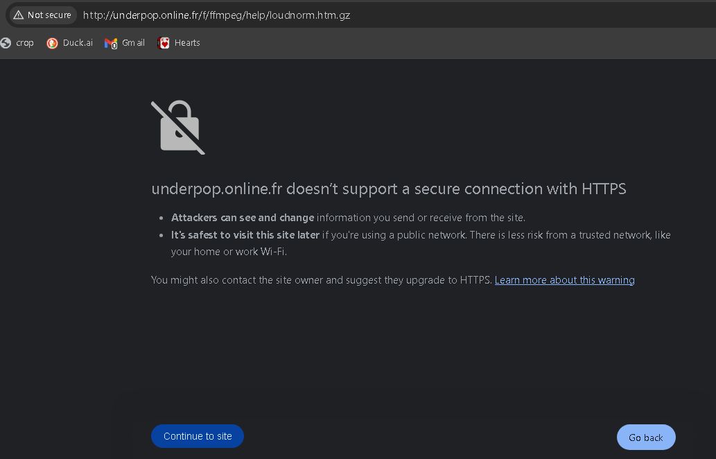

  8. @ProWo
    FYI,

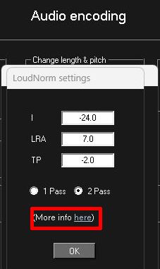

    Under audio encoding -> LoadNorm settings
    [Attachment 87923 - Click to enlarge]
    The 'more info' URL :http://underpop.online.fr/f/ffmpeg/help/loudnorm.htm.gz
    uses [http] instead of [https] & generates a security warning:
    [Attachment 87924 - Click to enlarge]
    and that goes for all the other filter screens that use the same site.

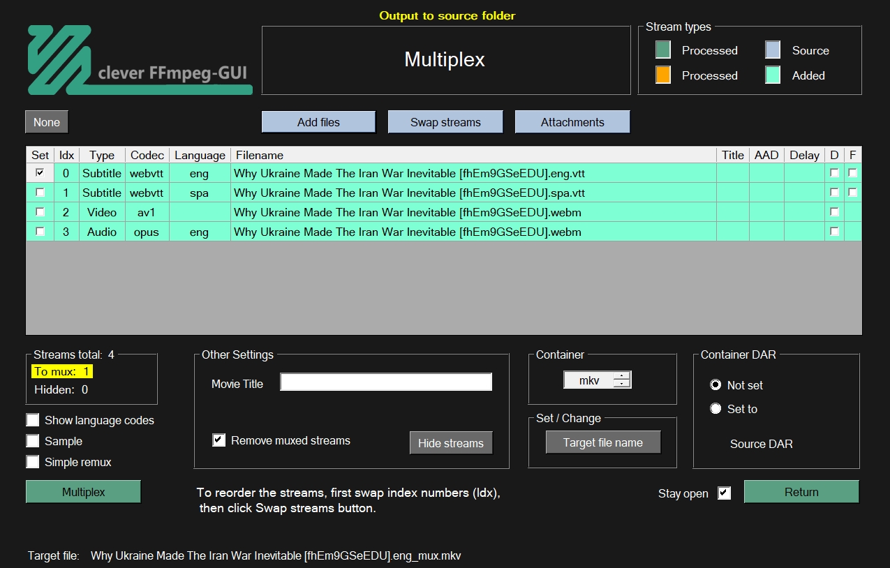

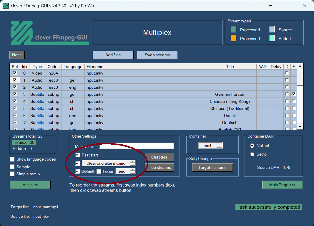

  10. @ ProWo
    On the multiplex page, the "Stream Types" select function in the upper right corner no longer reverses all selected and unselected streams of a type, but instead enables/disables all streams of a type. Thanks for that change.
    How about an additional option to clear the Multiplex grid after you click "Multiplex/Remux"?
    [Attachment 87932 - Click to enlarge]
    Let's assume you have 10 files with 27 streams each, and you only want to keep three streams per file when muxing.
    With the new additional option, the grid is automatically cleared after muxing without any further user interaction, so you can drop the next file into an empty grid. This option does not delete anything. Therefore, we still have "Remove muxed streams".
    I know you could also drop all 10 files into the grid at once, deselect each stream, only select the first three streams you want, mux them, and repeat the process. Then you'd have to scroll a lot as the grid can only display eight rows. But not everyone would do that.
    Most would use "Return & Multiplex" or "Show hidden & Hide streams" to clear the grid of the remaining streams when you drop files one by one.
  11. @Findu, davidt1
    I have found a better solution than adding a new button.
    Try it.
  12. Originally Posted by videoAI View Post
    I know that the website uses the old http protocol, but in this case it does not pose a security risk and the information cannot be found in such a compact form on any other site.

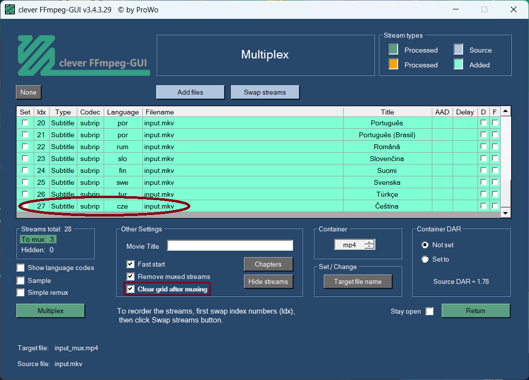

  13. Great!
    The new selection works well.
    However, the tooltip should also state that muxed processed streams will be deleted.
    It's good that the default is "Remove muxed streams" and the setting does not retain it's last use when leaving the Multipex page.
    If you select "Clear grid after muxing" "Stay open" disappears. But that's not important. Just a little confusing since the page remains open.
  14. Originally Posted by Findu View Post
    Great!
    You are right. I will change this the way, that the "Stay open" checkbox decides whether the window remains open or not.

  16. I don't see "clear grid after muxing" option. Is it the "hide streams" option?
    anyway, there should be an option to automatically remove unchecked/not needed streams.

  18. Originally Posted by davidt1 View Post
    The remove muxed streams option can be changed.

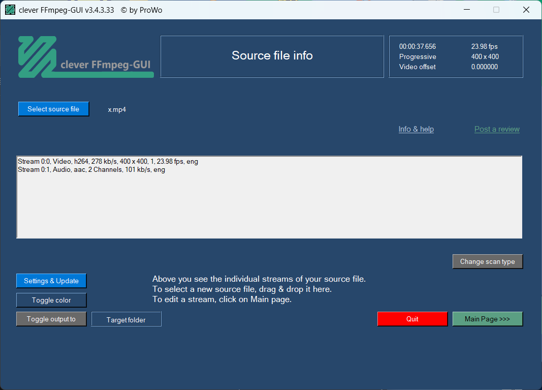

  21. @ ProWo
    Dropping a clip to Multiplex is okay, but as source it cause this error:
    EDIT: Same with some other files!
    [Attachment 87944 - Click to enlarge]
    General
    Complete name : C:\Users\Findu\Downloads\xxx mp4\x.mp4
    Format : MPEG-4
    Format profile : Base Media
    Codec ID : isom (isom/iso2/avc1/mp41)
    File size : 1.73 MiB
    Duration : 37 s 692 ms
    Overall bit rate : 384 kb/s
    Frame rate : 23.976 FPS
    Writing application : clever FFmpeg-GUI
    Video
    Format : AVC
    Format profile : Main@L4.2
    Format settings : CABAC / 4 Ref Frames
    Format settings, CABAC : Yes
    Format settings, Reference frames : 4 frames
    Format settings, GOP : M=1, N=30
    Codec ID : avc1
    Duration : 37 s 656 ms
    Bit rate : 278 kb/s
    Width : 400 pixels
    Height : 400 pixels
    Display aspect ratio : 1.000
    Frame rate mode : Variable
    Frame rate : 23.976 (23976/1000) FPS
    Minimum frame rate : 23.810 FPS
    Maximum frame rate : 24.390 FPS
    Standard : Component
    Color space : YUV
    Chroma subsampling : 4:2:0
    Bit depth : 8 bits
    Scan type : Progressive
    Bits/(Pixel*Frame) : 0.072
    Stream size : 1.25 MiB (72%)
    Writing library : Lavc61.19.101 h264_amf
    Language : English
    Color range : Limited
    Matrix coefficients : BT.709
    Codec configuration box : avcC
    Audio
    Format : AAC LC
    Format/Info : Advanced Audio Codec Low Complexity
    Codec ID : mp4a-40-2
    Source duration : 37 s 779 ms
    Bit rate mode : Constant
    Bit rate : 101 kb/s
    Channel(s) : 2 channels
    Channel layout : L R
    Sampling rate : 44.1 kHz
    Frame rate : 43.066 FPS (1024 SPF)
    Compression mode : Lossy
    Stream size : 463 KiB (26%)
    Source stream size : 464 KiB (26%)
    Language : English
    Default : Yes
    Alternate group : 1
    System.ArgumentOutOfRangeException: StartIndex darf nicht kleiner als Null sein.
    Parametername: startIndex
    bei System.String.Substring(Int32 startIndex, Int32 length)
    bei clever_FFmpeg_GUI.Form7.Check_first_file()
    bei clever_FFmpeg_GUI.Form7.Form7_Load(Object sender, EventArgs e)
    bei System.Windows.Forms.Form.OnLoad(EventArgs e)
    bei System.Windows.Forms.Form.OnCreateControl()
    bei System.Windows.Forms.Control.CreateControl(Boolean fIgnoreVisible)
    bei System.Windows.Forms.Control.CreateControl()
    bei System.Windows.Forms.Control.WmShowWindow(Message& m)
    bei System.Windows.Forms.Control.WndProc(Message& m)
    bei System.Windows.Forms.Form.WmShowWindow(Message& m)
    bei System.Windows.Forms.NativeWindow.Callback(IntPtr hWnd, Int32 msg, IntPtr wparam, IntPtr lparam)

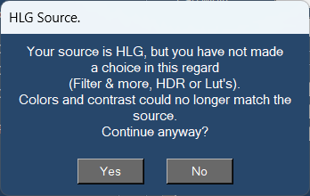

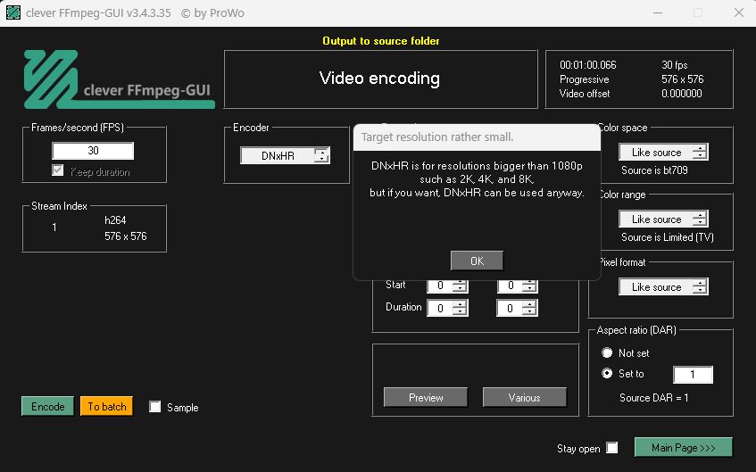

    The text in that Video encoding message should be "Various" and not longer "Filter & more".
    [Attachment 87943 - Click to enlarge]
  22. Originally Posted by Findu View Post
    Should be fixed now. The problem was the short filename.

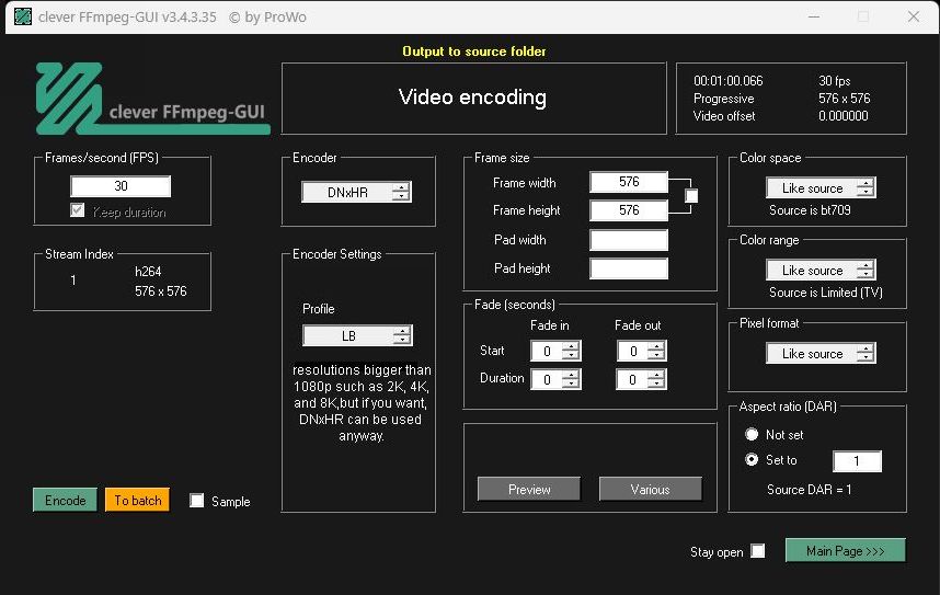

  27. I think it would make sense to get rid of the [DNxHR] popup:
    [Attachment 87957 - Click to enlarge]
    and replace it with something like this:
    [Attachment 87958 - Click to enlarge]
    There is no reason to interrupt the smooth scroll through the values of the Encoder dropdown.
    and please replace the other [DNxHD] popup as well.
  28. @ProWo
    v 3.4.3.35
    Bug#9 Hevc Crash
    A sample hevc test file downloaded from https://toolsfairy.com/video-test/sample-hevc-files# causes a crash when dropped into clever.
    Source grid shows:
     *** ATTENTION - No Video/Audio/Subtitle information detected ***
          Select another source file, please ...
    System.IndexOutOfRangeException: Index was outside the bounds of the array.
       at clever_FFmpeg_GUI.Form2.Read_Top_RL(String& aa0)
       at clever_FFmpeg_GUI.Form2.Show_Tracks()
       at clever_FFmpeg_GUI.Form2.No_dur0()
       at clever_FFmpeg_GUI.Form2.New_inputfile()
       at System.Windows.Forms.Control.OnClick(EventArgs e)
       at System.Windows.Forms.Button.OnMouseUp(MouseEventArgs mevent)
       at System.Windows.Forms.Control.WmMouseUp(Message& m, MouseButtons button, Int32 clicks)
       at System.Windows.Forms.Control.WndProc(Message& m)
       at System.Windows.Forms.ButtonBase.WndProc(Message& m)
       at System.Windows.Forms.Button.WndProc(Message& m)
       at System.Windows.Forms.NativeWindow.Callback(IntPtr hWnd, Int32 msg, IntPtr wparam, IntPtr lparam)
    ************** Loaded Assemblies **************
    [Attachment 87968 - Click to enlarge]
    sample_640x360.hevc:
  29. Originally Posted by videoAI View Post
    Bug#9 Hevc Crash
    Exception fixed.
    Your sample is a raw hevc stream, not muxed into mp4, but renamed only to mp4.
    Other editors like Avidemux can't load this file.
    I would recommend to use real video files instead.
  30. Originally Posted by videoAI View Post
    Done.
