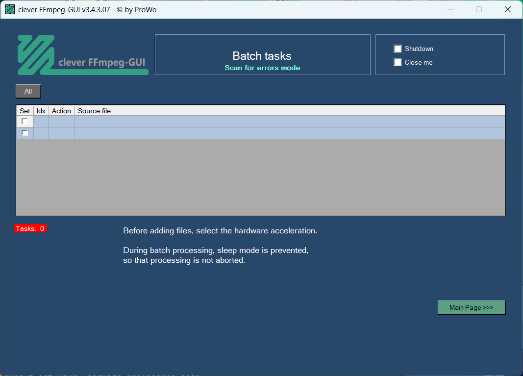

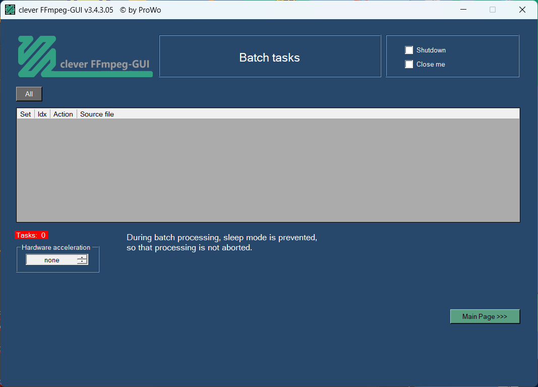

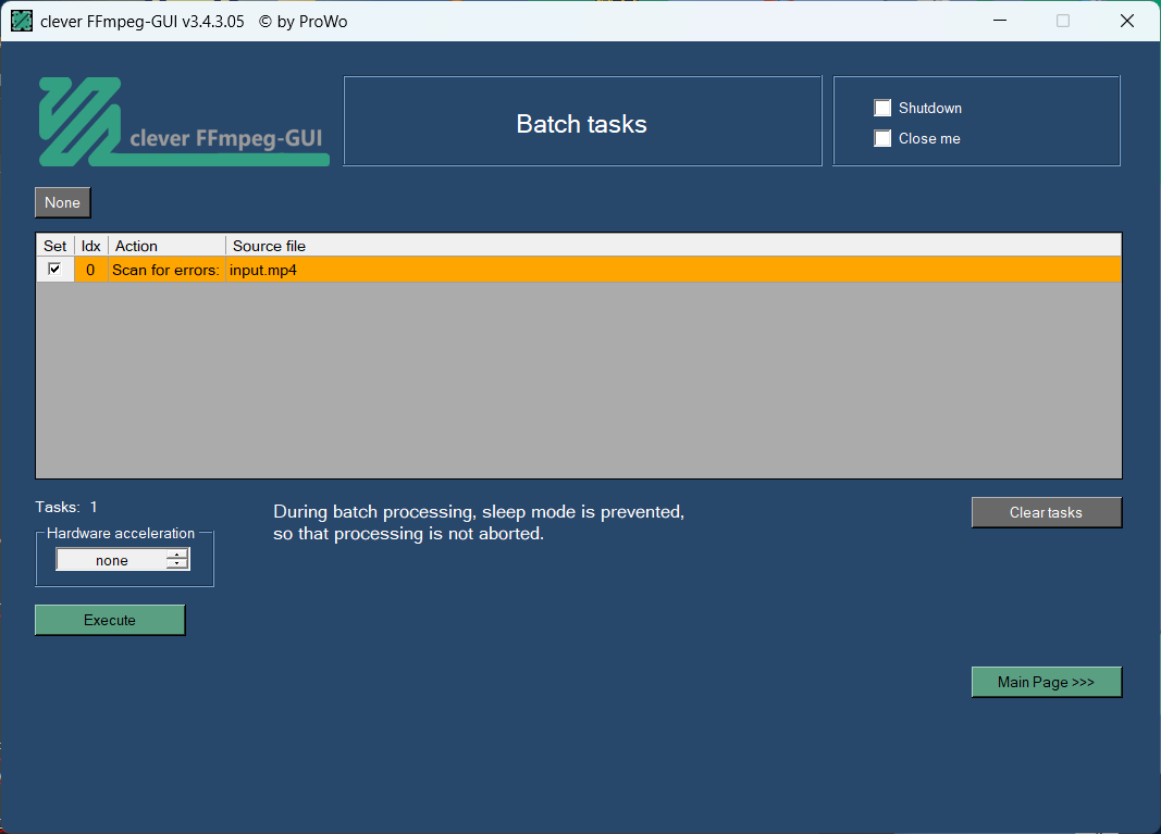

  8. When you load a source file and go to the Main Page, Various, Scan for errors and activate Batch scan, you get this empty "first opening" grid/page:
    [Attachment 87700 - Click to enlarge]
    When you add one or multible files
    [Attachment 87701 - Click to enlarge]
    with a wrong HW acceleration, you could clear all tasks and start with the same empty "first opening" grid/page.
    Actually you get transfered to the Main Page when you clear all tasks.
    It would be better to stay on the “Scan for errors” batch page only in that case.
    But that is not important.

  9. @ProWo
    I agree with Findu on this one ..
    Think about it; you come to the batch tasks page, you are going to start from top to bottom,
    you drag all your files in, then you check out the H/W acceleration drop down, which tells you
    you need to select me first before adding your files !!!! so you clear all tasks in the grid, and
    suddenly you are taken back to clever main page !!!!??? it doesn't make sense at all
    kindly fix, and
    - allow grid to stay open after clear tasks.
    - allow H/A drop selection at any time, and default to 'auto'.
    Also, a small change request ..
    currently you can drag a folder to the tasks grid, it is treated as a single task, clicking execute takes
    you to clever main page as well.
    Wouldn't make perfect sense to add the files from the folder to the grid instead.

  10. @ ProWo
    3.4.3.06 Feedback
    >> Could the "Batch tasks" page stay open when you use the "Clear tasks" button and there are no remaining tasks?.
    > I don't want this because the user with the blank page cannot determine which action should be performed for the file.
    For the “Scan for errors” batch, the page is initialized in a certain way that only allows this action for the added files.
    All other actions for the batch tasks are defined in other sections.
    With the current implementation of "Batch tasks," you're right about the "Clear tasks" behavior.
    Preselecting the HWA type for "Scan for errors" files also makes sense and should remain at None by default, as this is likely faster for most users than using the GPU. No changes are necessary here!
    NEW:
    If unprocessed "scan for errors" tasks are in the "normal" batch grid (not the "scan for errors" batch grid), inheritance/replication of batch 0 is always that wrong entry (switch task 0 has no influence):
    input.mp4??-hwaccel -i "C:\Users\Findu\input.mp4" -f null
  11. Originally Posted by Findu View Post
    Changed. Stays open now.
    The last setting is saved now.
    NEW:
    Changed. If "scan for errors" batches are present, this mode is ALWAYS activated and newly added files adopt this.
    To return to the command line of the first batch for further files,
    all “scan for error” batches must be deleted and the batch tasks window closed.
    The next time you open it (with normal batches), normal mode will be active again.

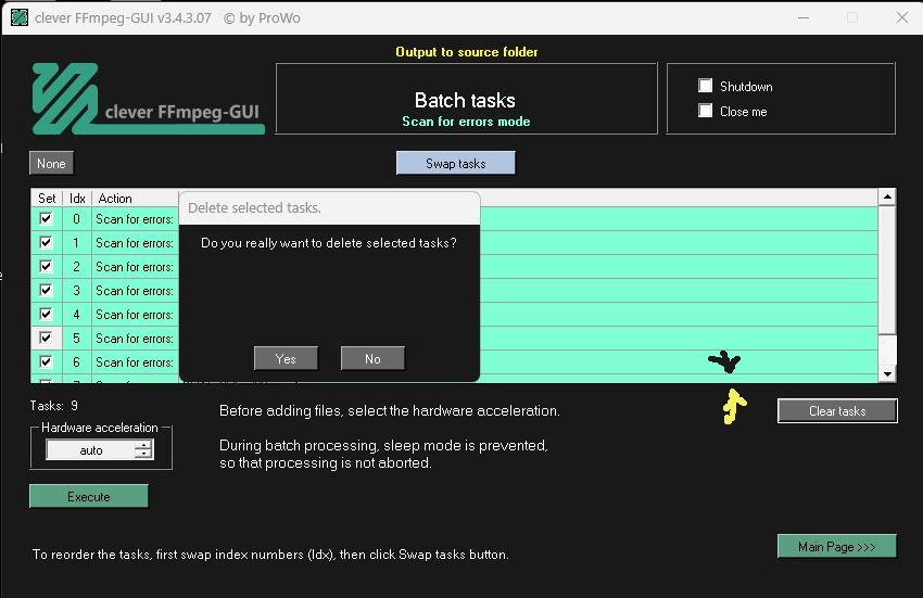

  16. @ProWo
    Cosmetic change:
    please align terminology for clarity; how about using:
    - 'Check/Clear' for selections
    - 'Remove' for grid task removal
    - 'Delete' for OS level file action.
    Using delete to mean remove is confusing.
    [Attachment 87707 - Click to enlarge]

  26. @ ProWo
    3.4.3.08 Feedback
    With amf I get Invalid argument. I will look into this...
    When all scan for error tasks have been processed, the page look like this so you can not add new tasks.
    [Attachment 87712 - Click to enlarge]
    Sorry. So this is what it looks like when you insert two tasks.
