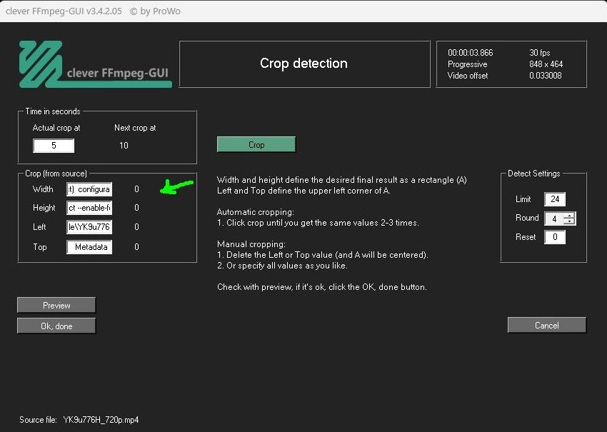

    bug in Crop as shown in attached image below ..
    bug is reproduceable on clever nightly, and actual release, for this specific video file (click crop button),
    bug does not occur on all mp4 files, just this one so far.
    The crop boxes seem to populate meta data from my video file, look at 'Left'.
    I tried to change the actual crop start value, got an instant crash ... just by pressing the back space.
    This seems to be a separate bug, in addition to the one above.

  3. @VideoAI
    You start the crop at 5 seconds, but the video duration is shorter....
    retry to start at 1 second.
  4. @ProWo
    I didn't actually start the crop at 5 seconds .. that was the default pre-filled value.
    Retrying start at 1 sec, resolved the issue.
    Thank You.

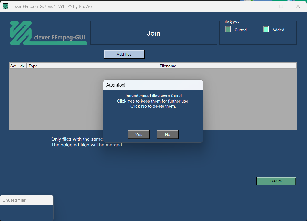

  7. @ ProWo
    3.4.2.051 Feedback
    Some cosmetic / minor changes to consider for your next release:
    - Join Screen; Please change "Cutted" to "Cut" [past tense of cut is cut] cutted-or-cut
    - Cut Screen; Preview; Please assign mouse middle button to [Pause/Play]
    - Cut Screen; Preview; Please assign mouse Scroll Wheel to [Preview Volume Control]
    I promise not to get mad if you decide not to implement any of the above, but
    I am sure will be glad if you decide to implement them.
    Thank you and keep up the good work.

  9. Originally Posted by videoAI View Post
    - Join Screen; Please change "Cutter" to "Cut"
    It's "Cutted" atm (not "Cutter"); will change it to "Cut"

    When you have processed streams (or Batch tasks) and start the app, you stay at the Select source file page and do not get forwarded to Multiplex/Batch any longer. That's okay. Therefore, the detection of processed streams or batch tasks should be indicated under the page Herding or somewhere else. Perhaps also on the main page. Maybe in color?
    I'm not suree whether the list of the files in question should also appear, since it is a popup
    Anyway. When you click Join then Return, you get this message:
    [Attachment 87615 - Click to enlarge]
    New multiplex grid behaviour in conbination with Chapters Video:
    1a. If idx 0 is an processed audio stream and the grid also contain a video stream, Chapter Video now plays pure audio. Cool!
    1b. If idx 0 is an processed audio stream and you swap the source video stream to idx 0, audio ist played instead of video.
    1c. Hiding the audio stream does not change that behaviour of 1b.
    I might found the problem. Swap is not enough. After the click on Swap use None then All to reselect or refresh the new sorted streams and it's working.
  12. Originally Posted by Findu View Post
    I want to do this as unobtrusively as possible and with as little interaction as possible; if streams/batches are available, you will find them in the corresponding windows (mux, join, batch tasks).
    Already fixed.
    Should be already fixed. Reupdate.

    When you have processed sub streams and start the app, click Join, click Return, you still get this message:
    [Attachment 87622 - Click to enlarge]
    There are no unused cut files!
    Will you change the text "Unused cutted..." to "Unused cut..." as well?
    Already fixed.
