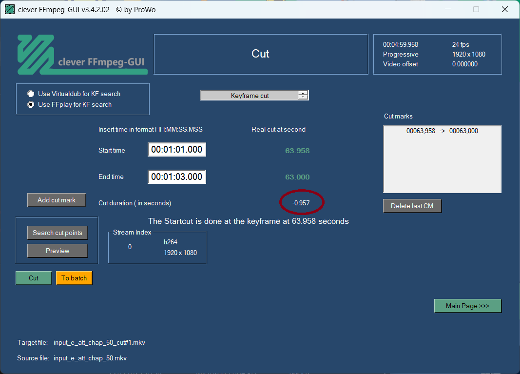

  4. @ ProWo
    Although these are unusual values, it is possible to create negative cut sizes. The cut end is ignored and the end of the video is used.
    [Attachment 87401 - Click to enlarge]
    Stream cut: ?C:\Users\Findu\input.mkv?299958?-hide_banner -loglevel error -stats -y -ss:0:0 64 -i "C:\Users\Findu\input.mkv" -frames:v -23 -map 0 -map_metadata 0 -movflags use_metadata_tags -c copy -dn -metadata:g encoding_tool="clever FFmpeg-GUI" ?C:\Users\Findu\input#1.mkv?61 - 63
  5. Originally Posted by Findu View Post
    This is an interesting bug.
    It happens when the end time is <= the time of the start keyframe. I will fix this with a check.
  6. Okay!
    I noticed that while making a typo.
    Another thing is that if I enter a start time of 1:01, the real cut is automatically found at the keyframe at 63:958. If I enter an end time between 1:01 and 1:05, the real cut at keyframe at 63:958 is never found, only the exact value I enter. It's as if there's no automatic search for the keyframe for the end time/cut.

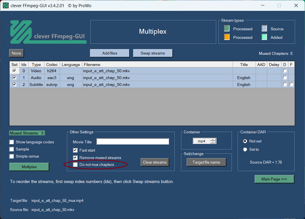

  7. @ ProWo
    If your source file has created or imported chapters from a file and you drop another file into the multiplex grid and then for example multiplex the source video stream, you'll be asked after muxing whether you want to keep the chapters. If you say yes, the chapters remain activated for muxing, even if they do not fit the remaining video stream.
    As chapters are treated like streams, this is basically fine. But chapters are associated with one dedicated video stream as well.
    So it would be good if you could turn on/off all three types of chapters (E C F) directly on the multiplex page.
    [Attachment 87420 - Click to enlarge]

  9. Originally Posted by Findu View Post
    @ ProWo
    Will try to find a solution for this problem.

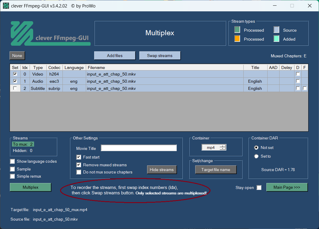

  14. @ ProWo
    I thought about it and realized that a keyframe isn't needed for the end cut. You only need this frame for the start cut in terms of video compression.
    Info:
    > Newest beta (v3.4.2.02), online now.
    This version is only available via https://files.videohelp.com/u/292773/clever_ffmpeg_gui_newest_beta.zip
    So far, I am not able to update to the latest nightly with the update function like in 3.4.2 or beta .01 and.02
    And please don't forget to take a look that hidden streams stay hidden when you mux a sample.
    Maybe they should remain hidden even after multiplexing?
    There was a reason to hide them, and if you need the hidden streams, you can make them visible with one click.
    Perhaps the information text should be expanded?
    [Attachment 87434 - Click to enlarge]
    Thank you very much for the many changes, but please don't stress yourself!

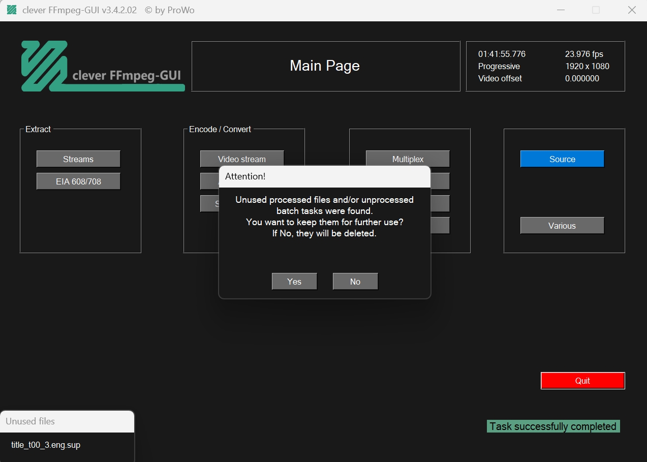

  15. After the extraction of a bluray sub, the latest version now asks the user to choose to keep or discard the files. This pop-up message is unnecessary. If I extract a bluray sub, it's obvious that I want to keep it. Just automatically keep the extracted sub and delete the extra file, please. Previous versions did not have this unnecessary step. Thanks for your hard work.
    [Attachment 87449 - Click to enlarge]
  16. I second this motion.
    This added step of cleanup always delete the wrong files, and does not list what it is going to delete or give you a clear choice.
    if you choose, keep, the next time you run it asks if you want to use whatever it didn't delete.
    I have to go and manually clean up at the disk level. so what is the use.
    I hate this "feature".
    Findu !!
    was this your idea?
    fixed

    3.4.2.03 Feedback
    I can confirm that the update process to version 3.4.2.03 is working now for 3.4.2, beta .01 & .02
    Good idea to use a Chapters button utilize the Chapter page for all tasks including a Return.
    And hidden streams stay hidden when you mux a sample.
    And you can't mux without a selected stream.
    Very good!
    Two things:
    - After multiplexing, all streams are hidden now. Wouldn't it be better to kepp remaining unselected visable and hidden hidden?
    - Nothing happens when you select Simple remux and click on Remux or To batch.
  23. Originally Posted by Findu View Post
    Two things:
    Hidden is actually invisible; I will handle this so that after muxing all remaining streams are visible again and not checked, except for the top file, which will be checked.
    Bug, already fixed.
    Use the update function (nightly).

  26. Wouldn't it make sense to keep the Chapters button on the main page as well because of the well known easy access to it?
    The notification of available updates works perfectly as before!
  27. Originally Posted by Findu View Post
    No I'll leave it on the mux page now.
    With >= 3.4.2.02 there is no more update notification.

  29. Originally Posted by videoAI View Post
    Findu !!
    was this your idea?
    A workaround for me is using the mux function instead of extract. No more pop-up message and an extra text file.
  30. The latest version does not clear muxed streams like the previous one, which I, once again, did not make a copy before updating.
    If anyone has copy of the one that:
    1. displays the language codes (not totally necessary, as I can type in the sub language codes).
    2. clear all the streams after muxing and keeps the muxing page open with an empty screen so I can continue to drag and drop.
    3. the mux page stays open by default. Toggling on/off is good too.
    This version fits my need the best, but as I have stated, I lost it.
    Please let me have it. I really appreciate it.
