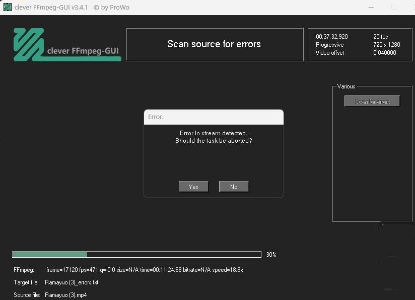

  5. @ProWo
    FYI,
    Error is given when I try the 'scan for errors' under various.
    The mp4 file does not seek properly.
    The error dialog form does not close at all, no cancel button or X. Pressing Y or N does not abort.
    Task has to be killed in task manager in windows.
    No errors text file is generated. No diagnostic file is generated.
    Bug discussed in my previous message: I tried to fix an mp4 file with a seek problem, ended up with a screen saying, there is an error in the file, do you wish to continue.
    you can't abort or cancel out of that action, pressing continue will repeat the error message 10,000 times or till you kill the task in windows.
  6. Originally Posted by videoAI View Post
    This is a bug.
    This error message should not appear during an error scan.
    I will investigate this.
    In the meantime, you have several options to solve the problem with this mp4:
    - fix framerate (under main page, various)
    - simple remux
    - normal mux, with fast seek activated.
    In all these cases the timestamps will be regenerated and the problem should be solved.

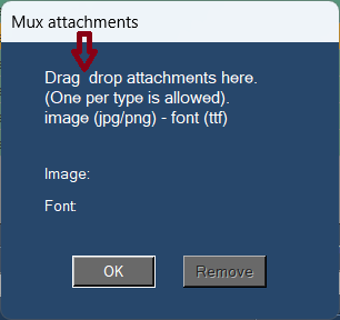

  7. @ ProWo
    3.4.1 Feedback
    The checks for missing ffmpeg files and for the missing target folder are working well. It's good that you cant't use the app if one of them is missing!
    Unused files list at app start and end, is also working.
    Attachment recognition with mjpeg as video, the adding and the extraction is working also.
    The & is missing here:
    [Attachment 86834 - Click to enlarge]
  8. Originally Posted by Findu View Post
    Thx for the hint. Will be fixed.

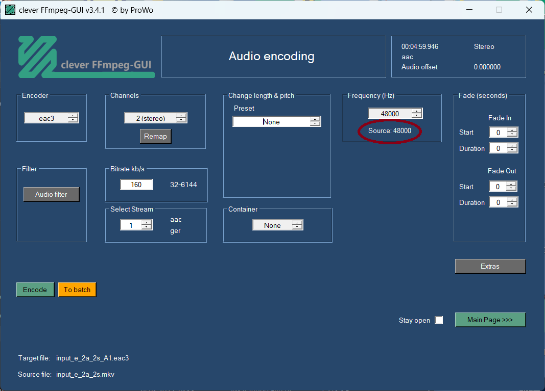

  15. @ ProWo
    As I see, the frequency of the source on the audio encoding page always corresponds to the value of the first audio stream and not to the frequency of other included audio streams.
  16. Originally Posted by Findu View Post
    No. The setting is saved and read in again at the next start, as with the codec.
    I have deliberately not adopted the source frequency, as I have noticed that many films available on the internet do not have the frequency of 48000Hz recommended for movie audio, but 41100Hz, which is the standard for music CDs.

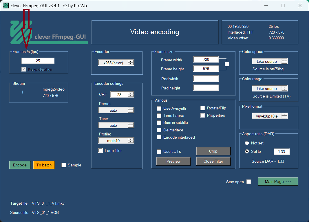

  19. @ProWo
    would it be possible to standardize the terminology used for drop down selections throughout the App.
    As an example, in the video encoding screen, H264, Profile, Auto means [Encoder Default]
    while, on the same screen, Pixel Format, Auto means [as Source]
    There are 3 potential dropdown value selections here:
    1- Value read from source or made to match the source file ... [Source]
    2- Value forced to match the tool's default setting ... [Default]
    3- Value is chosen or entered by the user ... [ex main, high, limited, etc]
    I am not sure where [Auto] fits in here? do you mean [default] or do you have a fourth selection type like "Developer Preference"?
    Please clarify ..
    and as always .. Thank you for your time & effort.
  20. > No. The setting is saved and read in again at the next start, as with the codec.
    Sorry! What I mean is not the settig for the frequency, it's the source value underneath:
    [Attachment 86888 - Click to enlarge]
    The red area always shows the frequency of the first audio stream, even if you change the stream and it has a different frequency.
    I think the frequency of the stream in question should be displayed here!

  23. Originally Posted by Findu View Post
    Sorry! What I mean is not the setting for the frequency, it's the source value underneath:
    You're right, bug, will be fixed.
  24. Originally Posted by videoAI View Post
    Please clarify ..
    Auto means, no setting is done for this parameter.
    I could rename it to “Not set” for example.

  26. I tried fix framerate, simple re-mux, & normal mux [w/FS]. none of them worked.
    the mp4 plays the first part & the last part fine, but in the middle, it gets stuck. it maybe corrupted.
    the file is too large to upload online to try and fix the corrupted part.
    This is a bug.
    - simple remux

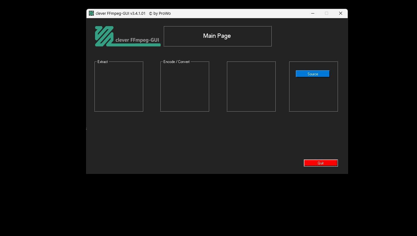

  27. @ ProWo
    3.4.1.01 Feedback
    if you click multiplex -> select no files -> click main page >>
    you end up with blank frames, as shown below;
  28. Originally Posted by videoAI View Post
    Then try another way.
    Load this mp4, click main page, click extract streams.
    Let all streams checked and click extract.
    At the question (for the video stream) to extract to raw or container choose container.
    Then go to multiplex and remux the extracted streams (in green, deselect all others).
  29. Originally Posted by videoAI View Post
    Of course, no file is ever loaded.
    Click on source and load a file.
  30. @ProWo
    I tried the "extract to container" method you proposed .. it also didn't work.
    I gave up and deleted the file for good, but not before testing it using your latest version [3.4.1.01].
    I can confirm that the app is now able to scan the damaged mp4 file successfully [without hanging or freezing] and can produce an
    error file .. attached .. if you wish to take a look at the errors.
    I also tried repairing a smaller damaged file with a similar problem at onlineconverter.com but
    the resulting file was ~3% of the original
