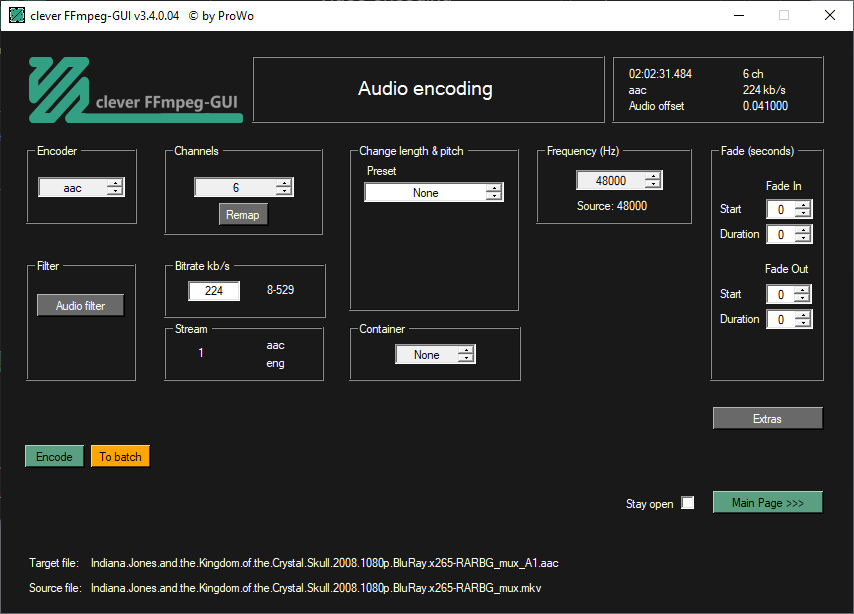

  7. Question:
    Can ffplay preview/play the changes you make on the Audio encoding page?
    To allows you to control length and pitch, fade in and out, and filters.
    Even for pure audio sources.
  8. Originally Posted by Findu View Post
    Question:
    Interesting question.
    I would have to install a player that only plays audio in this case.
    I will look into this.
  9. The pure audio file could be multiplexed with a tiny, completely black dummy video before previewing with ffplay.
  10. Originally Posted by Findu View Post
    No way to use ffplay for an audio preview/pre_list.
    FFplay isn't able to handle filter_complex.
    So we have to forget this idea.

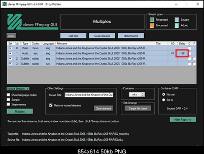

  11. @ProWo
    //// seems to happen when clicking Join Media Files button ////
    See the end of this message for details on invoking
    just-in-time (JIT) debugging instead of this dialog box.

  13. Originally Posted by videoAI View Post
    Error message...
    This operation cannot be performed while an auto-filled column is being resized. ???
    There is no code in my app to resize a column in the join grid.
    Did you do this manually?

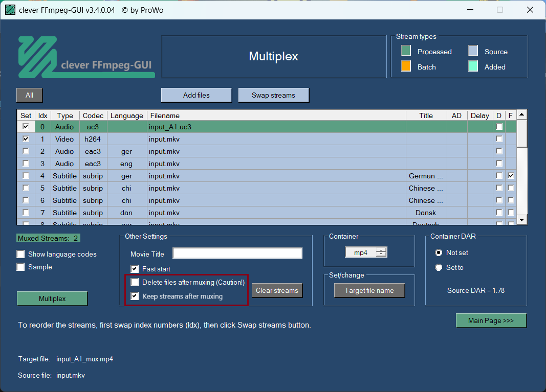

  14. When you multiplex, all selectet streams get cleared from the grid. Which is most of the time good.
    But how about an option to disable this?
    "Keep streams after muxing"
    If set, it will also uncheck "Delete file after muxing" and vice versa.
    So there is no need to close and reopen the Multiplex page to get back previously muxed streams.
    [Attachment 86736 - Click to enlarge]

  18. Originally Posted by Findu View Post
    Can be done. Will work on this.

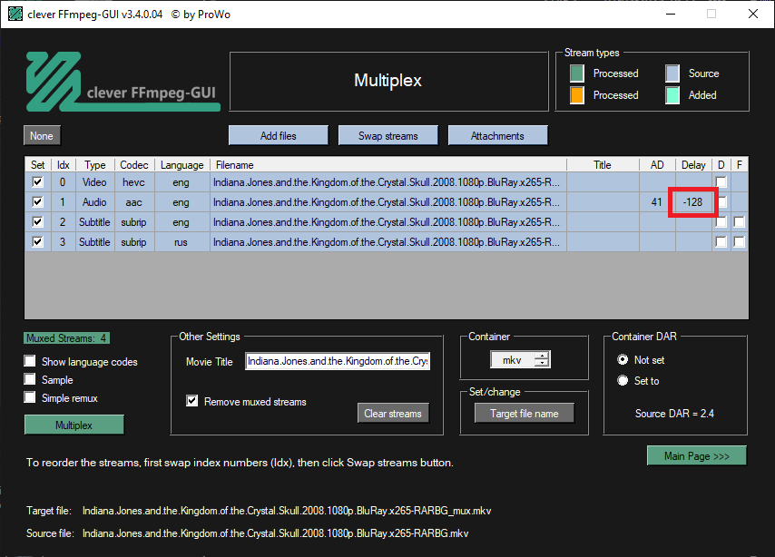

    Oh, I really meant "Delay". Of course I can. Here are the screenshot. This is what I set:
    Ant here is what I get after multiplexing:
    [Attachment 86801 - Click to enlarge]
    It started with version 3.3.9. Version 3.3.8 and below worked perfectly. One more thing to mention. It seems to work perfectly with positive delays, like +200ms or +50ms, but it's broken when it comes to the negative delays like -170ms or -85ms.

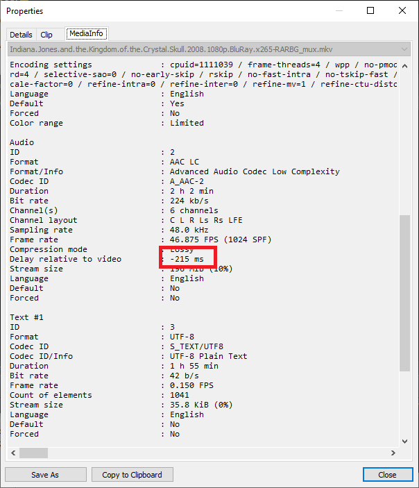

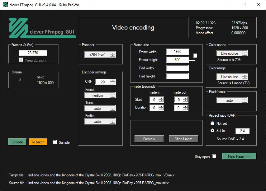

  25. You must give me other two values from this movie:
    Video offset (top right in video encoding grid) and audio offset (top right in audio encoding, with the audiostream selected, you would change the delay).
  26. Thx, will investigate on this and come back to you.
