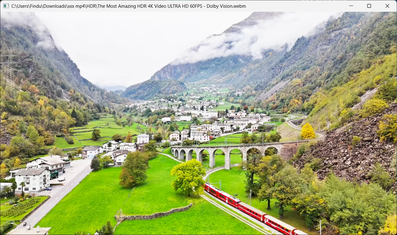

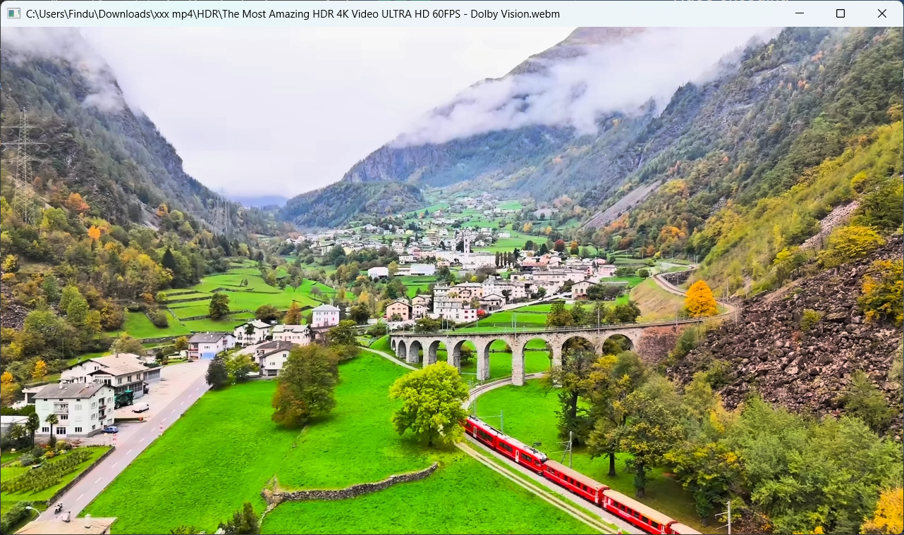

    The HDR to SDR preview looks like HDR because it has a huge color range.
    > I cannot confirm this; corrected HDR sources (either HDR to SDR or with LUTs) are displayed correctly in color.
    Example with LUT
    [Attachment 86384 - Click to enlarge]
    HDR to SDR
    [Attachment 86385 - Click to enlarge]
    Pale
    [Attachment 86386 - Click to enlarge]
    I thought a 10 to 8 bit reduction (HDR to SDR) would look like the pale example.

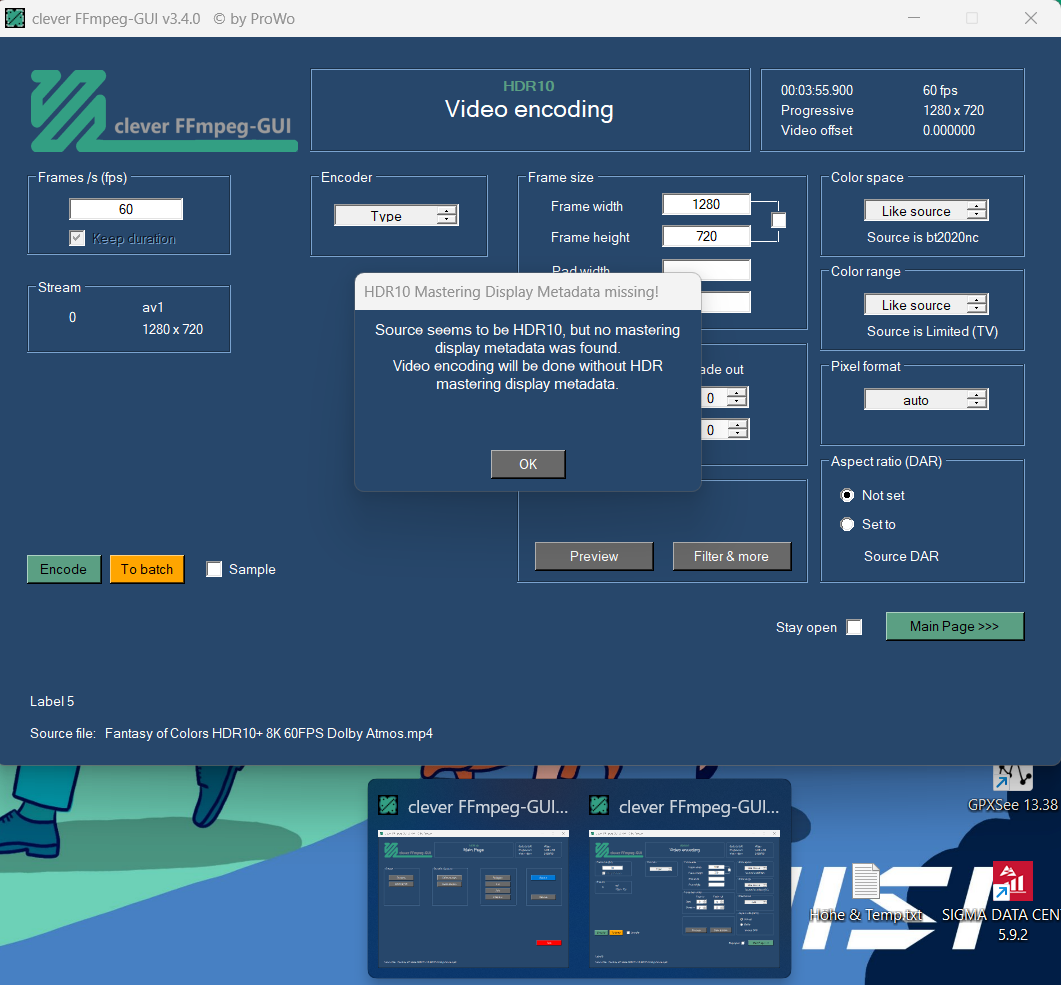

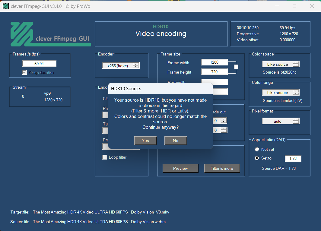

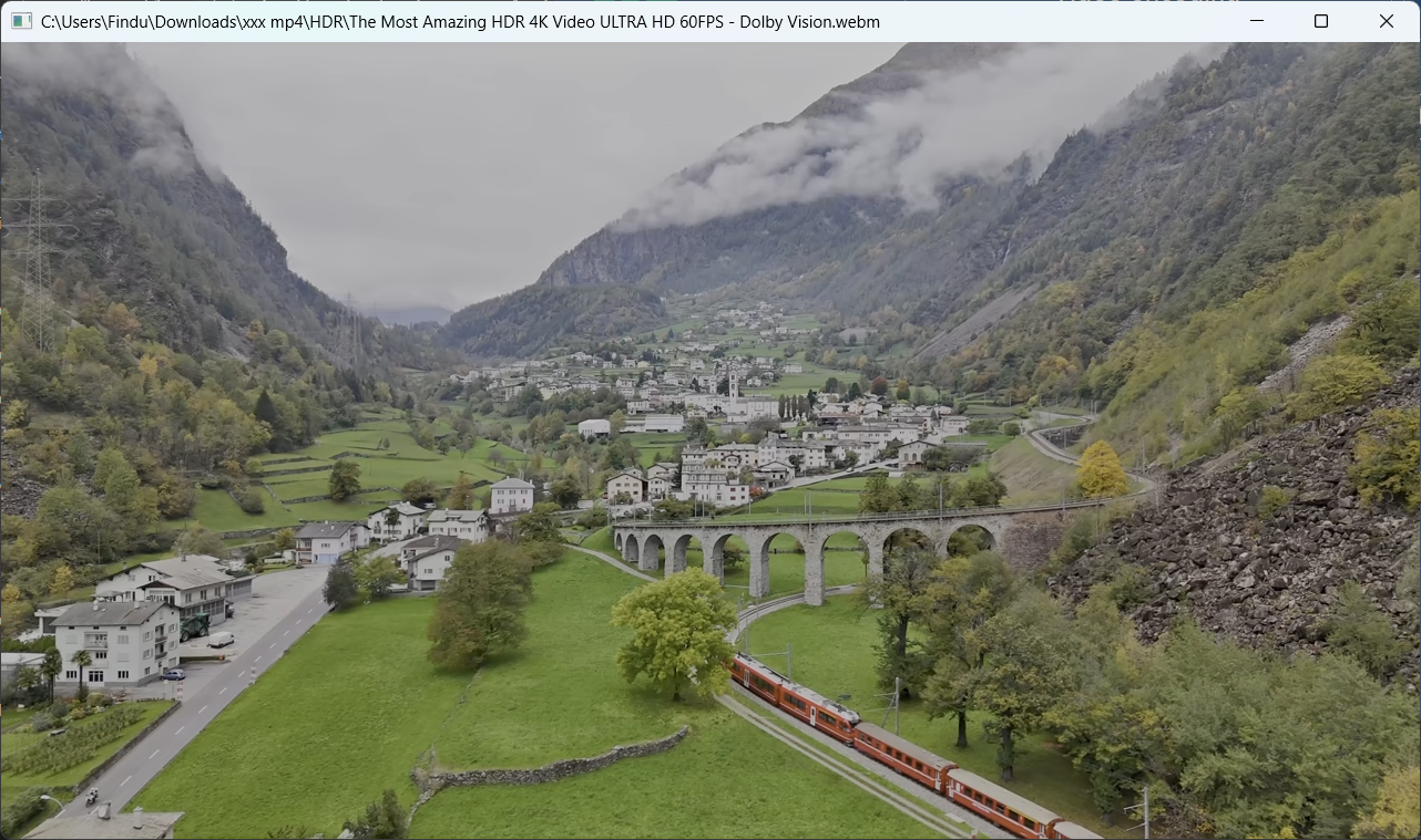

  3. @ ProWo
    3.4.0 Feedback 2, more HDR testing
    When you click No at this dialog, Stay open does not reappear.
    [Attachment 86406 - Click to enlarge]
    When you see this dialog, you will see two instances of the app and the missing encoder settings.
    [Attachment 86405 - Click to enlarge]

    Stay open and Main Page botton does not reappear when encoding or encoding a sample in the same case from above. Is fixed.
    Stay open does not reappear when you click No at HDR10 dialog. Is fixed.

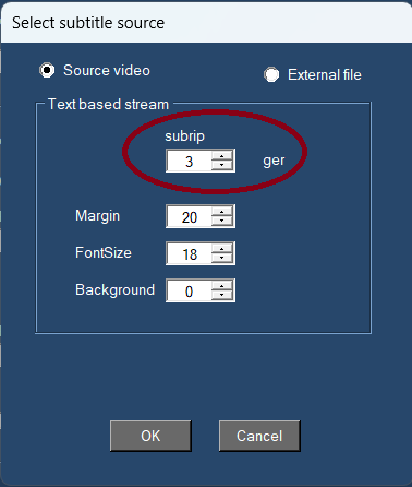

  8. @ ProWo
    How about the idea to add an info textbox for the different subtitel typs you can convert to?
    Is there a reason why chapters and attachments get ignored for added files in multiplex?
    How about the idea to add a "Remove streams" button between "Swap streams" and "Attachements" on the multiplex page to clear the table from the selected streams? No fles will be deleted.
    Maybe a combined button is possible. "Swap/Remove streams" will remove when there is no Idx change.

  9. Originally Posted by Findu View Post
    Where? In the convert subtitle section, all options are already entered in the convert to box.
    Yes, because chapters and attachments need a special way of muxing, not like the other streams with streamcopy.
    In my opinion, this is not really necessary.

  10. >> How about the idea to add an info textbox for the different subtitel typs you can convert to?
    Yes. ass, ssa, subrip etc. may not be familiar to all users. A brief description may be helpful when hovering over them.

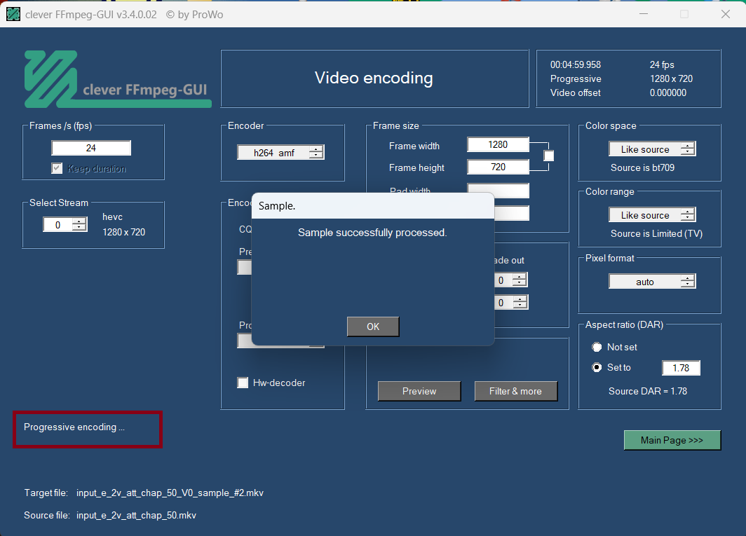

  15. @ ProWo
    3.4.0.02 Feedback
    Bug with target file name extension _sample has been fixed.
    Good idea to check propper values for "Start at" and "Duration" also for short videos. Standard is 180/60.
    Start and duration values ​​are retained until the page is closed. Good.
    The processed samples match the values ​​used. Good.
    A small thing! "Progressive encoding" disappears "after" the click on OK, and not before!
    [Attachment 86491 - Click to enlarge]

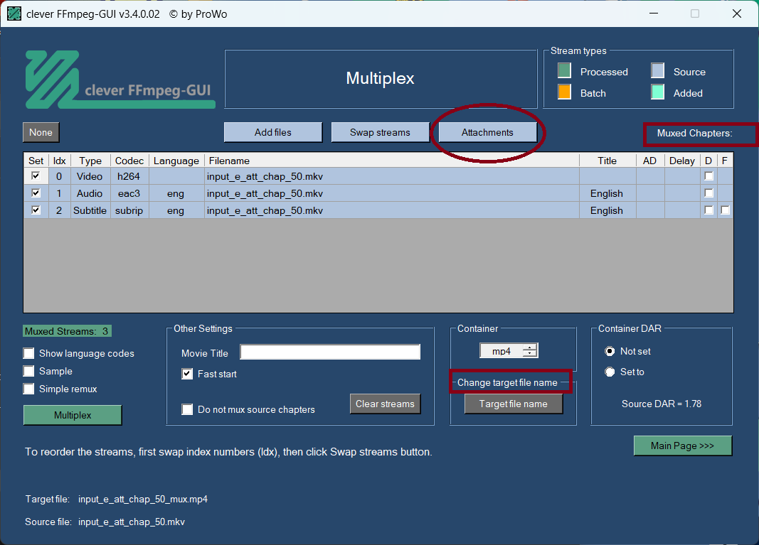

    The Multiplex page only show "Muxed Chapters:"
    The E or C is missing.
  16. Originally Posted by Findu View Post
    Bug. Will be fixed.
    Bug. Will be fixed.

    Missing E or C after "Muxed Chapters:", still need to be fixed.
  20. Originally Posted by Findu View Post
    Have found it; not a bug, but the label is to short.

  22. @ ProWo
    3.4.0.02 Feedback
    The new Multiplex -> Clear streams button is working as expected. Thank you!
    The new Sample -> "Sart at" also works in Multiplex.
    But there is a bug when you open the Multiplex page. The Attachments button is always visible when you open the page. It does'nt matter of the source or the container. It will disappear if you change the container to none mkv.
    Maybe "Change target file name" can be shorten to "Change". Because the button text is clear enough.
    [Attachment 86551 - Click to enlarge]
  23. Originally Posted by Findu View Post
    Should all be fixed. Check your PM.
  24. Multiplex page:
    The thing is that you can see the Attachments button disappear when the source has attachments and the container is not mkv.
    Set/change for "Target file name" is okay.
    Did you know that you can also change the directory for that file?
    But all get reset after the Multiplex or when you select Simple remux or Sample after you change name and/or directory.
    But you can select Sample and change name and directory afterwards.
    I'm not sure if it makes sense to keep the changes till you close the Multiplex page!
    When I would like to add an audio stream lets say from the english version of a movie to the italian movie, I have to find the audio delay manually.
    Can you force ffplay to use a delay for a preview without muxing?
  25. Originally Posted by Findu View Post
    This should be the case because attachments can only be muxed in mkv.
    This can be done much better with other programs, such as VLC player.
  26. >> The thing is that you can see the Attachments button disappear when the source has attachments and the container is not mkv.
    Yes, I know.
    I mean, if the source contains attachments and the container isn't in MKV format, and you open the multiplex page, you'll see the "Attachments" button for half a second before it disappears.
    I never see it with other versions.
    You might see it if your laptop is in power saving mode and reducing CPU performance.

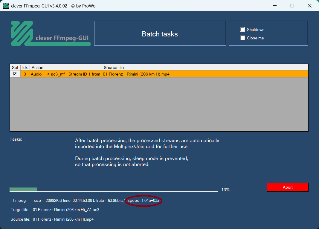

    Setting -> My version -> Update, now opens the update window direclty when an update ist available. Thank you.
    I'm experimenting with ac3_mf encoding.
    It looks like the speed variable is too short for large values.
    [Attachment 86668 - Click to enlarge]
    3.4.0.03 Feedback
    Video Encoding -> Filter & more -> Burn in subitle.
    The subrip value does not increase when you click up, it decrease.
    [Attachment 86669 - Click to enlarge]
